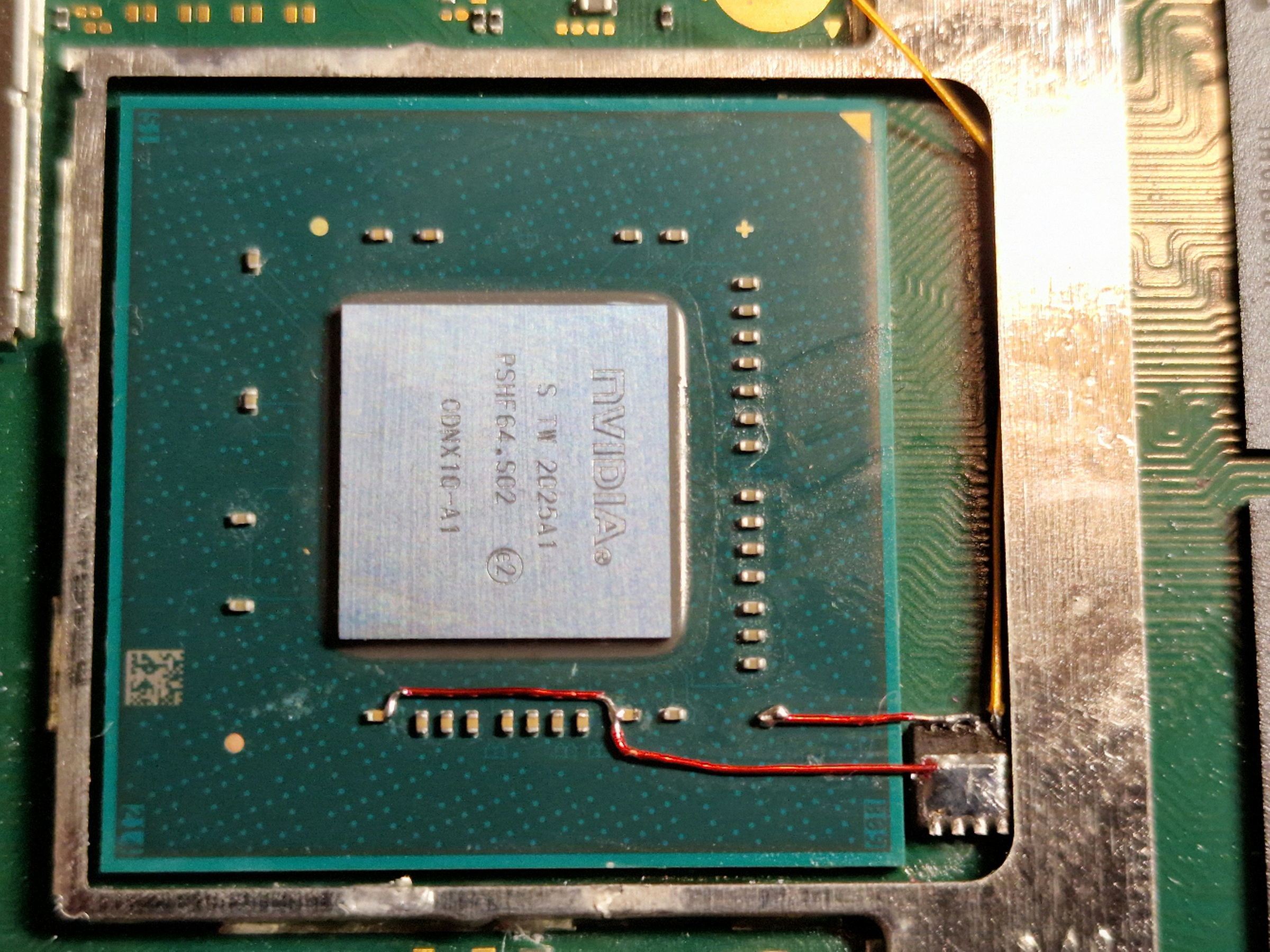

To add up to depps input above, attached you have some pics :) 2 are for the mosfet on apu install and one is for mosfet on the front of pcb (abal's method). And one more with rp2040 with 2x100ohm and 1x47ohm resistors in place (as per deeps suggestion)
Good luck on your installation.
Can you give me a link of what wire you use for the mosfet install. I use 30 awg cynar wire but your wire seems easier to manipulate.

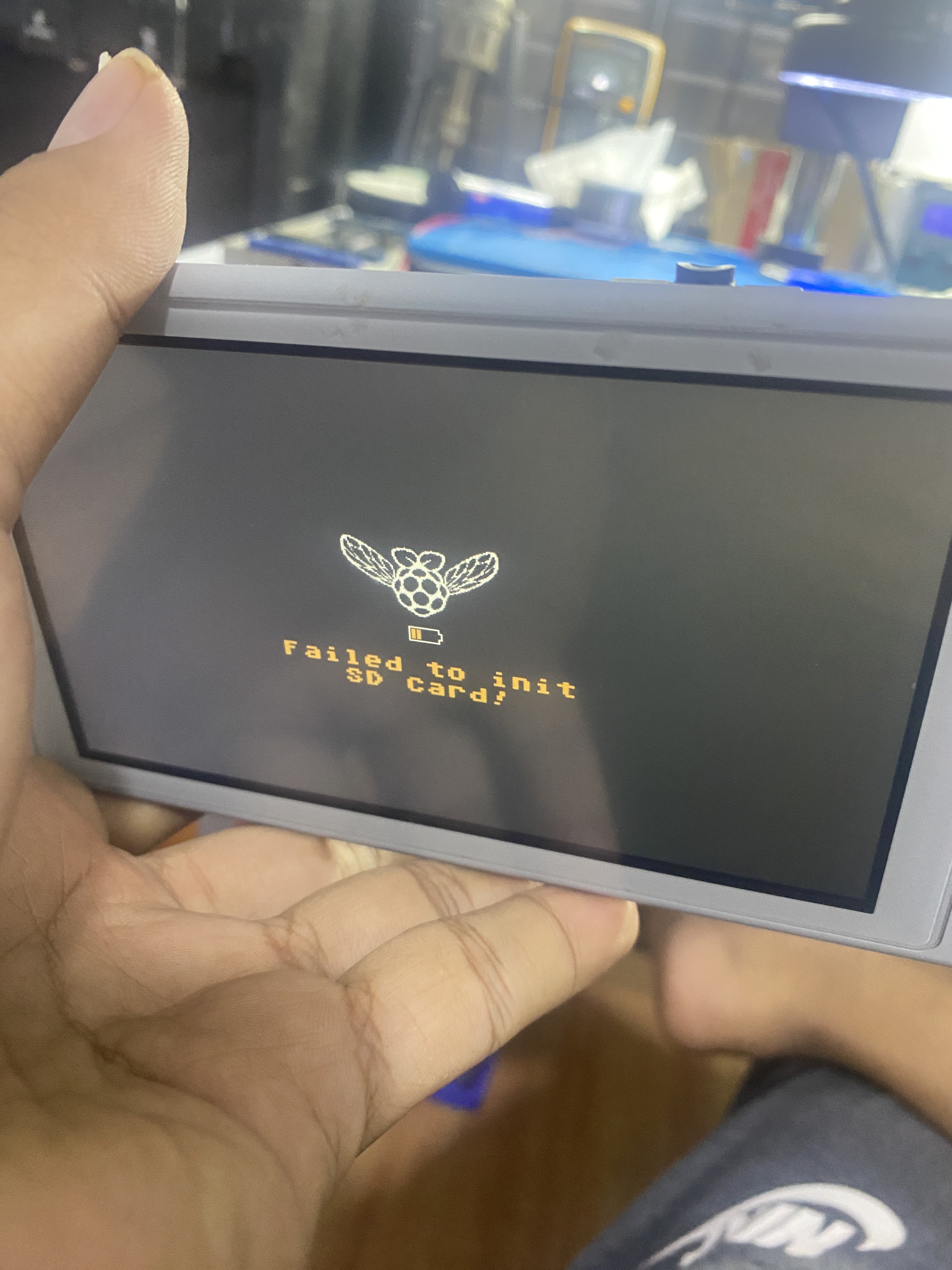

Anyone using lexar SD card when installing picofly ?
I got failed to init sdcard msg and cant boot to hekate
When i try sandisk sdcard it can boot to hekate
But when i try this lexar on my hwfly it can boot normal
Is thia lexar not compatible with picofly ?
