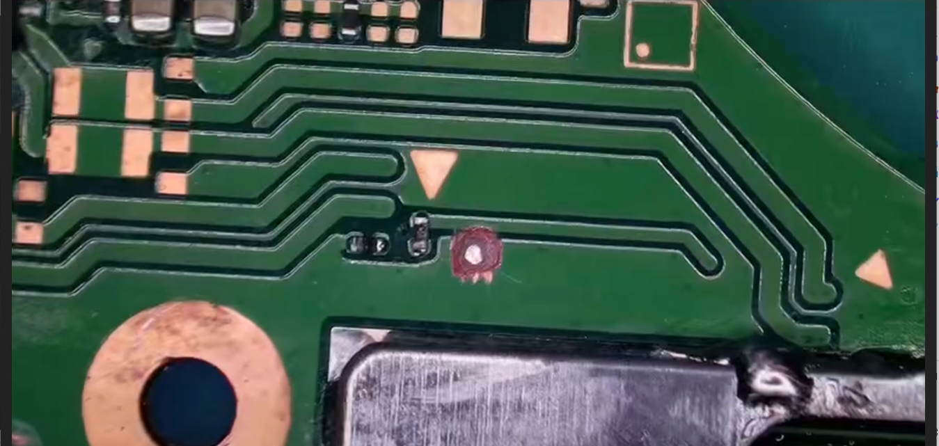

is these a via next to the Dat0?
I found this picture from a another old thread about dat0 alternative.
I dont really like the way to take the data signal from the balls of the emmc.
Sometime i have bad Dat0 Adapter..
Did anybody try to drill?

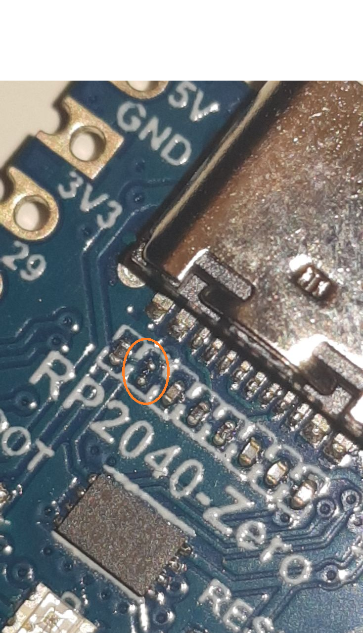

I noticed that every RP2040-Zero from my last batch is missing a component in the circled spot.
Should I be concerned? They all behave correctly when flashing, still haven't tried them on a Switch.
I bought them from my usual seller on Amazon. Maybe they were like this all along but I just noticed now and I'm being paranoid?
I think it's by default. None of my RPs had that component attached (25-30pcs)
