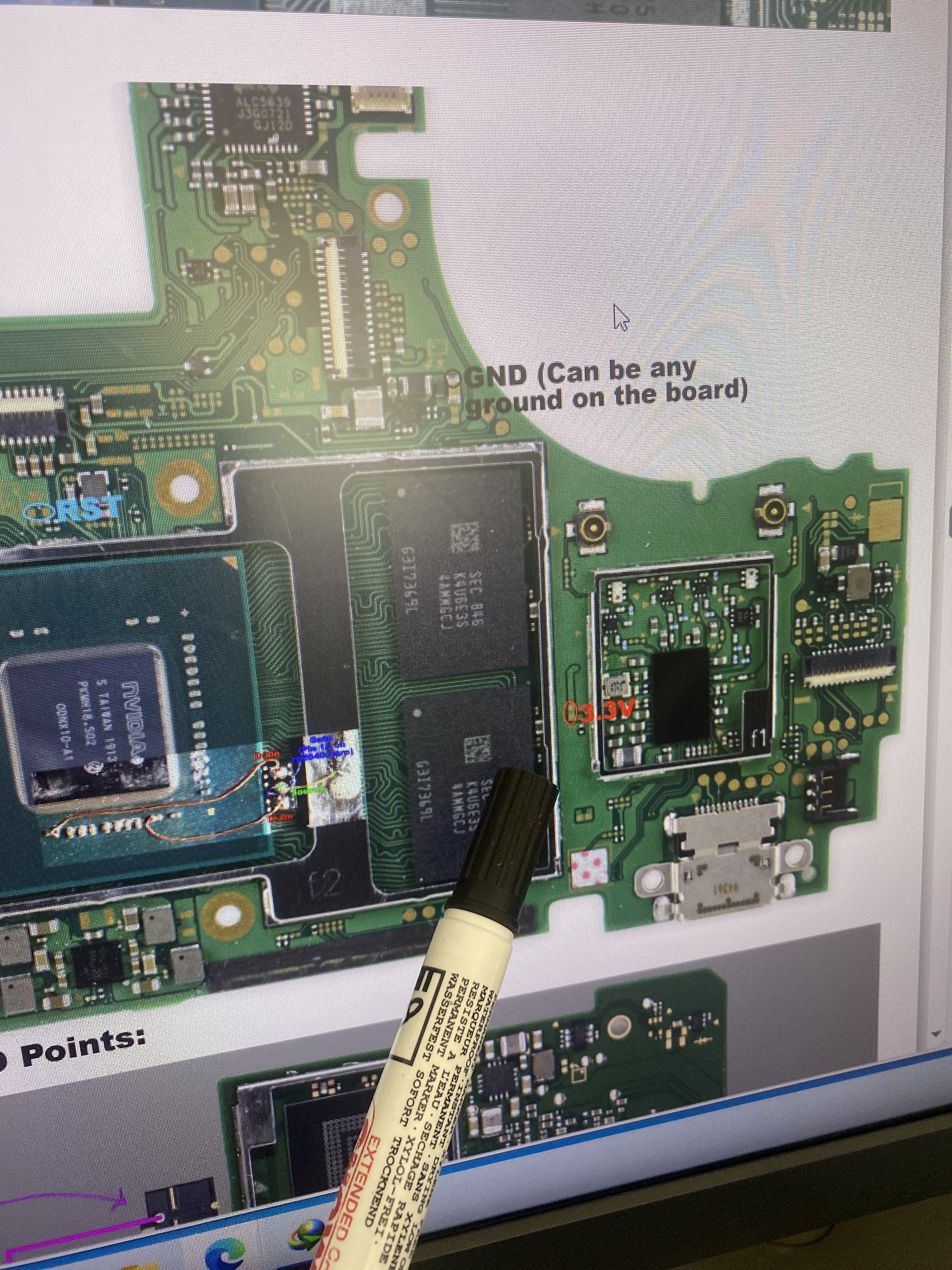

Hello,
I have a very bad day. I've dropped the screw driver on the SD/Gamecard board of my Switch oled and one of the capacitor (or so) has come off the board. Luckily, both SD and gamecard still working good. If you have experience if the capacitor will affect anything please let me know.
Thank you.
measured 3.0uF from the cap you missing. I guess you could use a 3.3uF 0402_6.3v

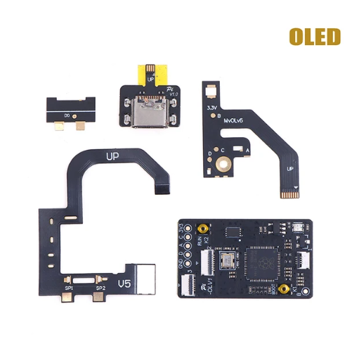

Hi. I found In AliExpress a lot of Instinct clones with RP2040 chip. They are about 10€, and I suppose the installation in OLED is toooo much easy and clean with flex cables. Anybody try them? Assume they use picofly firmware.
Thanks!
i tried this (in the photo i attached) and it's working well, i just preferer this because flex cables don't get twisted when installed

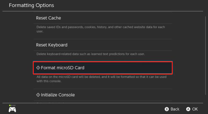

try reformat it as fat32 using AOMEI Partition Assistant Standard or linux os system (i have linux mint)
i have some issues with sd card sdcard formatter not working for me or even default windows format

back then im getting that error too,
cuz i choose the wrong format file system
after i change
it boot normal
