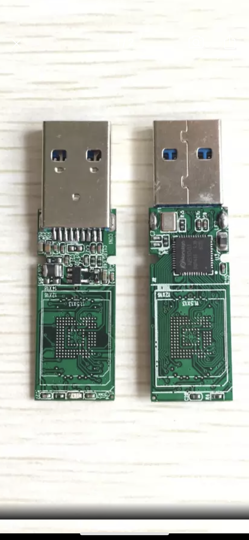

Hello guys.
I bought this from Ali but could not figure out our Emmc’s orientation. I mainly rely on the single extra dot that is seen on the top right corner. It is not seen here. Any advice is appreciated
Hello guys.
Your chipped side is your dot placement. Even without that its not hard to tell which is which from the missing balls in front.

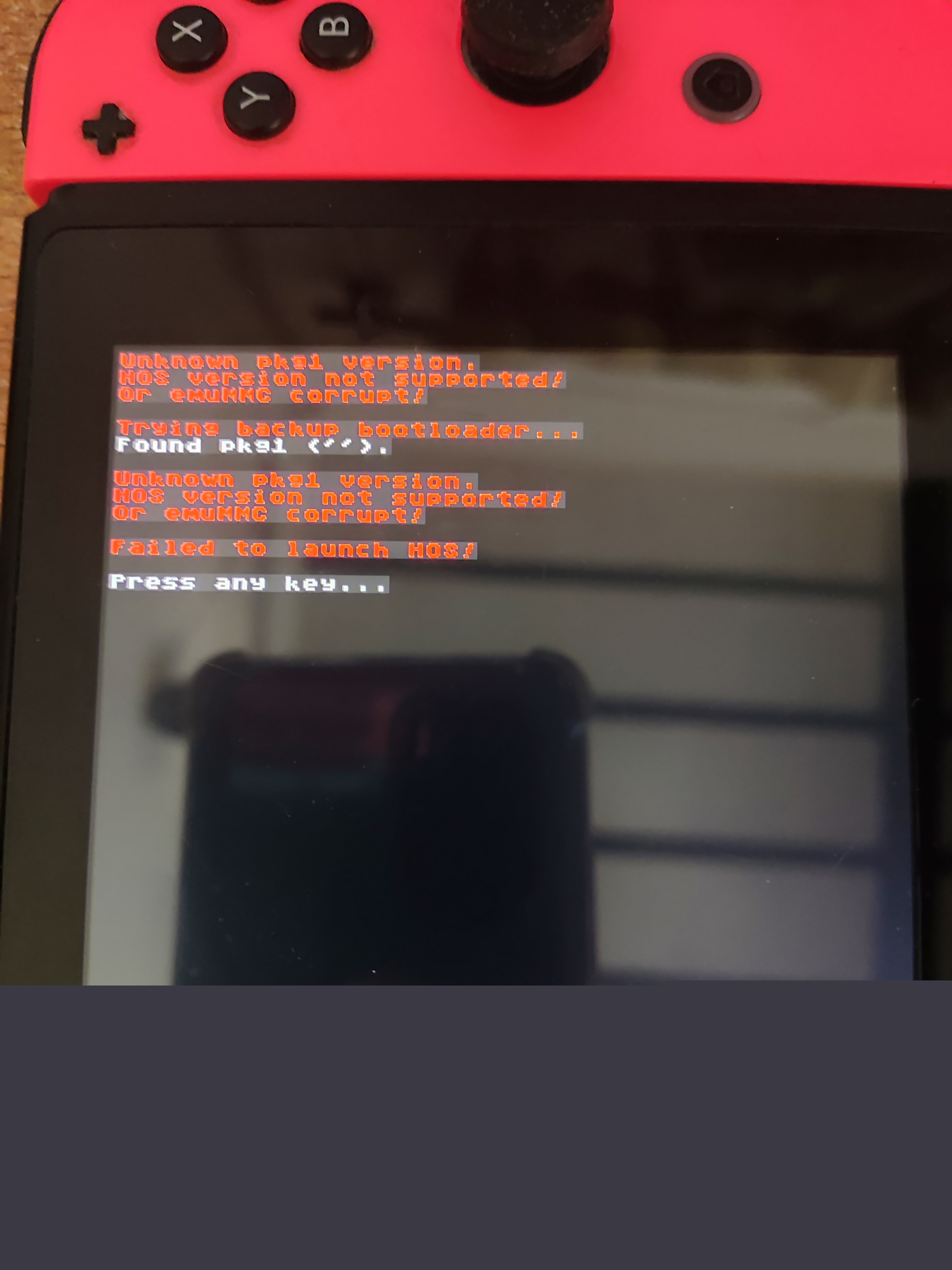

V1 Erista unpatched.
Issue solved adding one more resistor to dat0 line.
Unknown Pk91 version. HOS version not supported!
Trying backup bootloader... Found pkg (>.
Unknown
k91 version.
Failed to launch HOS!
Press any key...
Unknown
k91 version.
Press any key...
For launch error i think you need to match switch emmc firmware version with atmos that supports it.
Other possible is sdcard is fake/clone/defective, try to change the card.
Unknown
k91 version.
Press any key...
Try add more 47 ohm on cmd.
