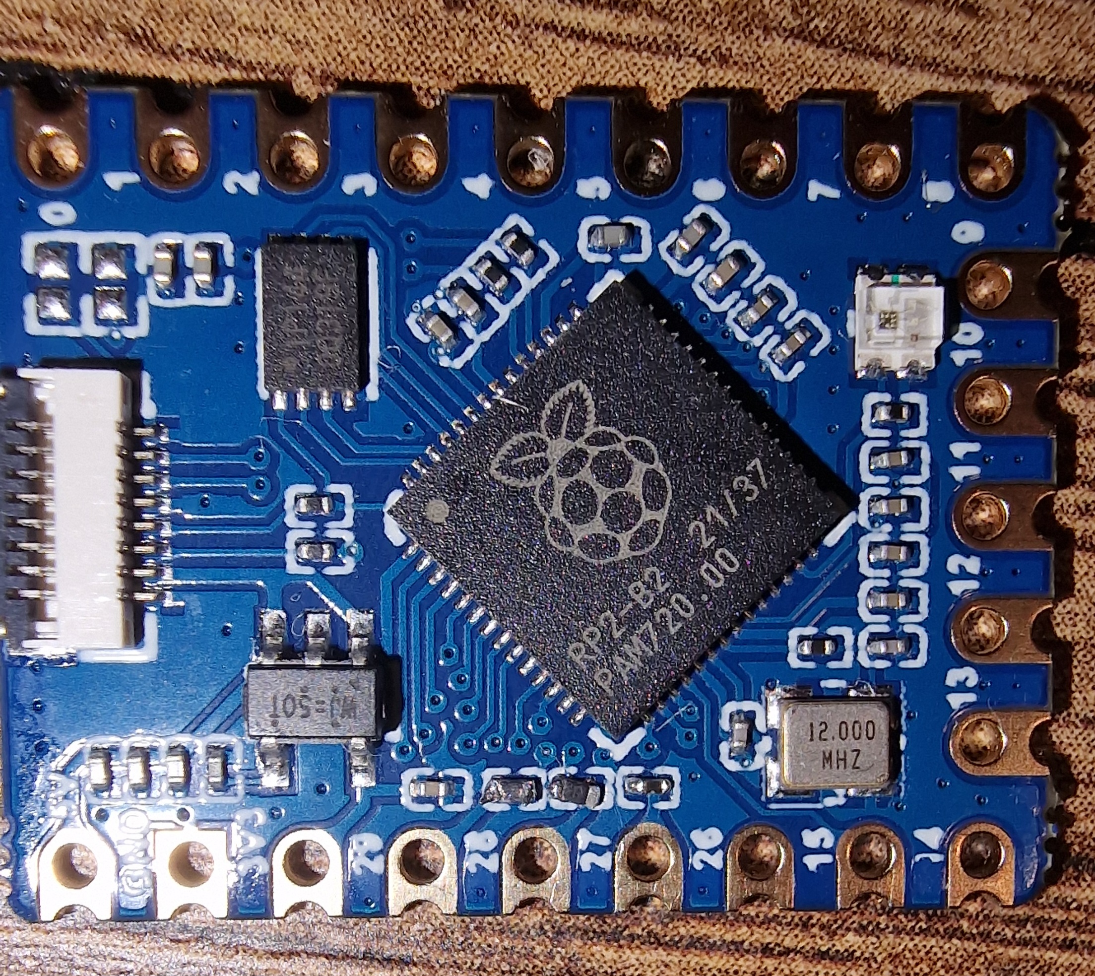

I was excited to try out RP-tiny since it has these pre-soldered, but seems that we still need to solder 2.
What is a good approach for adding 2 resistors to cmd and data on tiny? Should I just add a single to each pad as if it was a regular?
I'd like to report that I also got the slow emmc error when using 47s. This should be the standard.
That should work, no problem. But if you want to make it look good i think that replacing the resistors on board would be much better :)
i think the best thing to do is take 47ohm of and set a 100ohm resistor instead of adding another 47 resistor to it .
if u really want to take the route with 2 47ohm i would suggest cut the line that goes from the 47 ohm to the solder pad and add another resistor behind the original one .
just got to make sure u cut enough of the via away that u can set the second resistor properly with out any bridging underneath

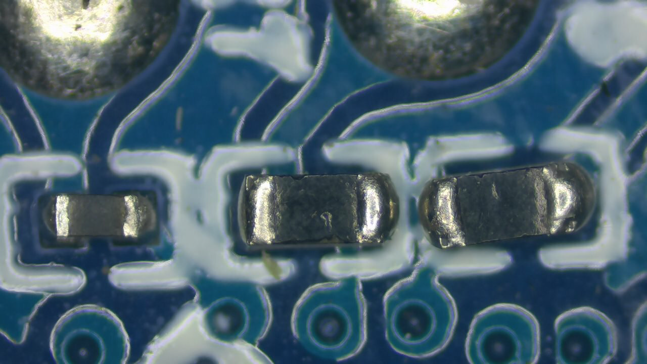

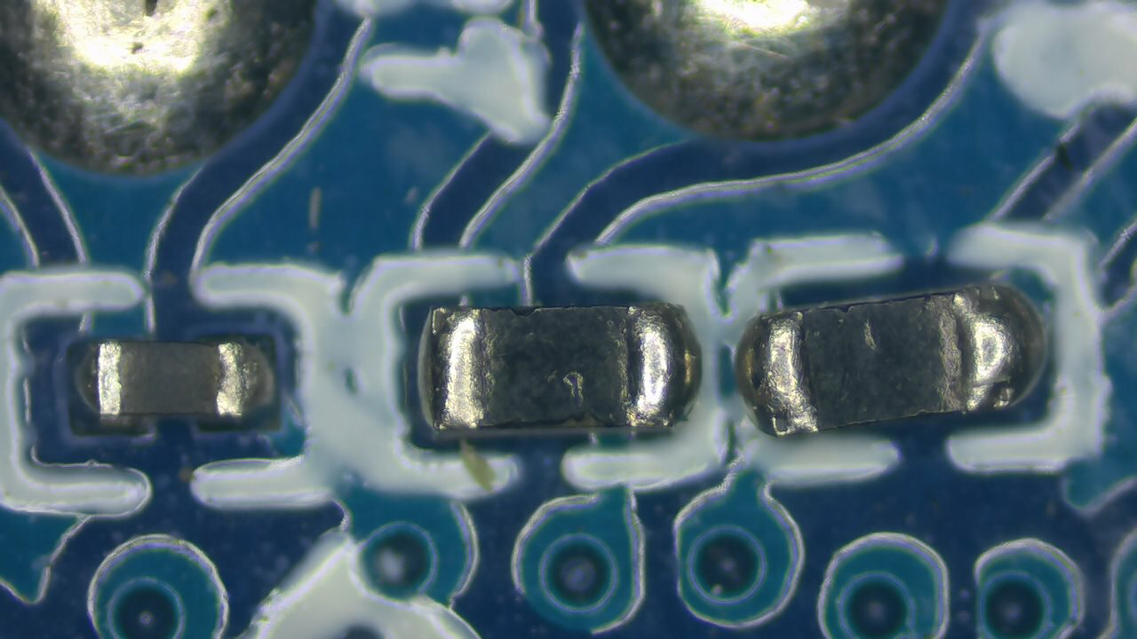

So I got off my a§ and gave it a try because sometimes I don't feel good giving out advice for things I've not tried myself :D
Since I did not have any 0201 resistors at hand I used 0402.
And since the solder pads on board are not made for this size I had to place the resistors slightly off place in order to be sure that they are making good contact.
Everything is measured and everything works as intended.
I did this using a 0.1 solder tip but I think that if one is to use 0201 resistors it would be much easier to use kapton, solder paste and hot air.
I did this using a 0.1 solder tip but I think that if one is to use 0201 resistors it would be much easier to use kapton, solder paste and hot air.View attachment 390148
i just add a bit more solder to the pads and use hot air and flux to set them and push a bit down on the resistors.
i also use 0402 resistor size
well if it flashes blue once and then green once it should glitch and boot the no sdcard or to hekate , so in ur case give of some pictures of your install please
Yep, this definetly looks better. I'll give it a shot tomorrow. Thanks for the tip 🍻
