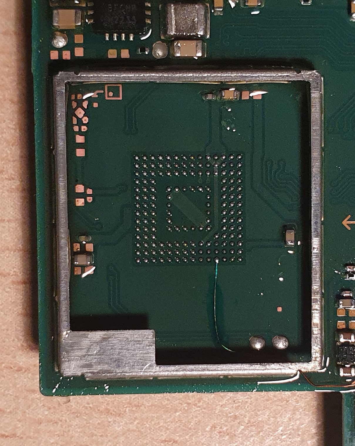

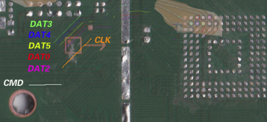

Can you write a tutorial about this method similar to xbox360's kamikaze hack? How do you mark the right spot? Thanks
I made the mark by scratching slightly with a pin.
These last photos that I uploaded are the final ones and I think it is enough information to be able to replicate it.
I got the idea from a single image in this thread dated March if I remember correctly. I attach the original photo.
It's quite dangerous precision work but so is touching the console in general or scratching the clk point.
The next thing I'll do is reballing to see if I specialize.
How many did you do so far? This is just BALD.
Four times.
Four times.
The clock line is two layers down?

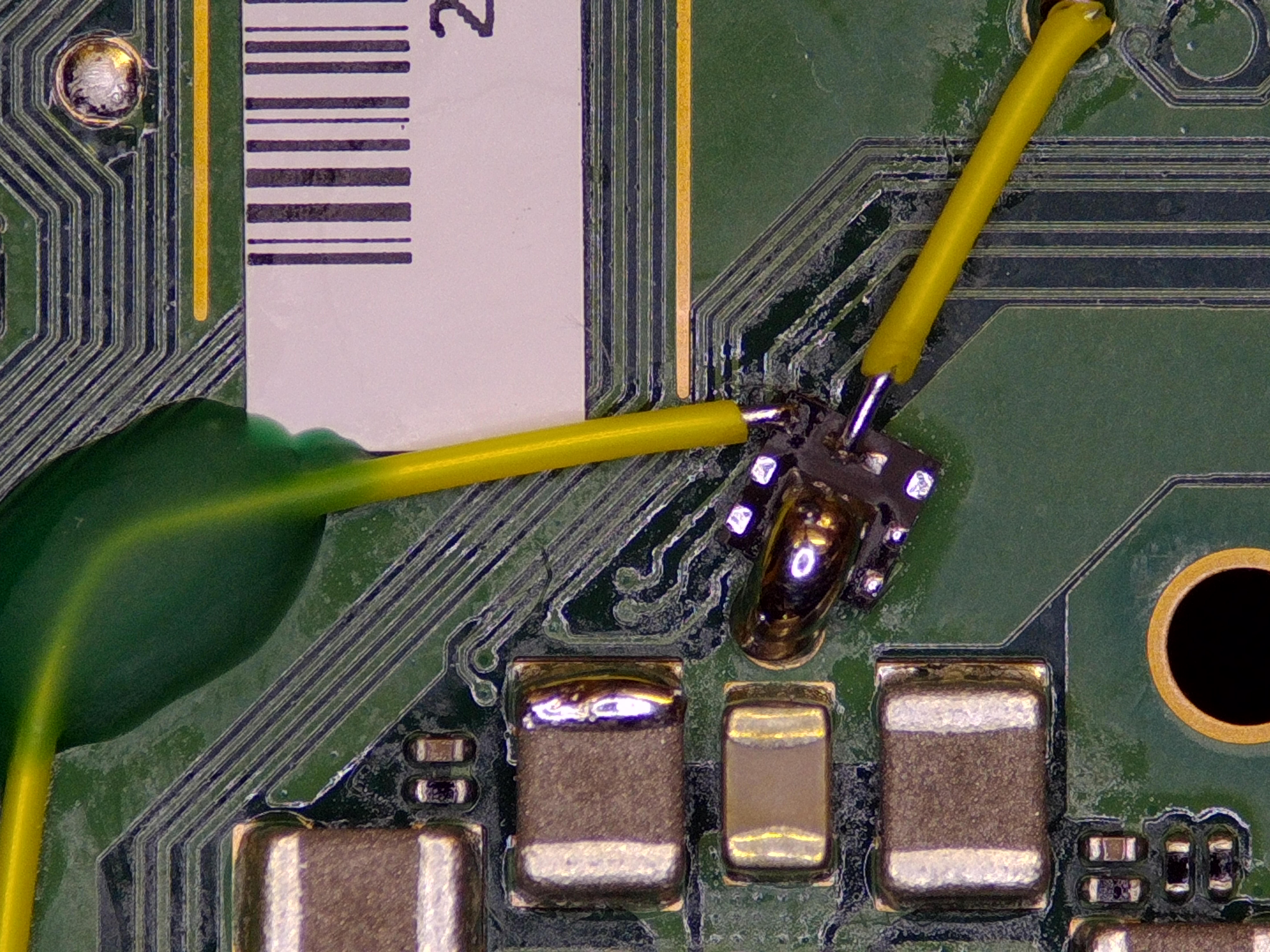

Per @abal1000x's testing, I've been successfully using 33k on these:
10pcs/lot IRFHS8342TRPBF IRFHS8342 IRS8342 IRH8342 IRS 8342 , QFN-6 8.8 A, 30 V, 0.016 ohm, N-CHANNEL, Si, , MOSFE new
https://a.aliexpress.com/_mrG9DVc
Hey,
What are these resistors needed for? I've been using This exact MOSFET for months with good glitching. What added value do these resistors give?

Hey,
From what I understand, having a resistor that crosses the Source and Gate of a mosfet protects whatever you connect gate to. Basically, if something goes wrong, the resistor will drain the mosfets energy before it can possibly fry the APU. @abal1000x knows the specifics, am I correct?
Reactions: FreeLander
Yes it is.
All mosfet have capacitance, so need a resistor to discharge it. This to make sure the gate always low first time its powered on, so the DS are not bridged.
For this mod, the scenario happened when the battery are completely discharge, then recharge it using usbc, then the initial state of the mosfet are unknown, the DS could be bridged or not. If its bridged then the cpu 'not working', since the power are 'stolen' by those mosfet. Then the mosfet might burn, because of continuous high current flows on it.
I have checked a lot of cpu flexes and pull down resistors are at some of them 500 ohms each and at some others 1.1 kohms each. Why the values are so low on these flexes if pull down resistors must be at least 10k ?
Reactions: LogicalMadness
Pull downs are min 1k. But it all depends on the device amperage voltage etc. Calculations need to be made to correctly and accurately to determine the pull down resistor for the mosfet and its circuit it is gating.

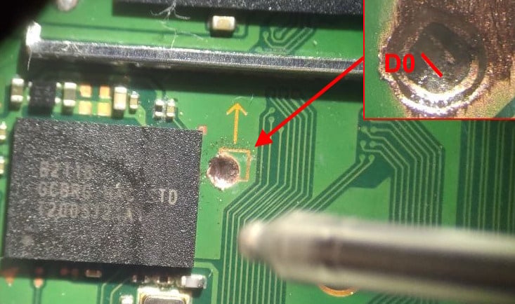

And I dunno why but on the next 2 switch I had to add 47ohms for dat0 otherwise slow mode or no boot on ofw and syscfw, black screen. Everything is ok after adding +47ohms (total 94ohms)
