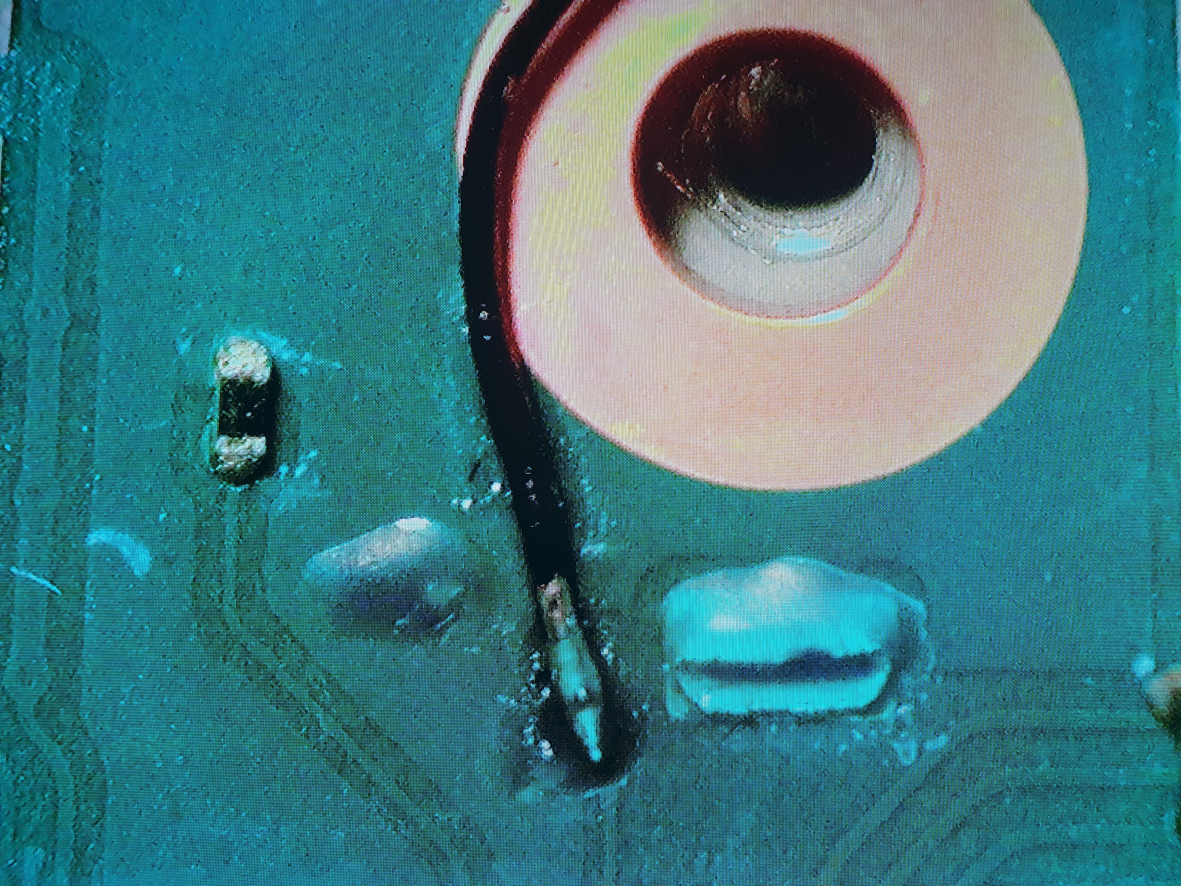

got this v2 that wont turn on...it was a failed installation of picofly..when it boot get a purple/pink light on rp2040. noticed a missing resistor next to rst point. anyone can tell me if it should turn on whitout this ressitor? and if not whats the value of it?
What pico do u have?
We don't use colors anymore
What's the firmware u flashed ?
4.7K ohm

resistor changed and it gives a solid reading now but still got the same error. Removed everything and it still boots into OFW so thats a plus i guess. The pic shows the alleged scratch that is covered by solder mask (between the clk point and the newly installed resistor). I honestly think its not that because it boots fine and going into data management on the switch shows the correct nand storage capacity so its reading fine. I saw @RedFawkes has the exact same problem as me. Wondering to go for another reball. Would it even boot into ofw if the reball was bad? Or could it be the dat0 line has shifted under the reball and is connecting a line with dat1? but then there would be a bridge unless it cleanly makes contact with dat1 but i find it hard to think that plausible because i've solder masked the line like always so it can only stay in the dat0 point with very little end wiggle room. Any ideas? Because I feel like i could play it safe and get rid of it as ofw. Or whatever the fix is but i dont want to chase my own tail. its a head scratcher!

Show pics from ur complete install.
If the emmc wouldn't be reballed properly then u would not have ofw running .
Are u sure ur wires are connected to the correct pins on the Rp tiny

Everythings disconnected now though (did it to check if ofw runs with the chip disconnected - and it does) but I have done one thing different in this install which is bridging the 3.3v caps. Do you reckon thats the issue? And I've swapped out the tiny with a normal rp2040 this time that was from a working switch i had around. And using that gave the same error code.

Posted this a few pages back here it is again. pins and everything are all fine.
I think tomorrow, I will try and clean up the cap point on the 3.3v line and see how it goes from there. Tried doing it first time before but the solder got stuck in between them and bridged there so will hot air remove one, clean the gunk of the other, kapton it off, install the cap back, then re-do the point. Who knows, stranger things have happened. @lightninjay , would those caps being bridged be an issue in the mod process for the 3.3v line?

any picture on the backside?
Ofw runs as normal. Normal boot. Picture and everything 👍🏻. Or did you mean a photo of the other side of the motherboard (mosfet and emmc side)?
BTW, had a look at the 3.3v but no, seems bridging them doesn't matter because their on the same line. And ofw boots so definitely not an issue on the 3.3v caps.

yea, that's what I meant. And in your case I dont think eMMC reball was bad
Will take a pic when I have a go at it tomorrow. Now that I think of it, I did use a different ground point this time. Might change that to a point that I'm more familiar with. Who knows.
Quick thought, could it be a bad mosfet?
Oh wait. Reading around some people have the same totk switch oled as mine. This error code is rare but I think I've figured out the reason for this error code. It's a Japanese model oled. Maybe when the pico and rehisus code is trying to execute, it runs into a different syntax language when communicating with the emmc. So throws the cannot read emmc. I think its this myself. What do you guys think?

If damage was done with the grinding, I'd think the console wouldn't boot into OFW and work fine.
Replaced emmc b/c I heard someone else had the same issue, but they probably used the dat0 adapter.
Diode reaching with red prob to ground for Dat0 is 0.421 and similar for CMD and CLK readings.
I'll double check the dat0 point and see.
