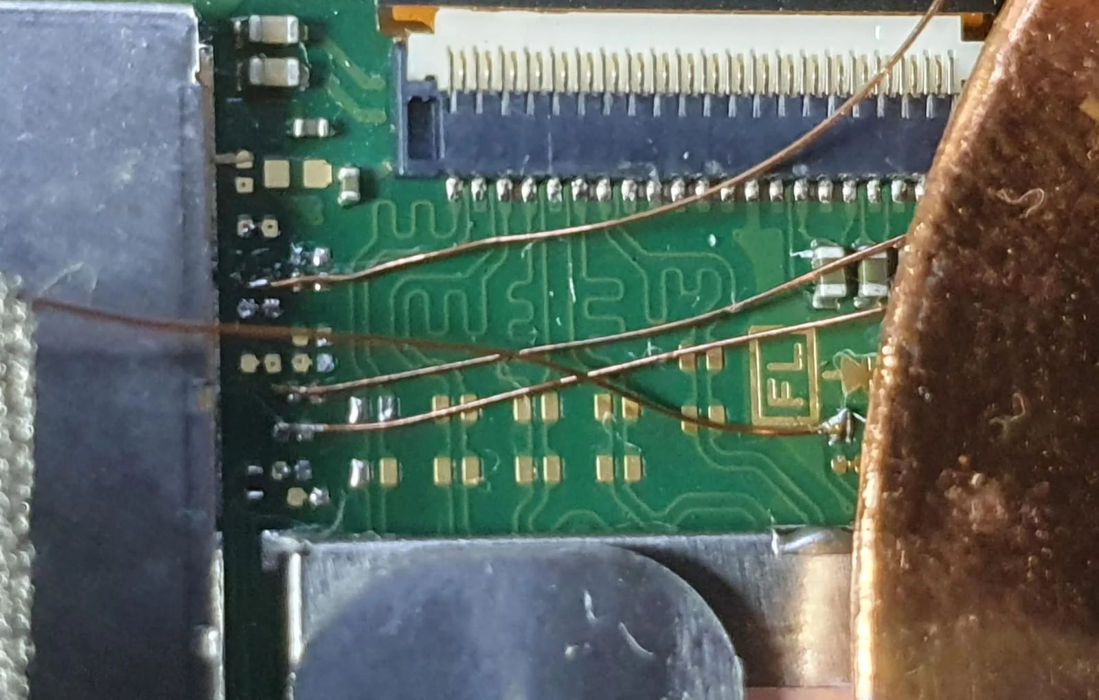

Hello guys! There's any problem in solderind points dat0,cmd,clk and rst whit 0.1mm enammeled wire?
I use 0.32 awg, but feel few dificult in any points.
I decide use 0.32 awg in 3.3v, gnd, cpu and use 0.1 enammeled wire in cmd,clk,dat0, rst.
I bought this wire 0.1 in aliexpress.
no problem at all... ground, 3.3v, Cpu using awg30. else is 0.1 enamel. Been doing that since long.
Hi, if you check a few pages back you can find the suggested seller as well:
https://a.aliexpress.com/_EvsZTb1
I also bought from this shop and it's ok both in shipping times and quality. I am in no way associated with this shop.
U can use 0.1mm for everything there is no need for thicker on 3.3v and and.
I used it on my first 60 installs , now I'm using 0.2mm.
But eather way never had an issue with 0.1mm
