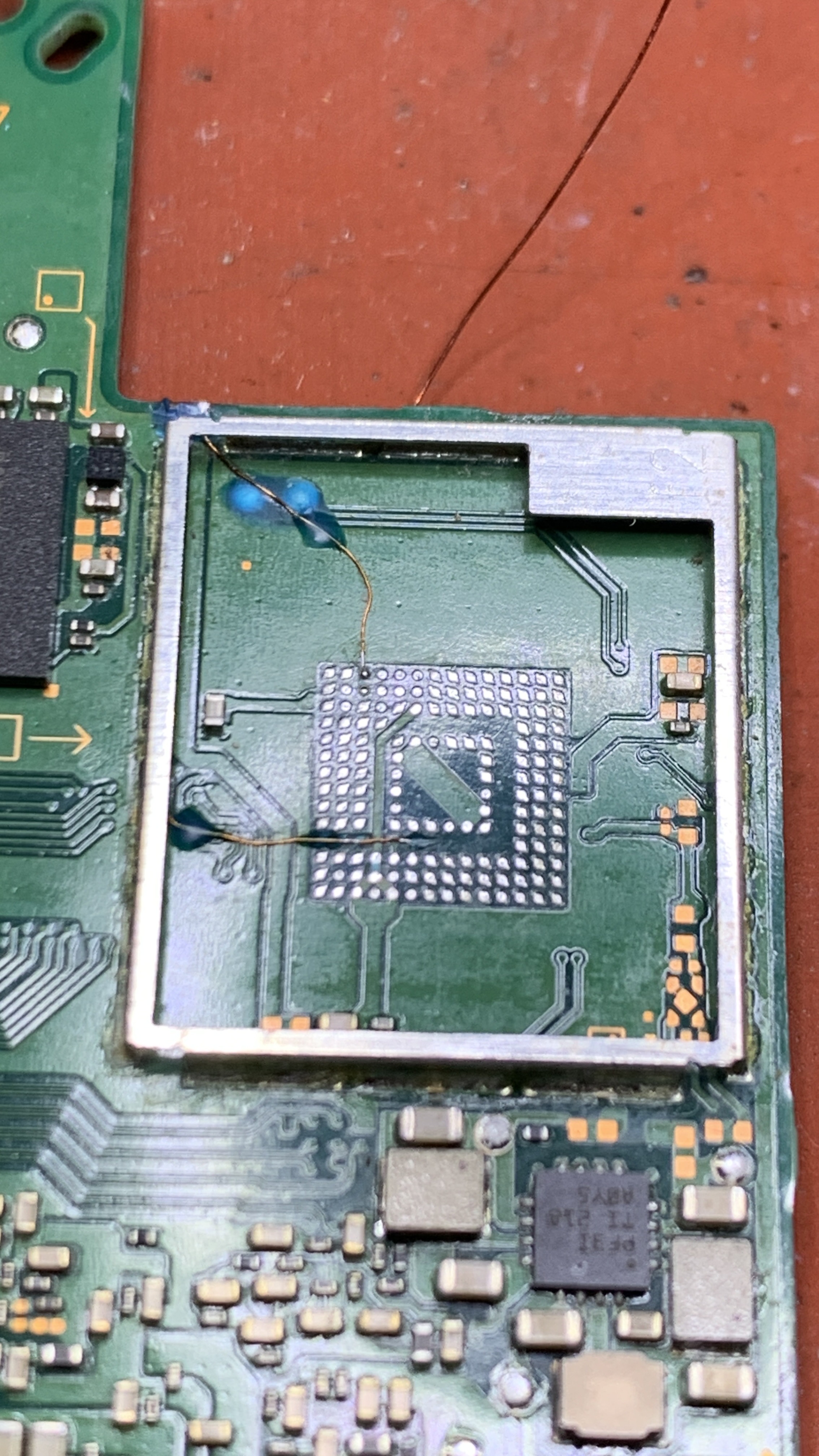

Hi friends, I have a little problem when I do a direct wiring, eMMC for the CLK nothing works the original pico *=* boot I did a continuity test on the AC point under the metal plate, I have well my continuity on my multimeter.

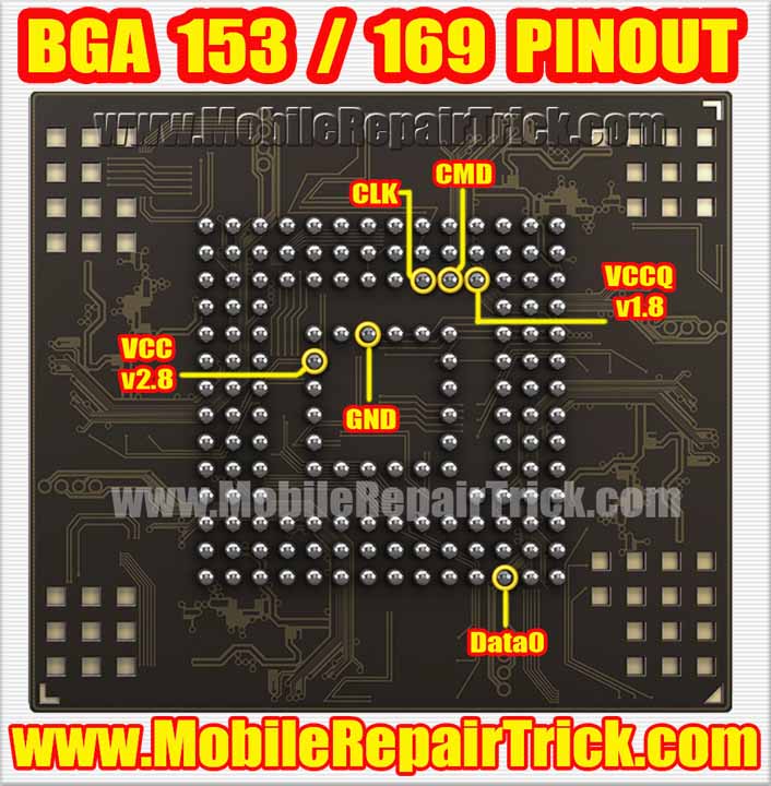

another guy loves dat1 more than dat0?
I wonder what is the science behind these phenomenon.
Its taking the conscious mind to choose the 4th pin than the 3rd pin.
Even i didn't realize at first, until someone point it out.
My mind also choose the 4th pin. :rofl2:
