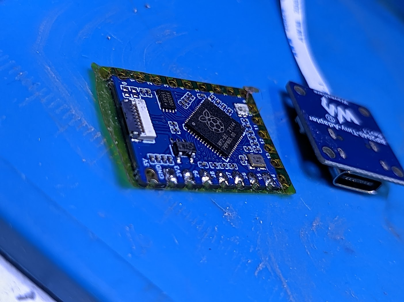

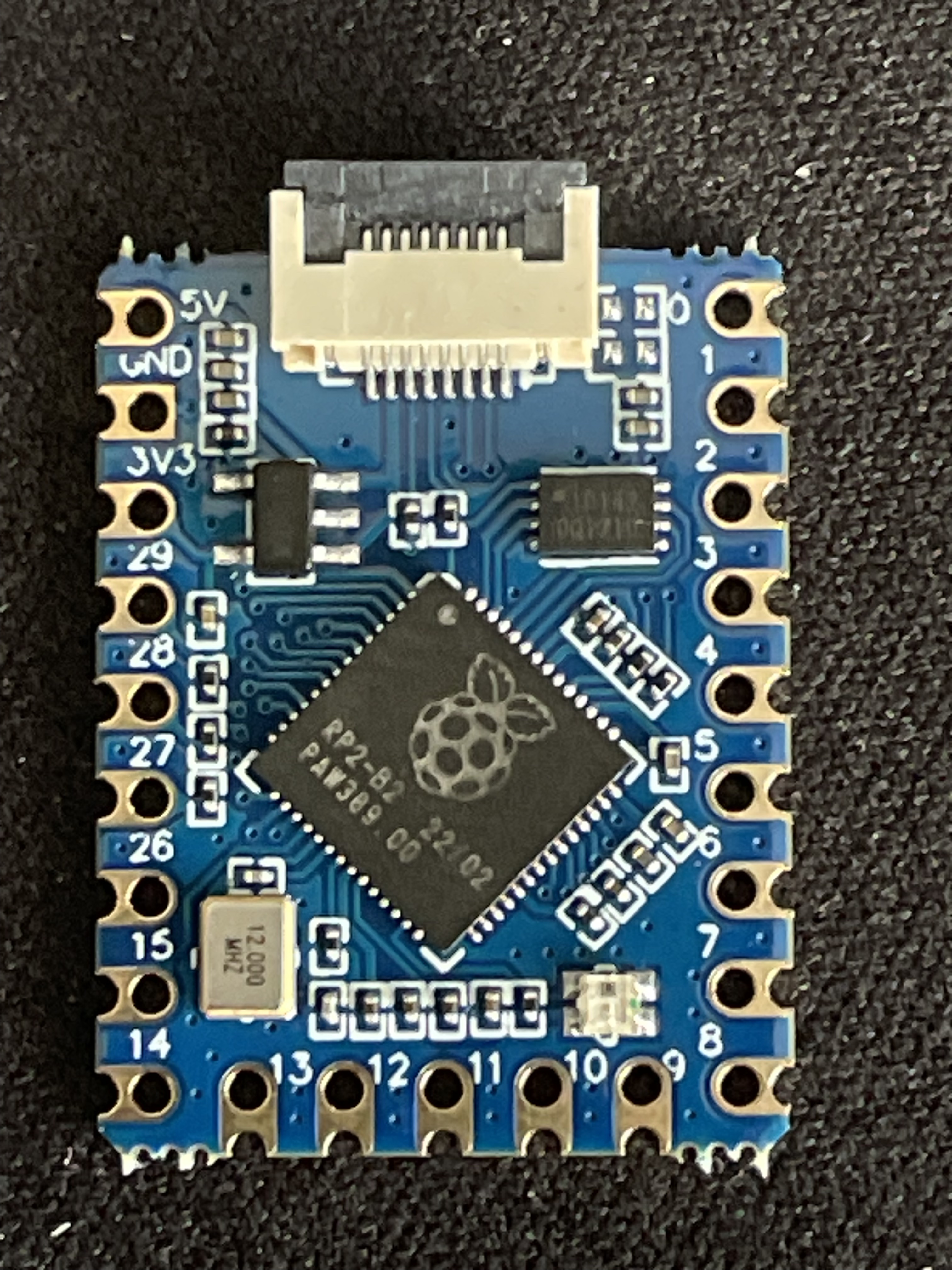

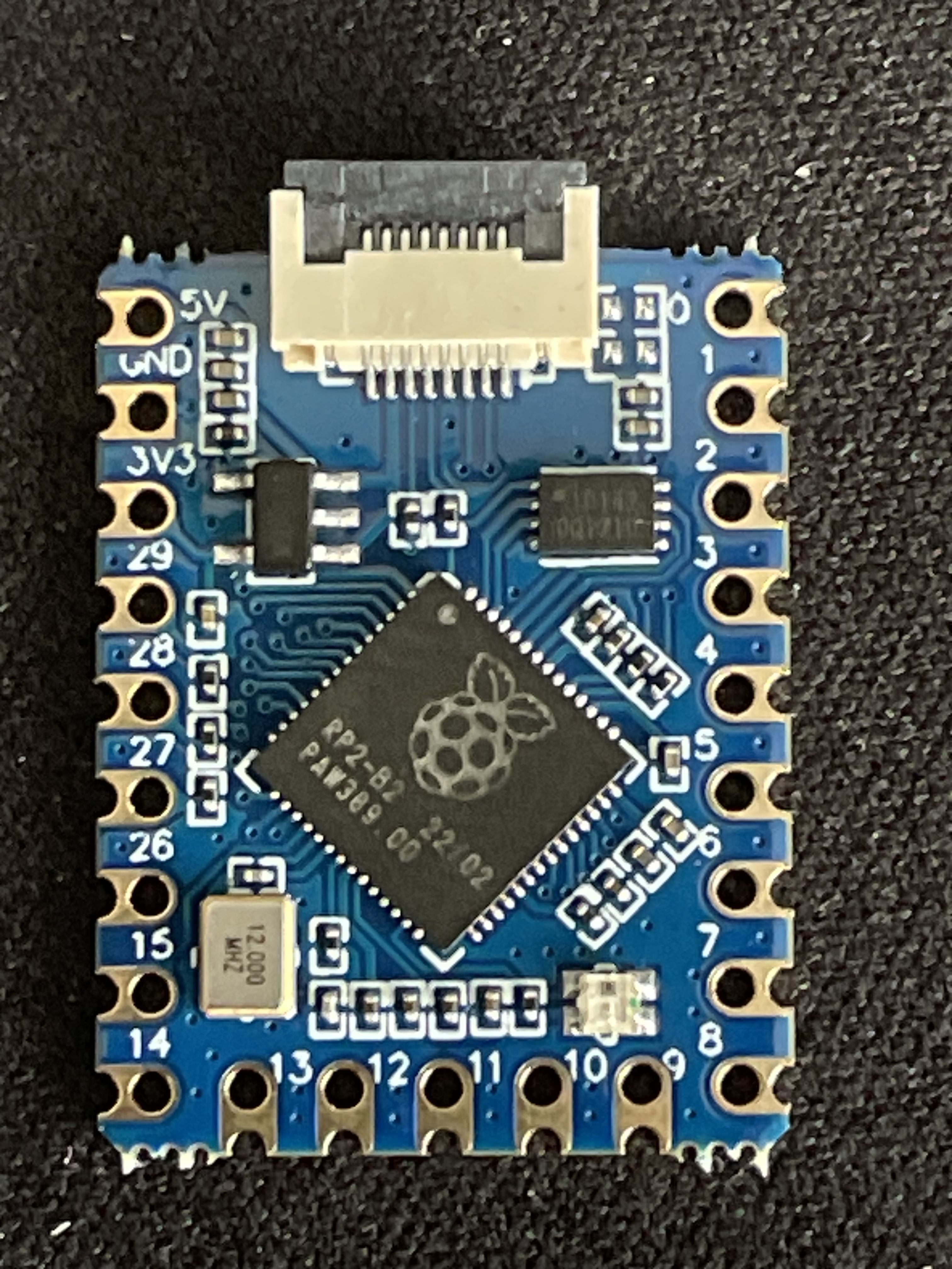

FPC connector and LED look different from rev1.1 I have
AFAIK that's not the original ,the v1.1 I have got a small connector
Apparently this is the new batch... not 100% sure. Just got them this week and ordered a week ago.
Have ordered all my rp2040 chips from this seller: https://www.aliexpress.com/item/100...sea!CA!4445587266!&curPageLogUid=AdugGAB9hBR6
But some new developments from my testing. It seems something has changed maybe with the led and appears to have flashed properly but the led is not lighting up.
I was able to flash fw 2.67 and got a green led once it finished flashing. Installed the Tiny and confirmed with picofly toolbox that it has 2.67. Used the update feature to flash 2.73 which was successful.
Now here's where it gets interesting as the next reboot, the led stayed blue even though it glitched successfully and booted Hekate. Rebooted again and the led doesn't light up but glitched fine. So something is up with the new led maybe?
Might swap the led from the zero and see what happens :)
Yes. I had ones with those connectors last time I ordered maybe one month ago.
Have ordered all my rp2040 chips from this seller: https://www.aliexpress.com/item/1005005686239378.html?spm=a2g0o.productlist.main.3.6ebc709cgwlO8k&algo_pvid=a03ef723-f684-4016-90c8-12d41c002a8c&algo_exp_id=a03ef723-f684-4016-90c8-12d41c002a8c-1&pdp_npi=4@dis!CAD!5.44!5.16!!!3.93!!@2101d8b516934929012911641e6807!12000034008249505!sea!CA!4445587266!&curPageLogUid=AdugGAB9hBR6
The connector is weird.
Do you buy from here
https://www.waveshare.com/rp2040-tiny.htm
Or from other shop which claimed original?
that's clone for sure, official WS has the big WS logo on each pcb(adapter & rp2040)
Not original ones
Aw dang, you're right! My adapter bought previously from the same seller has the WS logo. Won't be buying from them anymore!
I bought from Ali... link in my post above.
Those are not original ones
I bought from that seller too, but thankfully its the correct one.
It seems you got the new batch, the price is increase 7%.
The picture also update, its not the usual connector.
Its weird usually when the price increase means it have a better quality.
I think i understand, they change the fpc connector.
The previous batch have a buggy connector.
But that new one seems have more height then the previous one.
Did they now that Height matter on this mod :rofl2:
This in my order history.
Still the old connector.

No, bought from Ali which turned out to be a clone. It works fine but curious why the led doesn't light up with fw 2.73 and need to do more investigation. Led lights up with fw 2.67 so it's odd. I checked the led vs a zero and they look the same. The zeros I have flash normally with 2.73.

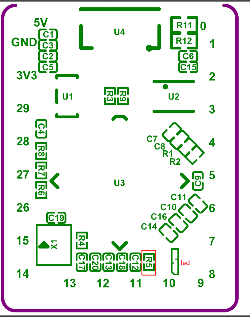

check R5 resistor value if it's 10k ohm
I measured 8.43k ohm. Wish I had one of the previous ones to inspect.
I guess you measured in circuit, but I bet you issue might not be resistor but maybe the led itself.
RP2040 zero has no resistor on LED GPIO16 line. tiny has 10k ohm both datasheet and R5 resistor I measured.
Thanks for the help!
I swapped the led with a zero but made no difference. If I had one of the previous Tiny boards which worked fine (from the same seller) I could investigate more.
Oh well, guess I will stick with fw 2.67 on these boards as I would rather have led codes rather than none :)
