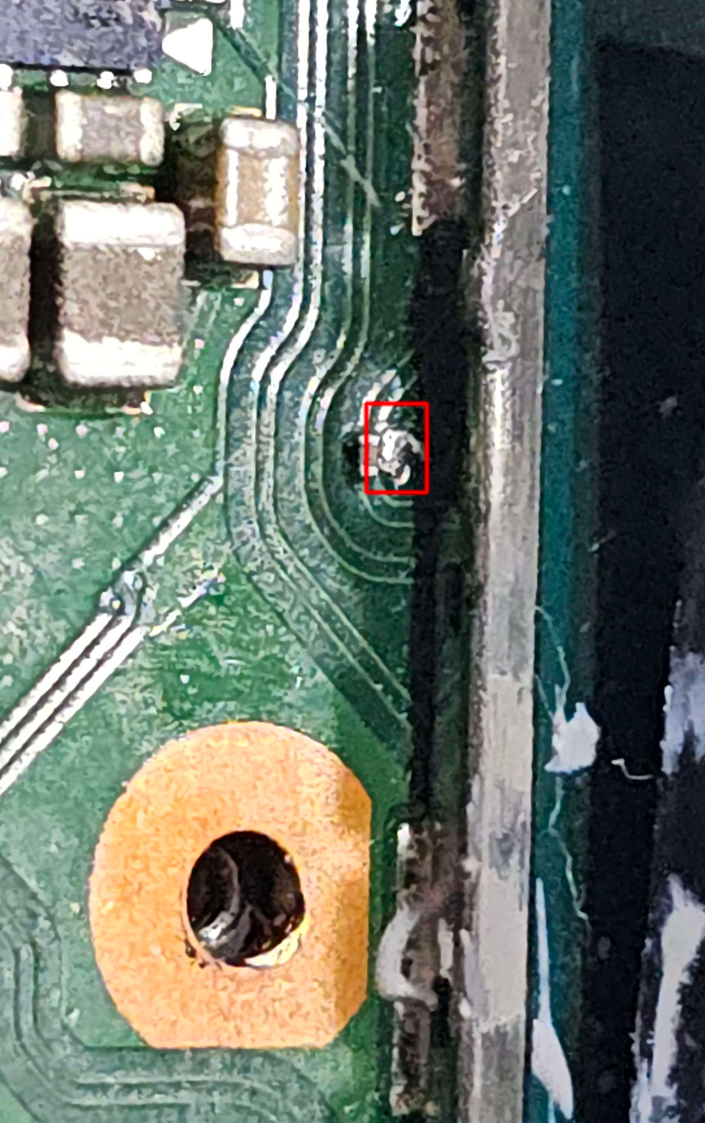

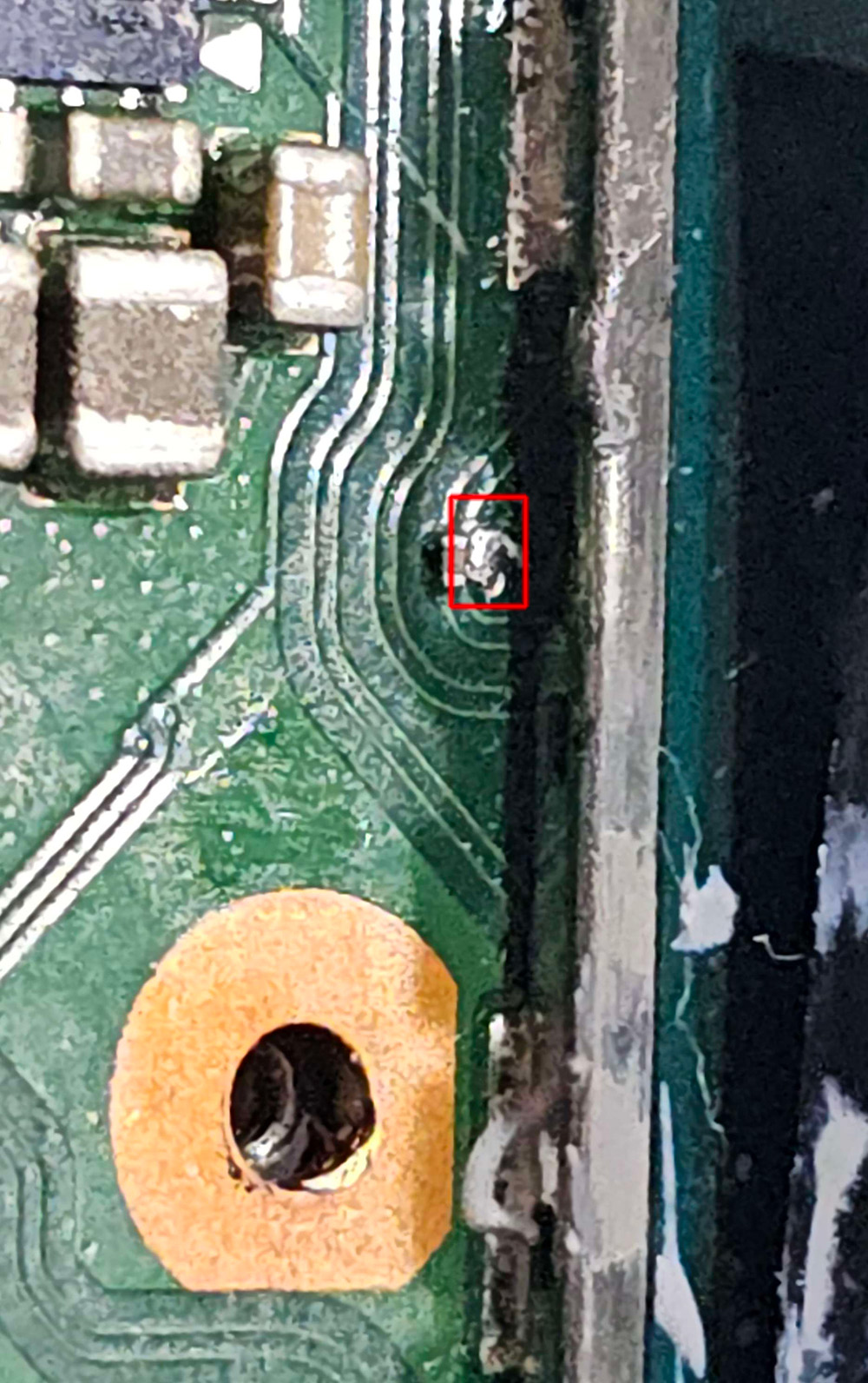

Howdy y'all.
I seem to have broke something when installing my picofly on my V1 switch. It happened when taking off the heat cover.
Sorry, I know it's not the best picture. I took this before I tried re-attaching it. - I ended up losing it after multiple failed attempts to re-attach.
What is the part & Does anyone have any suggestions on how to re-attach it? It's so small it kept wanting to stick to the iron when I lifted it.
Thanks

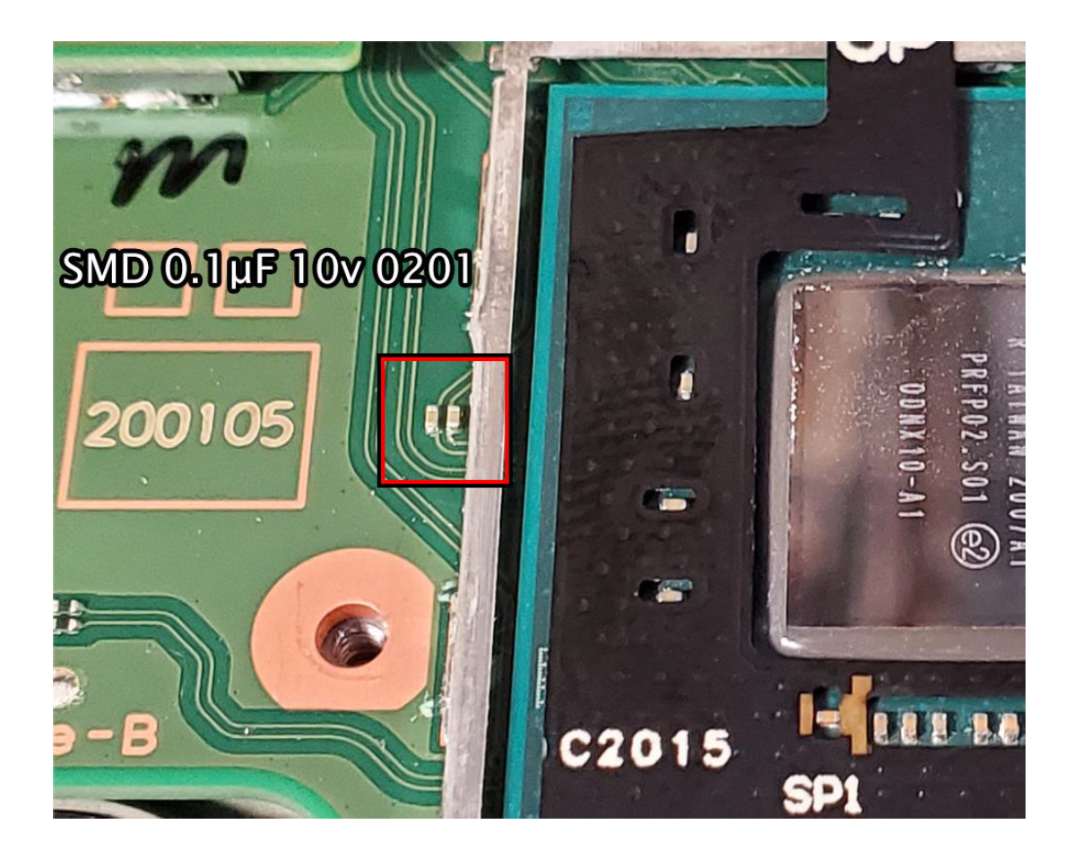

Those are used for Wifi/BT I think.
You need a fine tip iron (0.1mm) and some fine tweezers to work with components that size.
Remove the cap, clean the area with flux and wick, add some fresh solder to the pads (preferably low melt) then hold the new capacitors in place and solder them in place with iron.
You can also use solder paste and hot air station but I will assume you don't have those.
Good luck
P.S. and are you sure you should be doing this kind of work at 98yrs old :D
Good luck
lol, I hit the wrong year & can't change it. Thanks. I need to figure out what the part is so I can get another.
As QuiTim has pointed out, it's in the image he provided. If you are unsure on a source for them, the guide can direct you to some that are removable from rp2040-Zero's and rp2040-One's
Reactions: QuiTim
Sorry I didn't see the picture in the response. Thanks for all the help. I've got some fine tips for my iron on the way, I'll wait until they get here before I try anything..
Reactions: QuiTim
