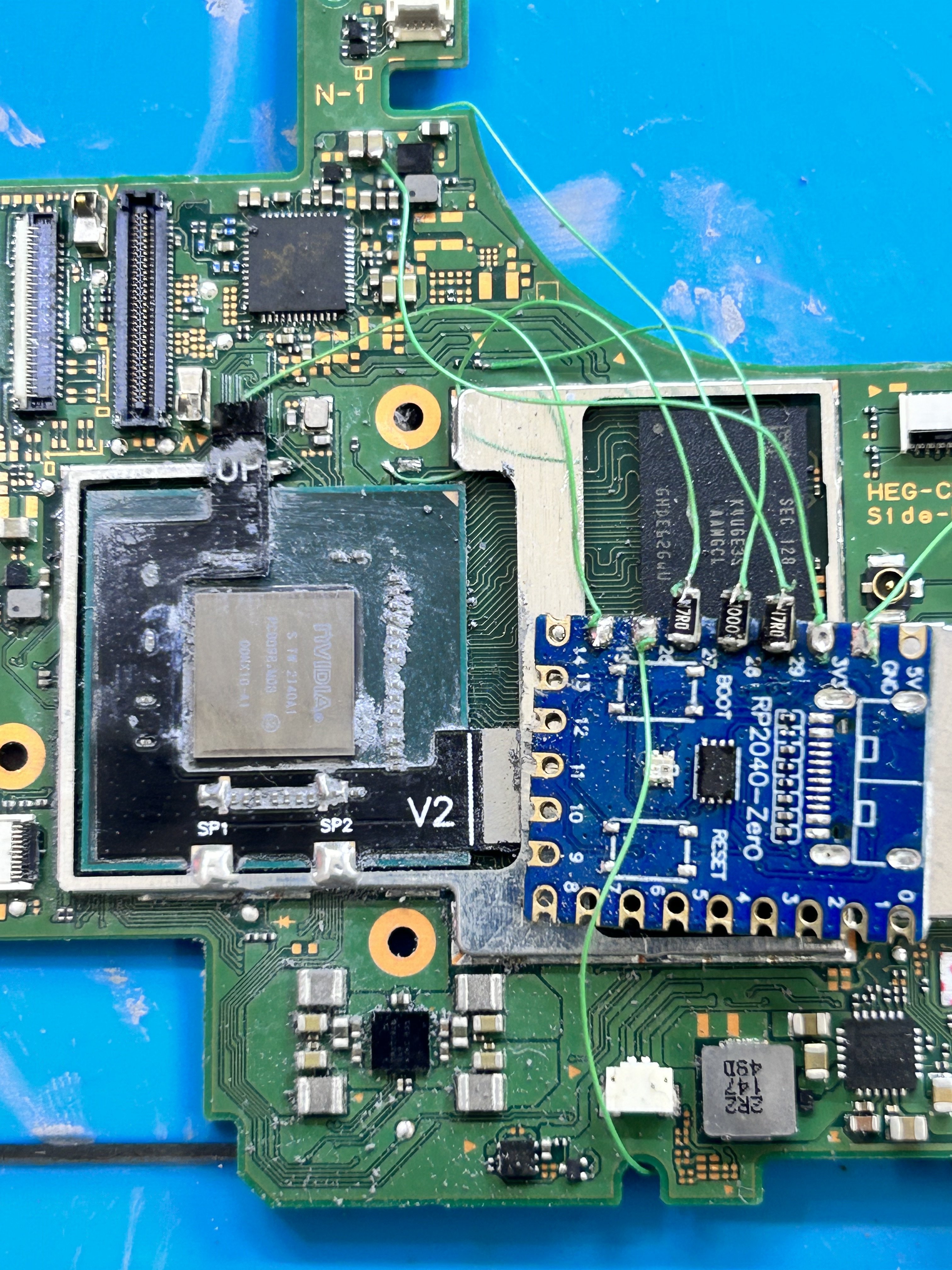

I have some issues with a picofly installation on a oled board and RP2040 tiny.
1.- The RP2040 keeps green led after successfully glitching process and programmed chip
2.- The RP2040 don’t show correctly led colors, when I program the 2.73 firmware the led don’t show any colors like death chip but works correctly, glitch the board.
When i program the 2.67 firmware the chip shows blue -> white -> combination between white and cyan colors breathing -> orange -> infinite green led. I do the bridge in led mod points but the same result
3.- When I insert a micro sd card the RP2040 after show an orange led that in this case means successfully glitch process, send me to OFW. But when I remove the micro sd card the chip send me to the “NO SD CARD” image.
Any idea what can be happen? I
Im Thinking the problem it’s the RP2040 that keeps taking energy from 3.3v cap but idk

The LED issue is related to sh*tty RP2040-tiny knowoffs which have huge flex connector and they did something with the LED wiring (and maybe something else). In FW2.73 the LED is always off, but if you see "NO SD" sreen the glitch was successful and should be ok.
Regarding SD+OFW, try with different card and files.

use a original waveshark rp2040 tiny and not those clones and u will not have any issue i bet , ur not the first one the last couple day with a clone tiny that has issues.
if u give people a devices like this with solder blobs flying all over the place then it is no wonder that u are having issues.
i cant tell that u def have solder blobs laying around atleast between the apu and the ram.
thermal past is flying all over the place.
u should atleast clean the board before u give it back to a customer

I have theory behind this...
There no way that apu solder ball is disturbed let alone became loose just by only soldering the caps.
So the most likely culprit is small solder tin residue contaminating underneath apu ..
And of course if you reflow it then all residue will melt, and base on luck it will solve the problem.. yeah base on luck i must say.
Please onwards can be more clean, especially if you give these unit to somebody else.. be proud of your work by being clean.

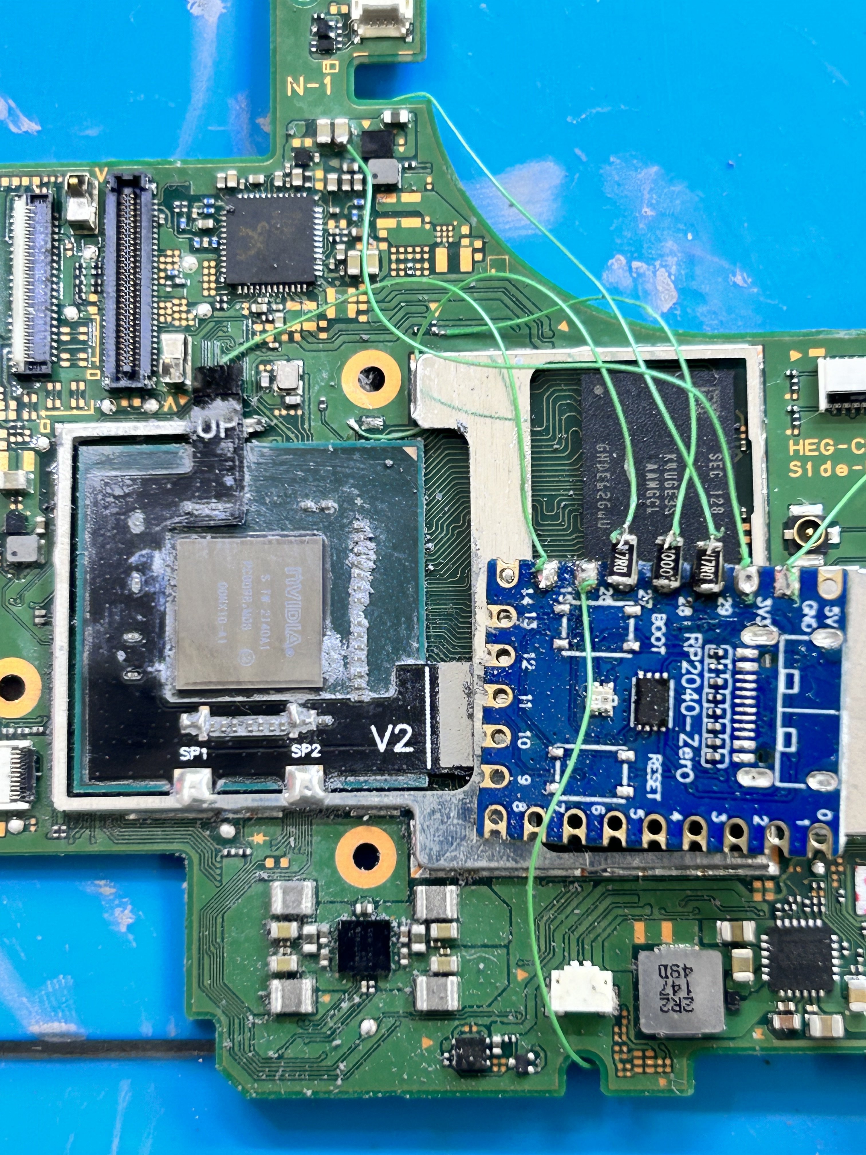

While installing the modchip on a V2, I accidentally ripped a pad (I think is gone, see pic), specifically the RST pad and now the switch is not turning on (no screen, no sound).
Someone knows if it's fixable bridging the traces with the cap?
