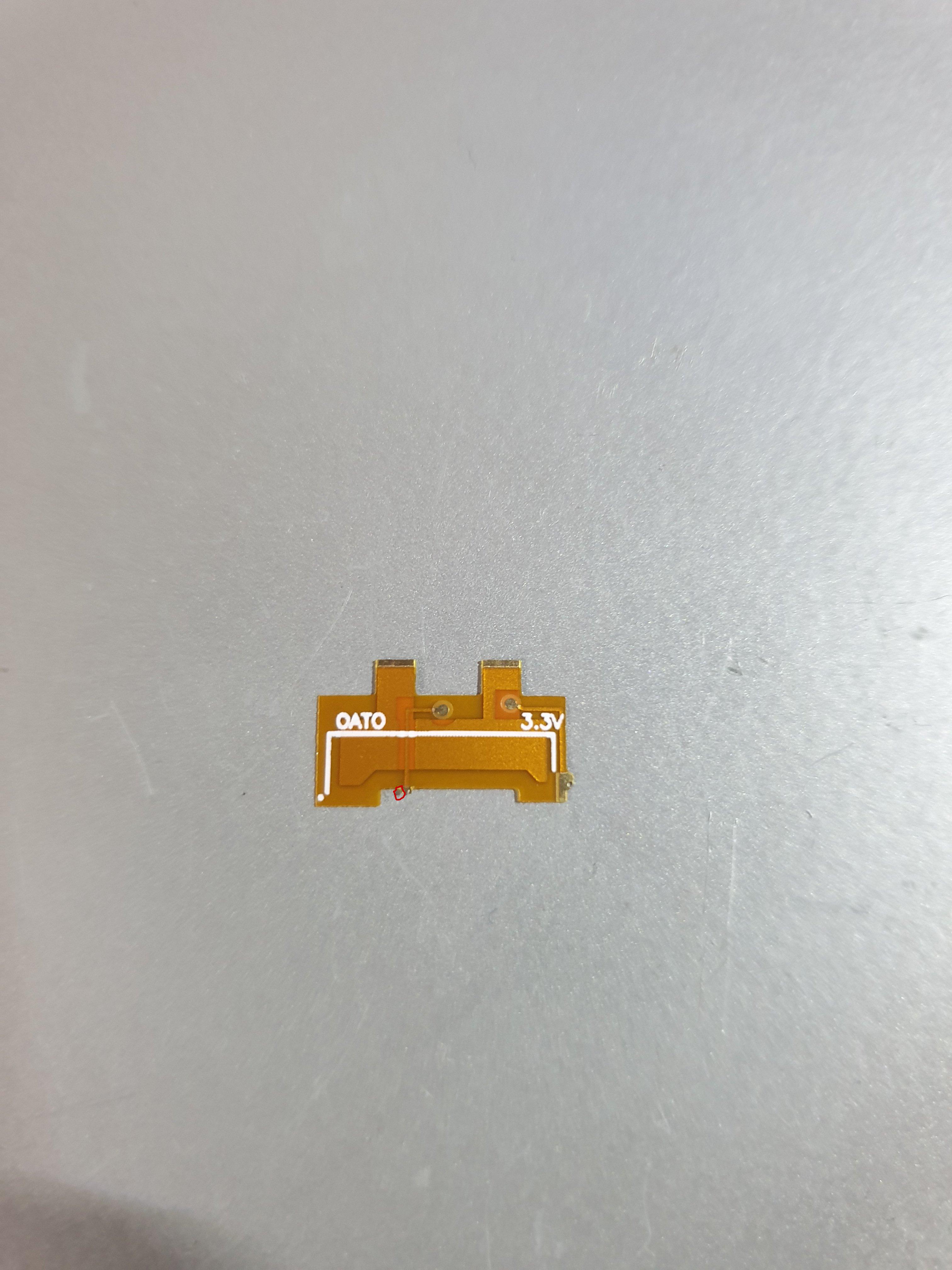

This is the adapter, I really didn't have any issues whit it in the past
that in the circle is that still copper? so connected to the dat0 point ?
if that is the case then u def have bridged dat0 with dat1 and corrupted the emmc , only way is pretty much rebuild the nand.
depends on how badly damaged the emmc is u might gonna have to replace it with a different one.
that means take the emmc of reball a new one and reflow it , then install a chip and rebuild the nand completly and wont be able to use nintendo services as far as i know

That in the circle is still copper, I have jailbroken a few oled switches newer had issues with the nand and Dat0. It was so connected to the nand
Well if that side peace is copper then it has def bridged ur dat0 with dat1.
Normal u don't have that much copper on the side and only the "circle" that goes around the dat0 point , check ur other adapter and u will see what I mean.
I'll see if I have a DAT 0 adapter laying around to show u that , that is not normal.
U see how this looks
but the thing is i dont think that is the dat0 adapter u installed?
lets see the one u installed maybe that one doesnt have that issue.
if it looks the same as the one u made a picture from then u have a bad batch of those adapter
There are a Few people who have already had issues with those 0AT0 adapter
Dont you think the red circled piece goes to the left on DAT0 ball which means is the NC ball yet the dat1 on the right side.
