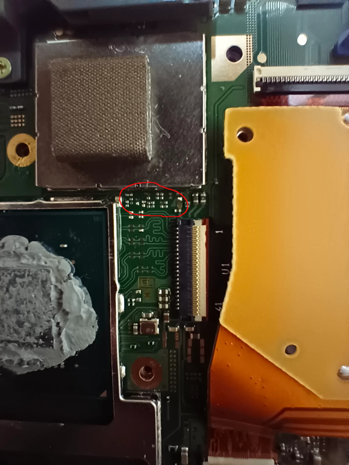

What does an over scratched point look like?
i believe you can find some picture somewhere in this thread, its either traces are cut or via are destroyed.
