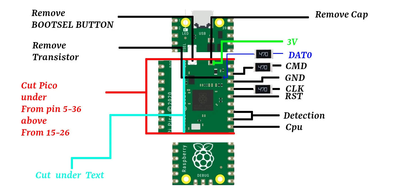

heating up the solder mask did the job and i removed all of the mask successfully and resoldered every wire. but the problem still continues. same error code as the last one and im sure the issue is not about my soldering skills as i've installed two more pico other than this one. any other ideas?
well then upload some of ur soldering pics nice and clear ones so we can take a look ourself
Same. No change i well replace chip raspberry pi pico...
for u to show some pics of ur dat0 soldering and adapter
and since ur using pico did u set the detection pins ?
show picture your dat0 connection on pico
damn a few seconds faster then me Xd
well maybe not seconds more minutes Xd didnt see u posted Xd

i fixed the problem and it was not the soldering issue but an extra resistor on the pico w. i will post photos and a little guide for people who wants to use pico w for picofly.
Same this person but 3v3 not i soldering it in point for capacitor removed.
I would say u connected ur DAT 0 wrong , according to this picture
I would say ur picture are the shittier quality , I guess that guy with the good picture cut the trace above pin 22
To use that for Dat0
Cause if u look closely on the good quality pic it looks like he cut the trace and u did not and that's probably where ur issue is.
So cut that trace that goes from the pad to the via where u set ur dat0 point and it should work since ur having a dat0 issue
Yes brother this is the other new console i think im soldering every time dat zero adapter wrong finally it is cut this tress and cfw working mate... Thank you ❤️ ❤️ ❤️ ❤️
This is adapter that i cut hhhhhhh it is working shity adapter.

LOL ... that was mine .. yeah you need to cut the RUN pin for the jumper to work.
