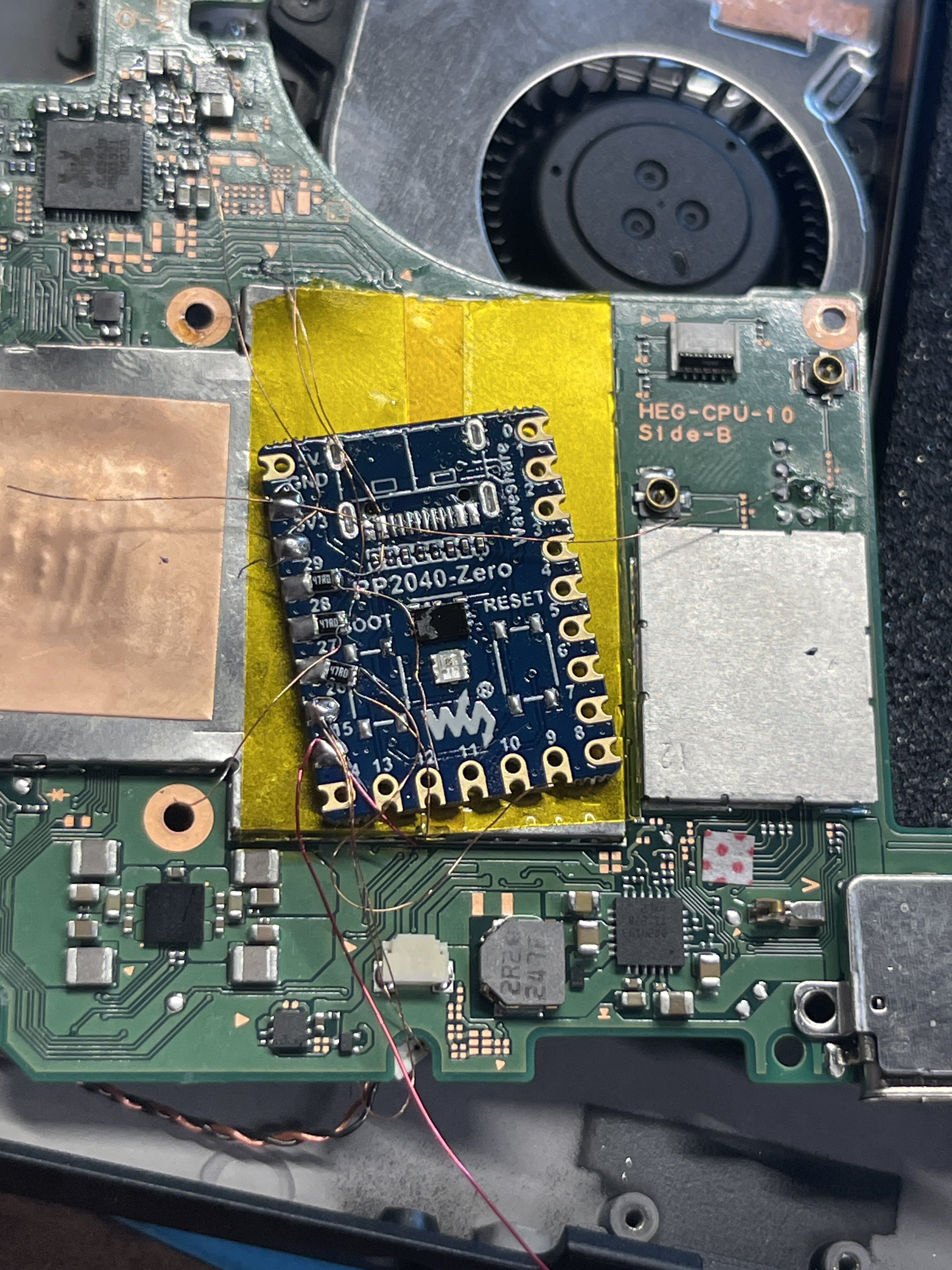

This is a first for me but I’m getting zero lights on the picofly. Anyone had this happen before? I’ve disconnected and reconnected the chip twice. All the readings are good. Any thoughts?

u need to clean up all ur wires first,specialy make sure the end of the wires are not hanging out on ground or something , specialy ur 3 v looks like its touching ground not sure though.
are u sure ur getting 3v and ground and that the rp is working properly ?

how do i check for 3v? Does the console need to be plugged in? When i took it apart it booted up fine. Nothing is shorted to ground. im switching out the chip right now in case its faulty.
optimaly u check it with a multimeter , otherwise maybe with ur tounge but i wouldnt do that Xd
well u need to have ur battery plugged in otherwise u wont get a connection .

Lol. I swapped out the chip and now I get the *== (no emmc cmd1 request)
now wire everything properly not like u have on the picturey, no over hanging wires with the possibilaty something touching and other pads or points
I typically keep them a little long until I know I’m getting the correct code and then I trim. Haven’t had this problem before but will give it a try.

yeah but ur gonna have to change the wire anyways if u just solder them a few cm/inches befor the the end

I shortened up everything and still the same. Could the mosfets be bad? Getting the correct measurements. Not sure what else it would be.

this error typically happens because your clk is shorted to ground or not connected properly. The mosfet isn't involved yet when the test that produces this error is performed
