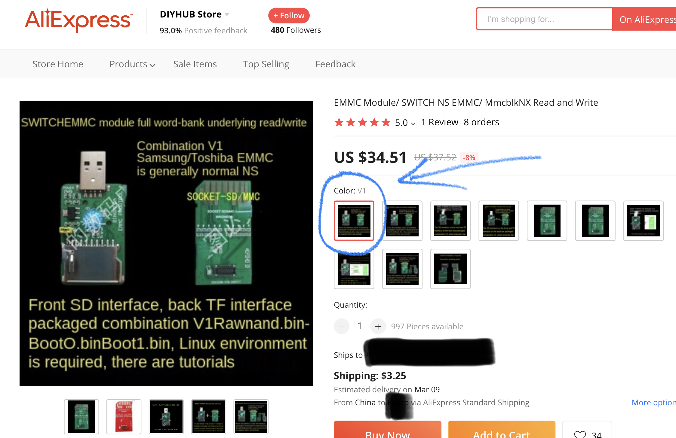

By the way somebody knows a way to connect the MMC of a switch directely to a PC using a "SD Card" adapter? and using something like https://github.com/eliboa/NxNandManager to edit the Boot 0 and recover from a V2 or Lite with AutoRCM enabled?
I did this for my eMMC upgrade. Based on @evil_santa ’s recommend I used one of these:
https://www.aliexpress.us/item/3256803361643934.html
It worked great for a direct copy from my original eMMC to my big one.
Have also heard good things about this one but haven’t used one myself:
https://www.tindie.com/products/ignas/emmc-reader-for-hac-emmc/
This software works for both:
https://github.com/ignasurba/mmcblkNX

From my understanding, you use this things to "clone" your emmc and replace by one more bigger.
Is that right?!
Is that right?!
seems that is what is being said, though that is completely unnecessary as you can just do everything through hekate, clone your nand bkp onto the larger emmc and then expand the partition. I put a 256gb in mine without anything other than the emmc board and a big microsd.
edit: bink points out below, only true for v1 consoles.
As long as you’re on a V1, this is correct.

So, this only work in switch V1? In V2 that is not possible?!
V1 can boot up and act as an SD Card reader with a blank eMMC in place because you can inject a payload. Can’t do this with a Mariko. With Mariko you need a working eMMC so catch-22. This is where the cheap SDCard to eMMC reader comes in.
