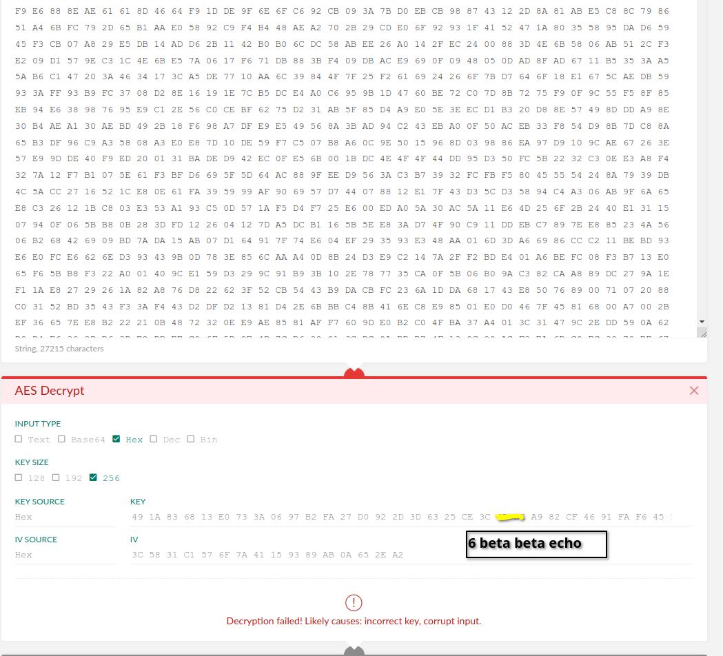

says the data is corrupt, i'm pretty sure i got the right bek, any ideas?

says the data is corrupt, i'm pretty sure i got the right bek, any ideas?View attachment 352992
The key is 128bit, also this is not the Mariko BEK.
Maybe we have differente ones because the one I have the bct start with "CB 2A CA DC" and the original one start with "9B CD 63 58"
