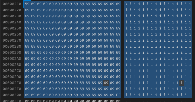

Okay, I took a look at @Tafty 's boot0 dump, and obviously the unlocked ubuntu firmware does not use standard HWFLY-NX's BCT and payload, the keys are completely different:
Erista with HWFLY:
@Tafty 's Switch Lite (Mariko) with unlocked fw:
I'll take a look at the payloads..

Alright so obviously because @Tafty 's Switch is a Lite/Mariko, the BCTs in there are encrypted at a certain point.
Does anybody know if the BCTs are encrypted with the Mariko KEK or BEK? Or is it the custom key? If it is the custom key, where can I find the private key so that I can decrypt the BCT? AFAIK there's only the public key modulus in the BCT :unsure:

looking through hwfly-nx and switchbrew wiki i can't help but notice that although the bct is supposedly encrypted, the mariko bct that hwfly-nx flashes is static, defined in mariko_bct.h. how would that work? are they all encrypted with the same key or what? :ha: i'd expect the encryption to be different from console to console. that's probably the case and i'm not understanding something :unsure:
I have the leaked BootROM specification PDF for the Mariko, it says that the BCT (can) be encrypted with a BEK (boot encryption key), this key is OEM specific, i.e. Nintendo has their own.
So HWFLY-NX probably has encrypted their BCT with the leaked BEK, however they got it. This, however, means that every Mariko has the same BEK.
would you mind totally not sending that pdf my way? :lol:
sha256(csecret_26)=cefe01c9e3eeef1a73b8c10d742ae386279b7dff30a2fbc0aabd058c1f135833 OEM key: Nintendo
although, i'm not getting the results i want.. maybe i'm just wack at decrypting or the key is bs :unsure: . anyone who wants to try, you might get it better than me :ha:, aes-256 cbc, iv is all zeroes as per (at least i think that's what it's saying) the pdf
What did you use to generate this output?
