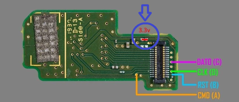

it was booting ok (OFW) before installing the Pico...I used the 3v from the eMMC Module...

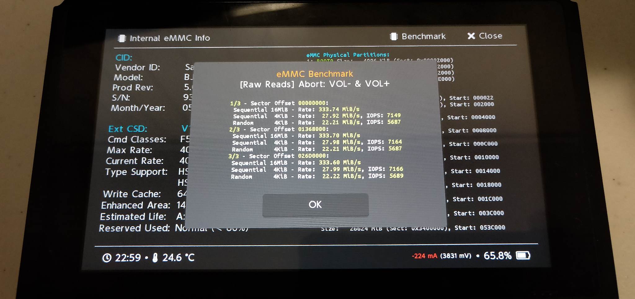

...the eMMC can still be accessed by Hekate and not in Slow Mode...
...I might have to try going 100 ohms on the CMD as @abal1000x suggested.. though I'll have to find a 100 ohms resistor if I have one... will 47 + 47 ohm work?

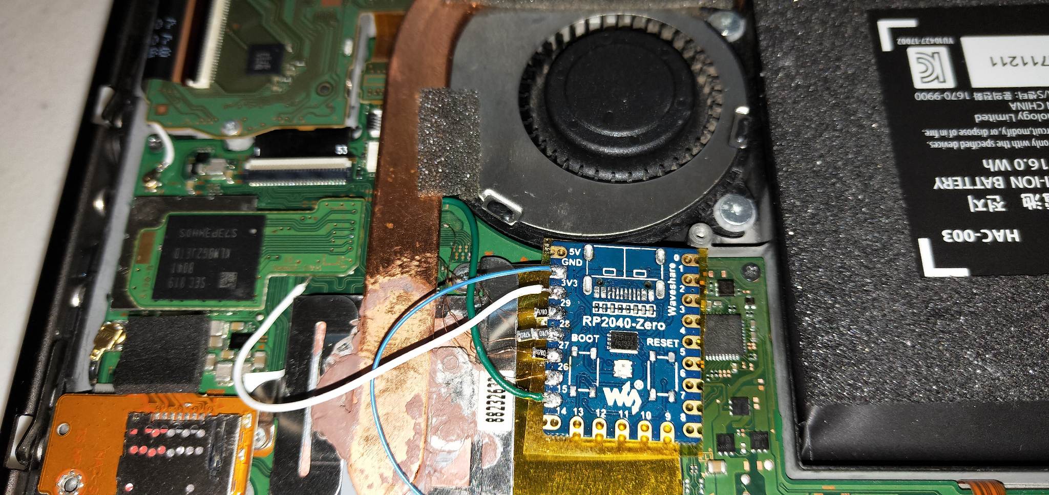

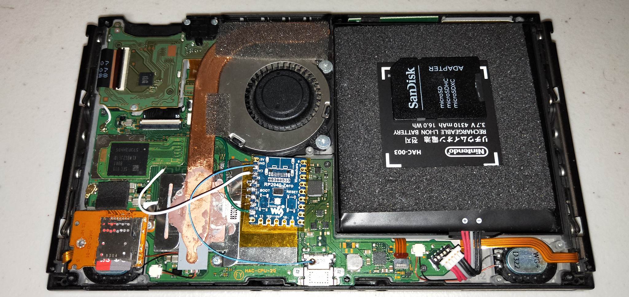

3.3v don't require thick wire. 0.1mm should work fine.
Edit: btw install looks clean. nice

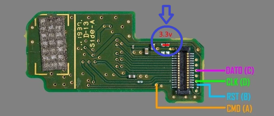

hi, thanks for the replies :)
Thanks :)
the cable need some reroute for tidy and fit to the shield. To my opinion, a little too thick. and the resistor should sit on the pico board so it not touch other things
...hi again, I tried to add resistance to CMD as suggested....
..but still..
...on pico, I was initially using the 2.74 FW and tried to downgrade it to 2.73 thinking it might have an effect on it...same result :(

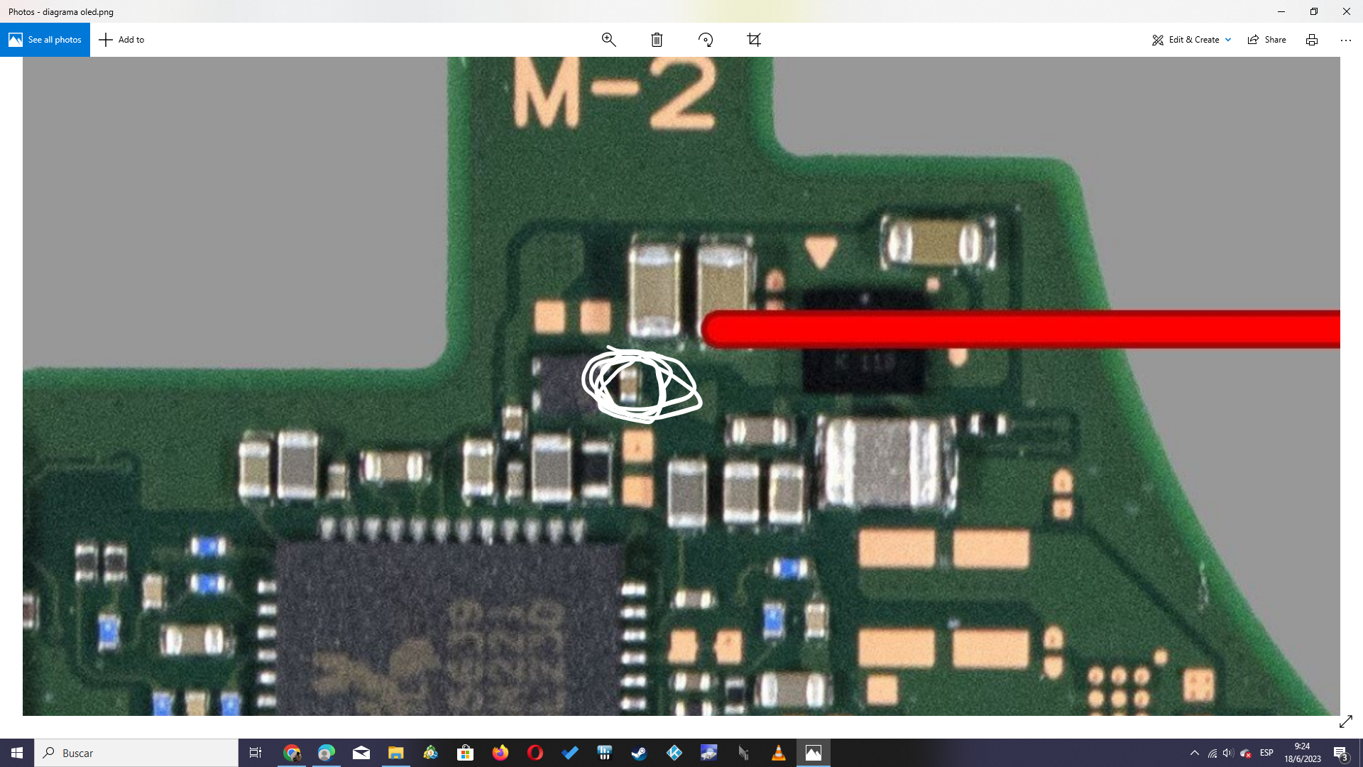

Hello, does anyone know the value of that capacitor? The one inside the white circle
