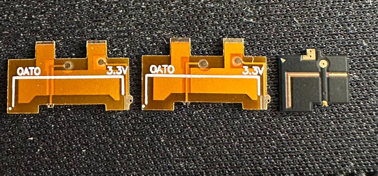

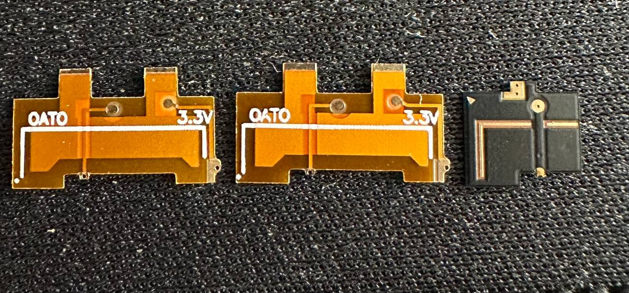

the resistor should be ok now. remove the dat0 cable from pico and lets see what error code you get
I disconnected the dat0 cable and I received a " =* D0 is not connected " error in the picofly.
I'm guessing that I used one of the "bad" dat0 adapters from aliexpress. I have these spare ones but I'm not trusting any of them at all. Any recommendation?
Thank you in advance.
Reactions: Danook28
The first one on the left is very bad, the second one could be used with some modification (see abal100x post about that) and the small black one is OK, you just need to use some solder mask to secure it in place but the contact point under emmc is ok

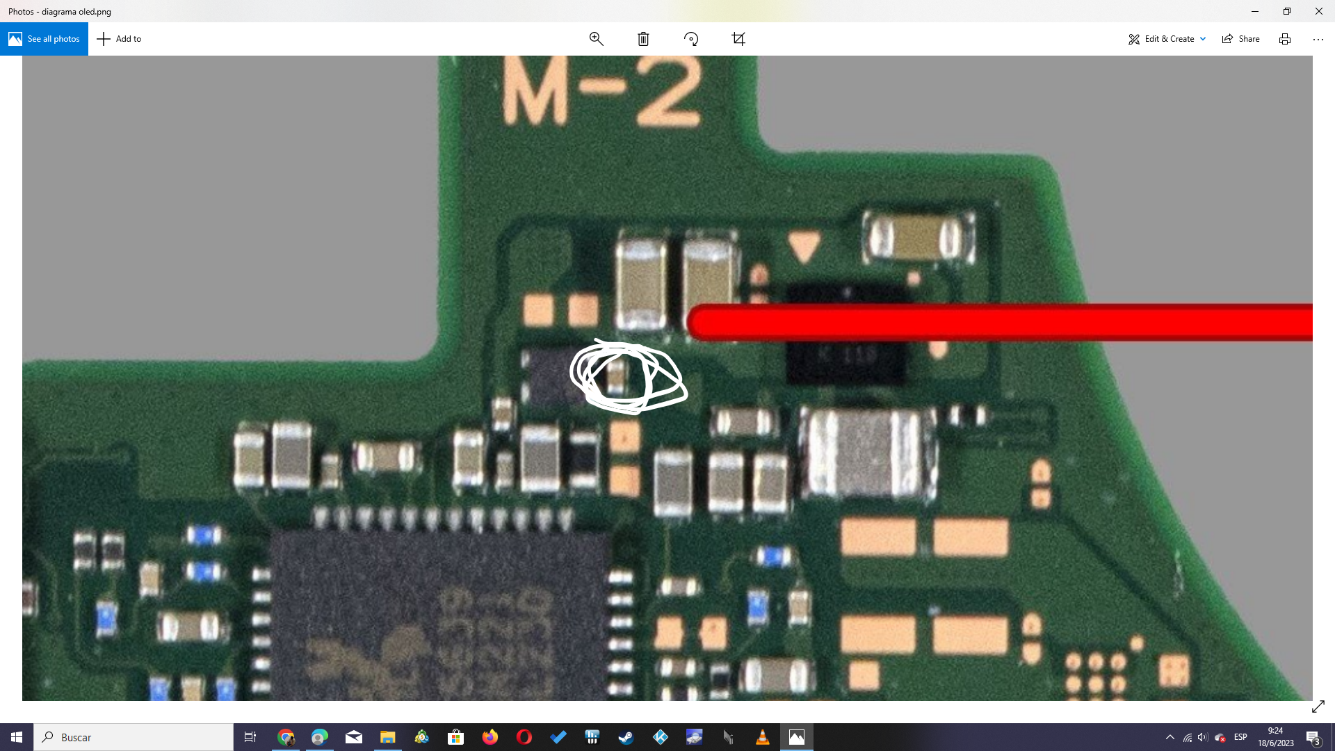

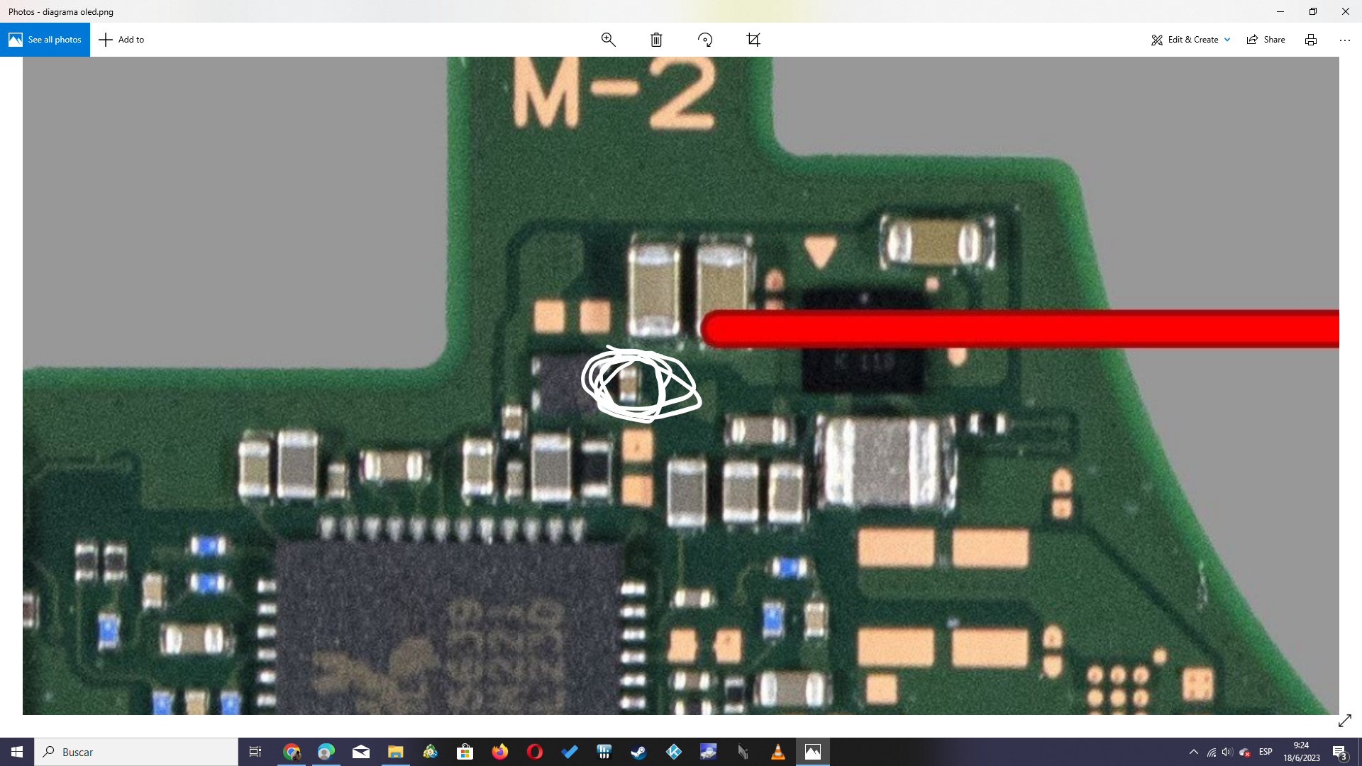

Hello, does anyone know the value of that capacitor? The one inside the white circle
the capacitor inside the white circle, in an oled switch, is gone and the console turns off after a few minutes, does anyone know the value of that component?

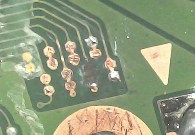

I've got a v2 switch here that I'm fixing for a customer, after a failed install the switch no longer boots, it looks like they toasted the D0 line.
I *think* that via is still ok, but if it isn't is there another point I run a wire from that trace to?

Thanks! So given the state of the pico, like you said it writes the packet with the white flash and the packet should be executed by the CPU when it is undervolted. But in my switch, the signal to undervolt is being sent to the mosfets, but for some reason the undervolt isn't happening. If I'm not wrong, this points to a fault with the flex cable install.
Faulty mosfets? Bad flex cable? Wire to the flex cable poor quality? Is it worth using larger gauge wire or attempting to replace the flex cable with my spare? I'm a little worried about removing caps if I attempt it :D
