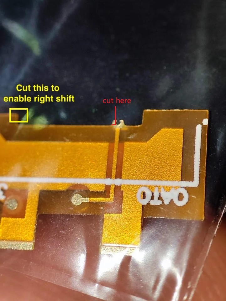

You might do this on your own risk:
Thats already correct to modify the circle point. With that original shape, highly probable it will short circuit the D1.
When you insert it exactly like the guide line, you will get the value, means its connected maybe to d0 only or short d0 and d1. Now shift it little bit right, and check again the diode mode, repeat until you find it zero. That is the edge.
Now you approach it from the edge to the left, slowly until it shows a value. That will be the most probable d0 point without shorting to d1. Do this while you take the power off (battery connector plug off).
And if you're confident, you might try to power it on, to test wether the glitch work or not. And turn it off immediately after it failed (by pressing the power button 20sec or shorting the power pin to gnd for 20sec). Dont forgot to plug off the battery connector, after it.
And if your hunch feels is incorrect, then trust your hunch. Usually experience made our body have a reflex, about something is not right, even thouh our brain cannot find the logical explanation. That what usually happened to me.
Again i warn, this is dangerous only do it on your own risk. I recommend you read the datasheet to understand a gist about it.

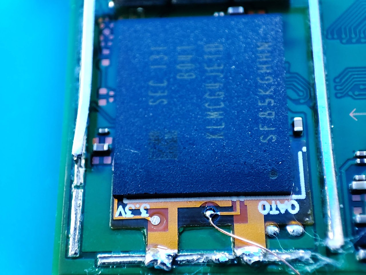

Solid info. The weird thing about this adaptor is the guide line is offset. The cutout shape (that goes around all the BGA pins) forces the lines on the left to go under the EMMC, as you can see here. Cutting where you showed would let me push it even more to the right.
I'll be honest; I don't feel confident shooting in the dark. I'll just try to get an actual emmc adaptor once I've got the screen working again.

I see the horizontal line guide still on outside. Maybe you not insert it to maximum length.
Or maybe its just the picture parallax. You should insert it until it cannot goes anymore.
That's the maximum insertion without really forcing it. I actually think in that install the contact point wasn't going around the BGA because of the Ω shape... these adaptors are so many levels of trash.

How about cutting on the red line? So he won't need to find the new position, and if the connection has no problem, maybe the big fat right side stuck between dat0 and NC pin will make the contact more stable.
