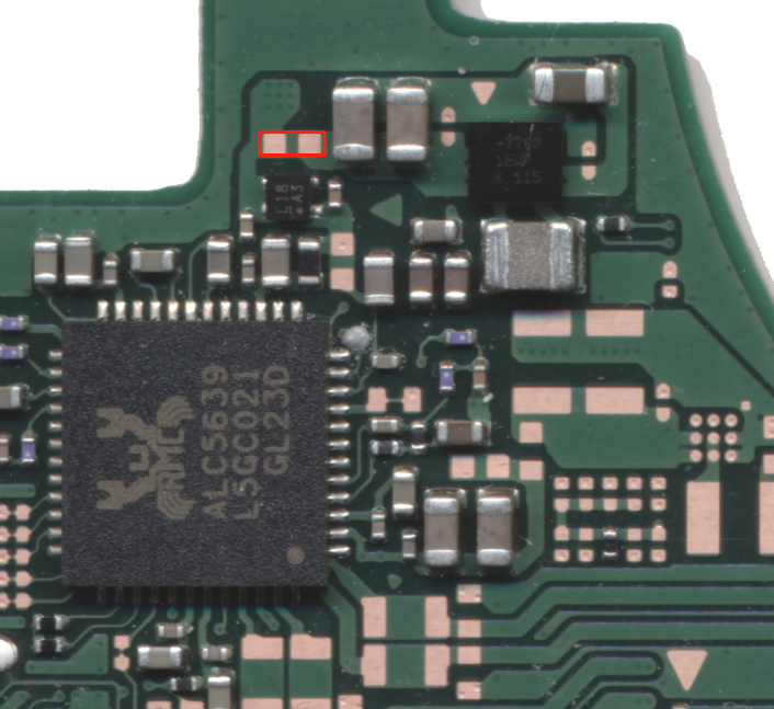

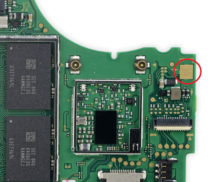

Is there an alternative pad for 3.3v on oled board? Just don't like to solder on components.

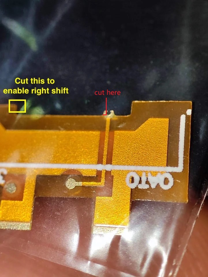

How about cutting on the red line? So he won't need to find the new position, and if the connection has no problem, maybe the big fat right side stuck between dat0 and NC pin will make the contact more stable. View attachment 378867
I have the crappy OAT0 adapter, tried cutting the red area first, still get 0.720 V and the error. I cut the left as well and a little of the other corner to move it more right and I still get 0.72v and the error. At least the switch boots into stock HOS still. I guess I will wait for a new adapter, is there a link to better ones?

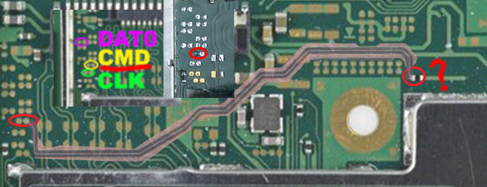

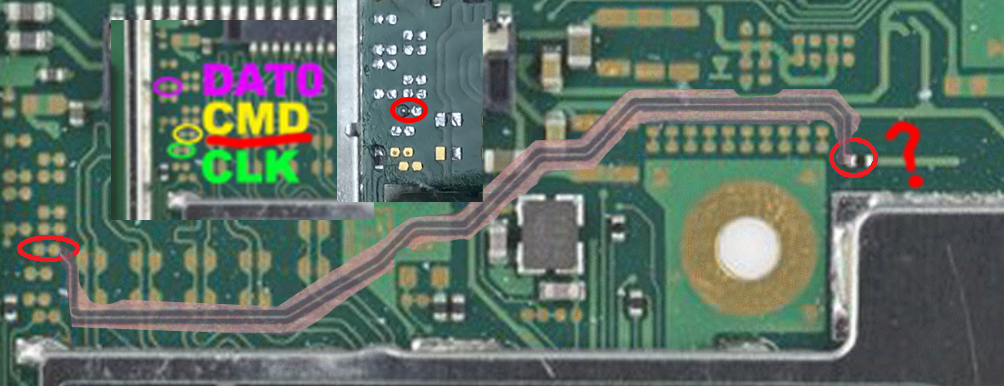

Have you ever used this other point for cmd though in the included picture? I used the pcb scan to follow the trace backwards (or forwards, lol) . Do you think it would be suitable? I superimposed the picture of the trace so the path could be clearer.

Have you ever used this other point for cmd though in the included picture? I used the pcb scan to follow the trace backwards (or forwards, lol) . Do you think it would be suitable? I superimposed the picture of the trace so the path could be clearer.View attachment 378911
You need to make the ripped LEFT pad connecting back to the right pad, no point to make a long wire to the resistor and RIGHT pad not damage so resistor to the RIGHT pad is in good condition.

As I mentioned in my other posts earlier in the thread, I already fixed that but I didn’t get pictures of the repair. What I’m referring to is using the far alternate point so I won’t disturb the bridge I made. Or worse, rip the pad that’s left.
Warning.... dont use that alter cmd point.. its very very easy to ripped out and result to purple screen .. not worth the headache.
Just use normal point.. its easy with enough cleareance.

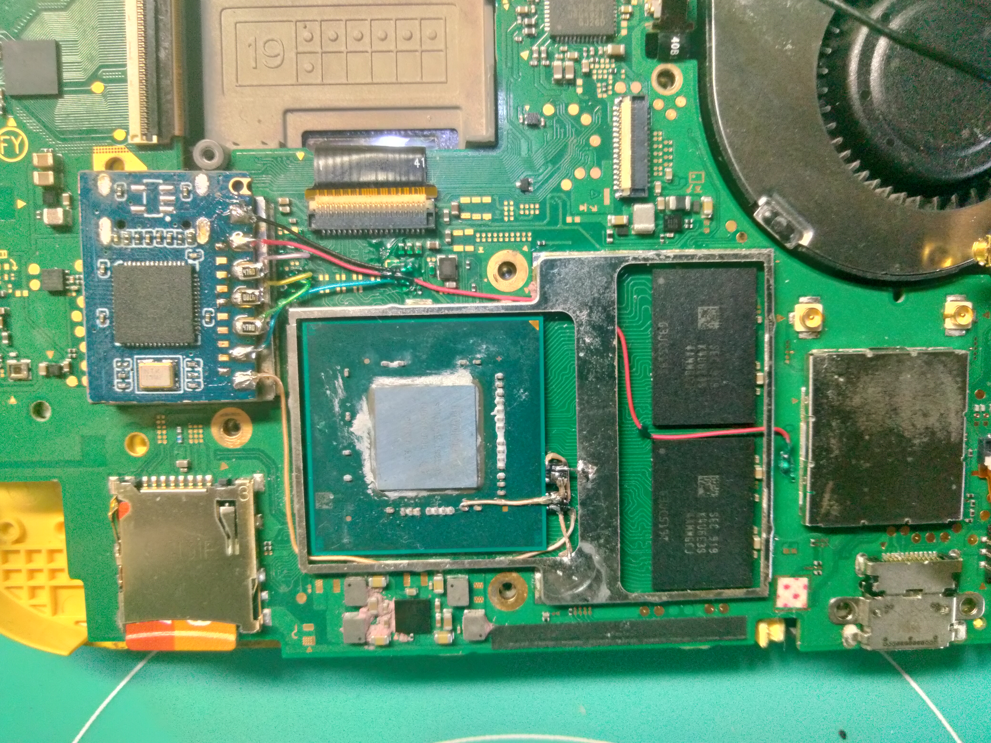

Also if you install pico on top of ram module you can use this big fellow ground point (tested).
I see, A broken resistor is easy repair compared to a ripped pad. YMMV
