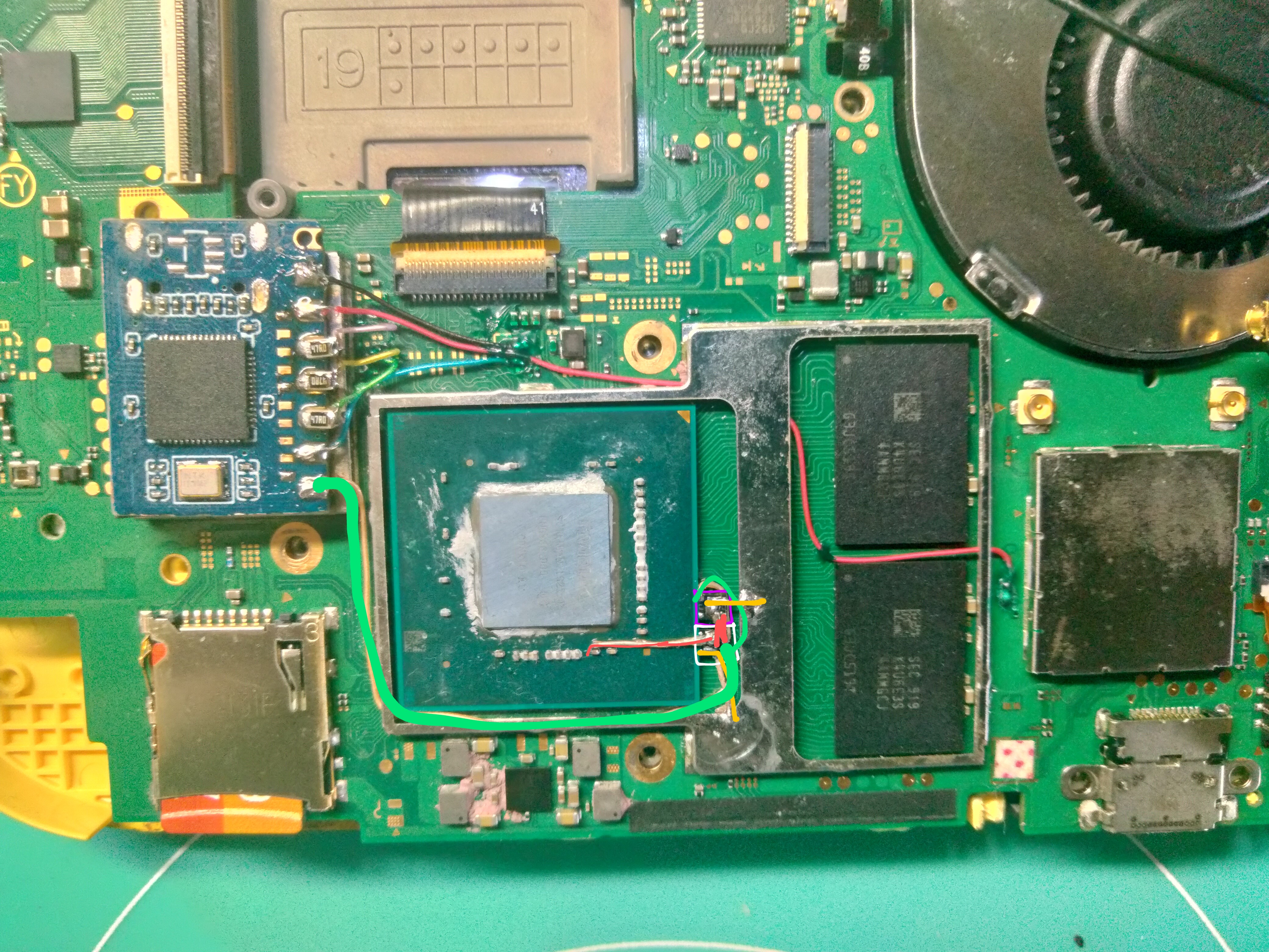

I've done 5 picofly installs by now, but my personal oled switch is having some issues. It's turning off by itself after going to sleep (emummc). What could be causing this? Is this caused by the RST point?
Edit: Actually, it also does this outside of sleep mode. It's almost as if the power button is being held down. Sometimes it does this, but sometimes not. When it does, the switch freezes, the screen fades to black and then the switch turns off. Same thing happens in OFW. Doesn't seem to happen in hekate.
A few pictures of the installation are attached to this post.
Yeah, the cmd wire does a little turn because I soldered it the wrong way.

im a bit curious can you corrupt nand from shorting the emmc dat0 or other cause? i have one OLED that seems have that case, after instal pico cannot boot OFW, can enter hekate with no sd screen etc but when you try make emunand emmc cannot read,
sysnand cfw also wont launch

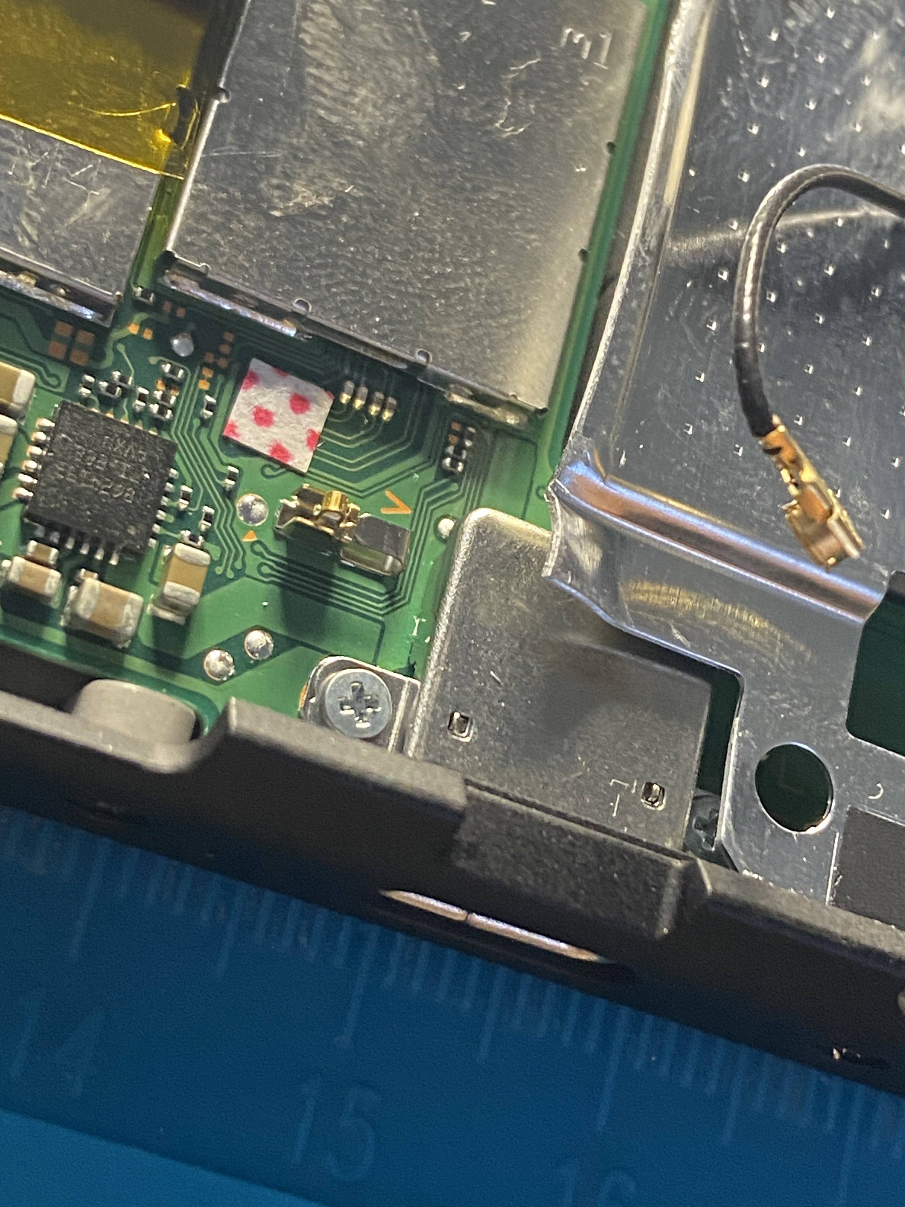

I successfully modified an OLED, yet I spent an entire day trying to figure out why it won't turn on as soon as the outer shield touches it. After a frustrating trial and error, when I bent up the shield that was touching the USB port, it worked.
Share your thoughts, This was one hell of an OLED.
The pico is not touching the shield in anyway, it was cut.

Hello.
Bsod ussualy comes from short with ground.
You can test while bsod just plug the charger and feel anywhere heated? or its just charge dont work?
Posibble solution.
1. Try replacing any enameled wires used in the mod, it can be from that (invisible issue).
