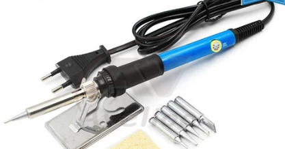

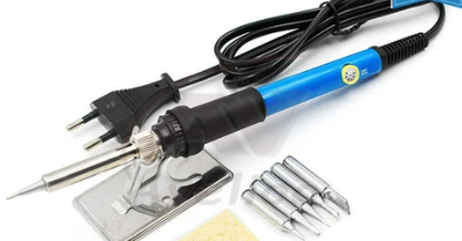

Is it possible that these resistor broken cause by a bad solder device. I've meet with some cheap solder device which have a huge leak electricity. Sometimes its electrocute me little bit if i don't use shoe.
Is there any recomendation from anyone here on what brand/model of solder tools that doesnt have this elec leak. Both solder tools only also solder station.. best if its under $50.
As i have now this cheap ($5) one with a little leak, only if im aware that i can feel it.
Luckily no issue yet until now.
Reactions: Makc16384
Lol, I have this cheap iron too:rofl:
For the tiniest resistor 1/20W it could flow 15mA so its totally safe.
If theres leak electricity on some bad solder device, could it possible to destroy those resistor when soldering it?
I'm not an expert in this particular area, but resistors are generally very robust. That 1/20W rating is the rating it can take all day long and at rated temps (like 70C). I'm sure it could briefly dissipate much higher power surges for a short period of time. It would seem to me that other components in the circuit like the APU and the flash would be much more sensitive to a crappy non-ESD safe soldering iron. The transistors in the APU are fabbed from a 40 nm process - much smaller and more sensitive!
