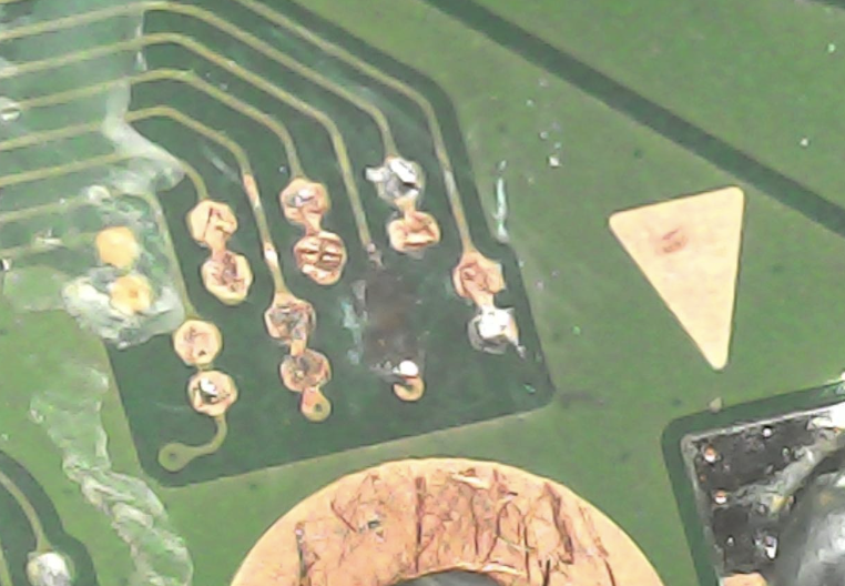

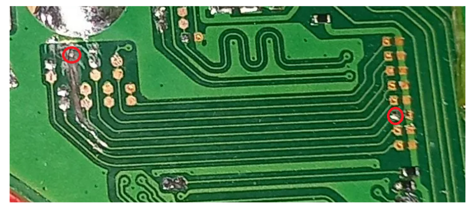

I've got a v2 switch here that I'm fixing for a customer, after a failed install the switch no longer boots, it looks like they toasted the D0 line.
I *think* that via is still ok, but if it isn't is there another point I run a wire from that trace to?
Hi jump here to here.. it should boot if thats the only issue.
Safe way about rip pad you must use solder paste little bit and heat from 200 to 250 c 300 350 c. Soldring mask. Microscope. Very thin iron tip. Dont press to much on pad teak your time. The wiers must be same size to pads no more short or long time heat. Very good flux and use magnate copper wier 0.2 mm cmd clk rst dat0 /and 30 gw wires 3v3 GND. You can see in pic the size for good soldring tip.

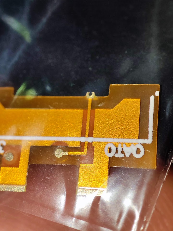

What emmc do you have on your switches? I have a samsung on mine, so if yours is also samsung with 600 it would I do indeed have an issue with the dat0. I honestly wouldn't be surprised since I had to use a OATO dat0 adaptor. Ordered 2 from two different suppliers who said it was the good quality one and they send me crap. Many people here have made the OATO work, though. I guess I should order again and try get the quality DAT0 adaptor to test the theroy. I've actually trimmed back the 'claw' that contacts the dat0 pin to try prevent shorting too since the shape is more like Ω than U (closed at the end).
