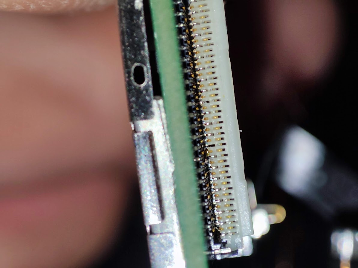

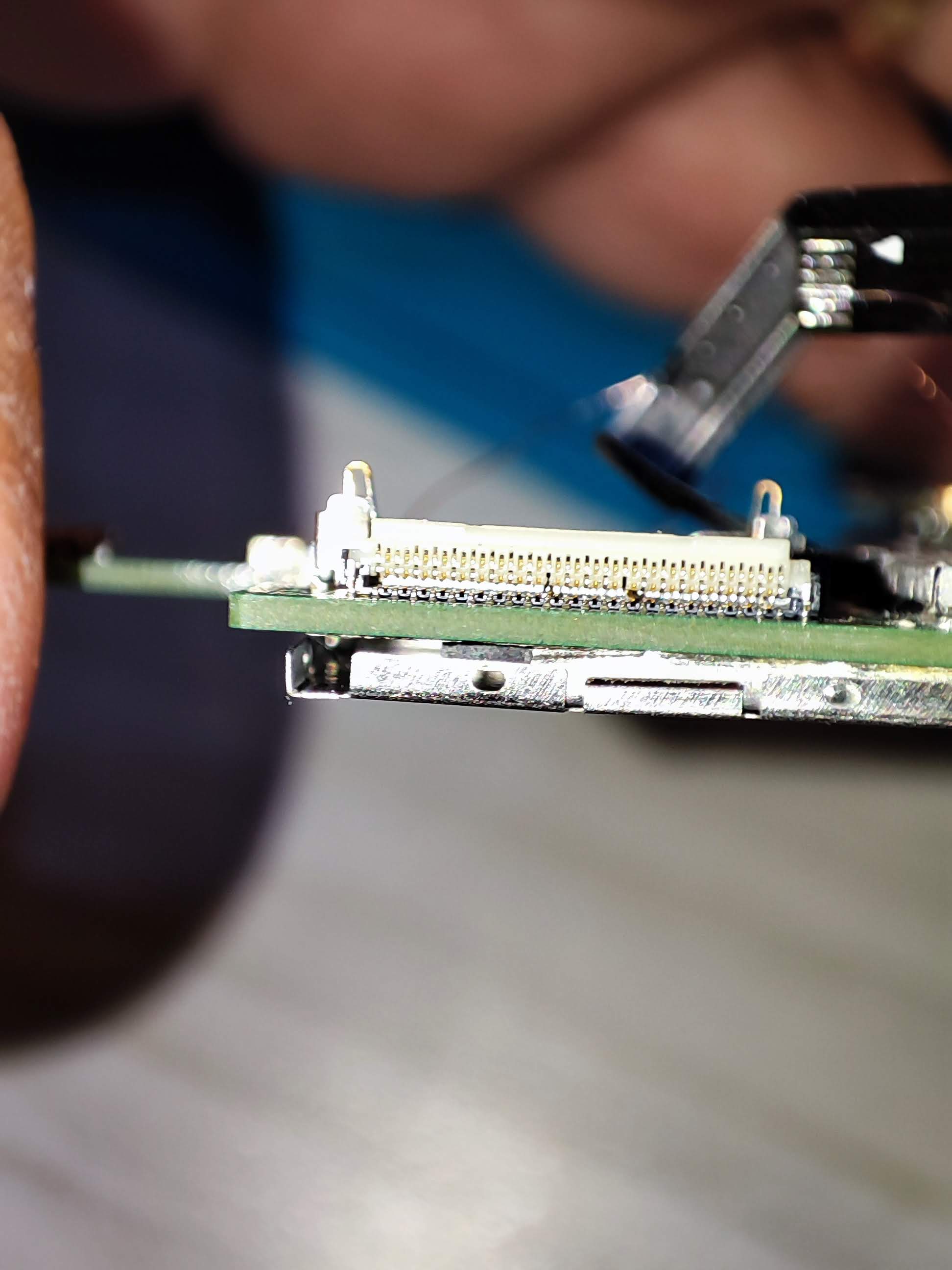

Well, I have good and bad news.
Good news: the flex cable wasn't attached correctly. I resoldered and fixed it. Now it works. The CMD caps were actually good. I was a dumbass and didn't set the correct range on my multimeter. They were actually okay and showed the correct range (4.7k and 47k).
Now for the bad news. Firstly I think the black screen is because I screwed up the display cable port. I must have used the wrong angle when trying to push it in after the install and now it looks like the image below. I can also see markings on the display flex cable, so I think two pins are bent. THIS is what is causing the black screen.
Next, I decided to reassemble and power on without the display to test the mod anyway. The chip still doesn't function as expected. It blinks blue for a loooong time, then there's a white flash and it continues to blink blue for about a minute. After that it shows === (glitch limit reached?). It could also be *** but I have no comparison on long/short flash.
I'm guessing I 100% need to replace the oled connector now. But as for the glitch, is it caused by no display, or is there something else since I do get a white flash before it keeps trying.
The one reson that lcd conector damge is start remove lcd Flex from up by slide it to back and up... The good safe remove is from charge port and up the conector tap to up before you start from charge... That good way no more damge lcd conector... That happend to my v1 first damge console conector pin inside....

I know the issue with the connector. When I was trying to put the cable back, it's actually slightly offset so the cable is 1 pin lower than the connector. It caused it to arch up and at the peak it caught a couple of the high pins, pulling them down. Now when I insert it, the high pins go under the cable which is no good. I've ordered replacements, but I have no idea how I can replace it with only a propane heat gun. I need a fancy temp control heat gun and they're damn expensive :/

Neither would I :D I'm sure I'd melt the new connector, semi-reflow the emmc under the board, and blow a bunch of SMD components to the 8th dimension!
I'm actually in Indonesia, so Amazon isn't on the cards, but locally, we do have options. I just don't want to drop money on a heat station when this is the only thing I'll probably use it for. I'm asking some local repair places how much they'd charge for a OLED connector replacement.

Ur gonna have to heat it from the bottom anyway cause u don't wonna gibt them connectors heat , if it was me personally. When I had to replace it I would remove the emmc and then heat it up from the bottom so I won't damage the emmc.
There probably gonna charge a good amount , in Germany they would charge 60 bucks, but hopefully u get it done cheaper

You could try to use this trick to remove the old one (it's damaged anyway so nothing to lose)
And then you can solder the new one pin-by-pin using a 0.1mm solder tip like here

Labor is much cheaper here, I'd expect somewhere in the region of $10-$20. Reballing the EMMC. Oh man. That's something I really want to avoid.
Ah! I've seen that video. Thanks for reminding me, I can totally try that out and see if I get any luck. The last thing I want is to rip any of the pads... Sad that sthetix didn't explain how he removed it with an iron only. I had enough trouble removing the switches from the picofly with an iron only D:
