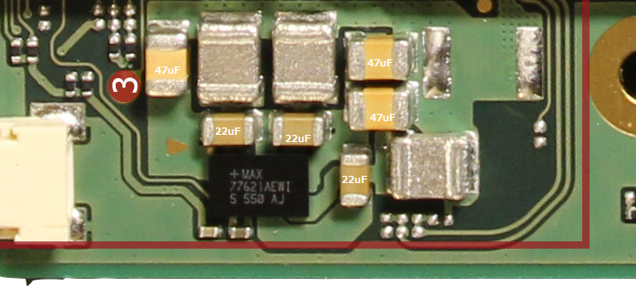

The two cap conect to same point ground and the other side. And that two point is same to the capacitor points????

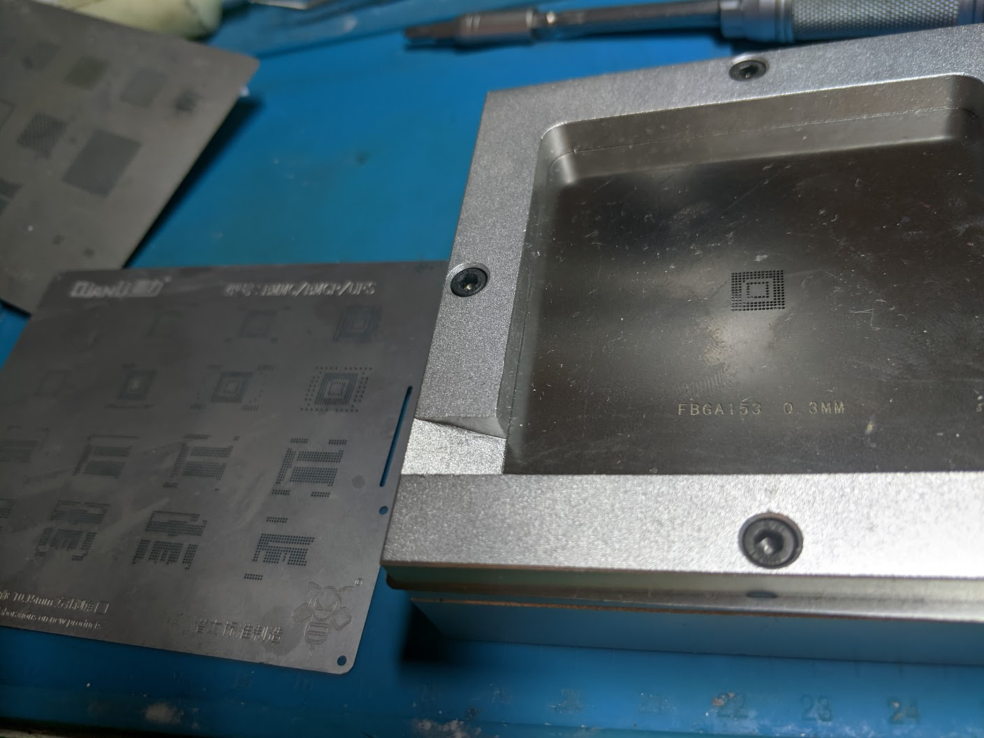

@karatefeet made a request for links to 'what I use for reballing', figured I'd share with the class...
I just bought the magnetic base, positioning plate and BGA153 stencil from this link:
https://a.aliexpress.com/_mO67mrS
1st time using a mag base and fixture, gotta say, im never going back
You would find solder ball makes life easier when your bga chip size go larger.
I have both for emmc reball. Not much difference in this case but only takes me extra effort putting back remaining balls when I am cheap and don't wanna waste any single one of them. :rofl:
I’ve ordered one of these as well. Between this and the magnetic stencil jig ordered yesterday, one of them has to work!

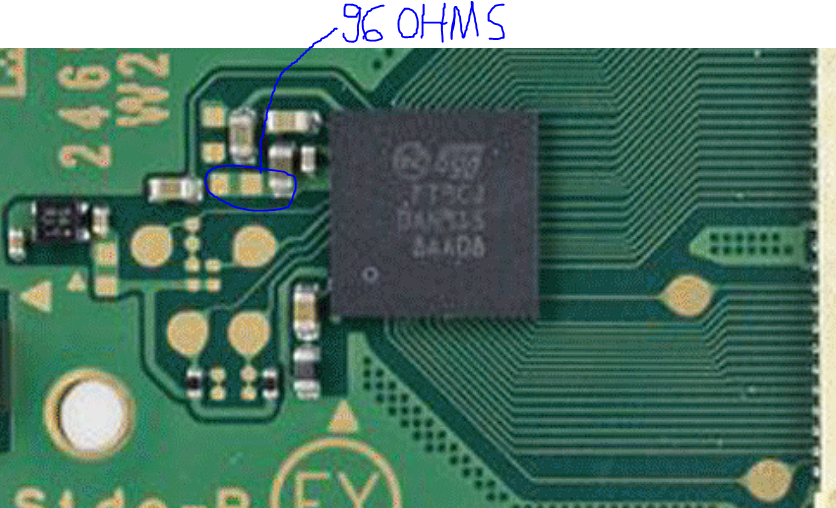

I thought the problem was the micro sd slot. But it looks like it has a short when I tighten those screws near the ZR button. There is some short, it happens in this region. As you can see in the photo, this line has very low resistance, next to the ft9cj touch chip. Whenever I tighten the screw the micro sd does not work. And Hakete doesn't get up.
  • 20230614_192837.mp4
    12.7 MB
@QuiTim, @abal1000x , @Dee87,
, Thanks for all the help so far.
I believe I managed to restore dat0. the reading on the multimeter is 655. and also the alternate point shows the same measurement. it seems good?
Unfortunately the switch didn't turn on... any tips on what to do? maybe reinstall picofly and try a hekate to recover via backup?
Reactions: QuiTim
Yes
