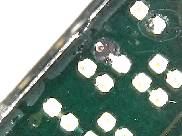

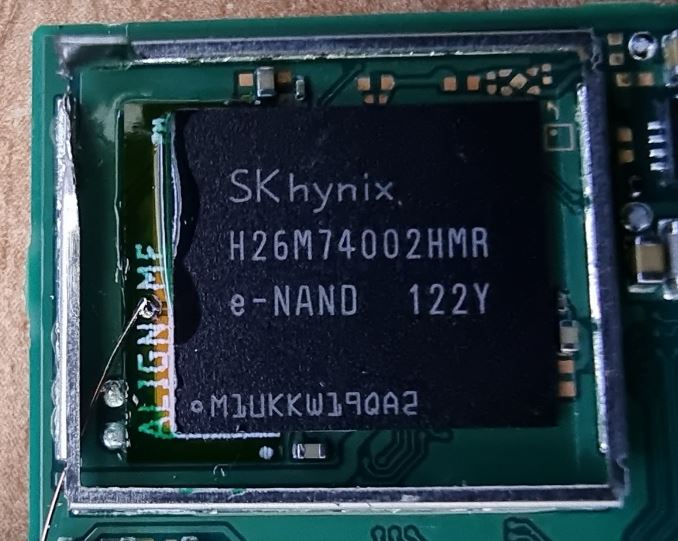

Well, this is my preliminary investigation results: a dat0 ripoff. @abal1000x @QuiTim
@Dee87
Well, my switch lite worked for four days after a "successful" pico install, full hekate's nand backup and etc.
In two different episodes I was some OS freezing... In the last freeze, I forced a power off, and since, black screen and the Led code was "*=* No eMMC block 0 read error" I checked that the wires had continuity, there was no grounding. So I removed the chip, the wires and now under the microscope I noticed that my dat0 was ripped out. I don't know if this happened during chip removal, after the black screen or if it was already like that. Could this be related to my black screen?
Thx for the help.
Well, this is good news, in a way :)

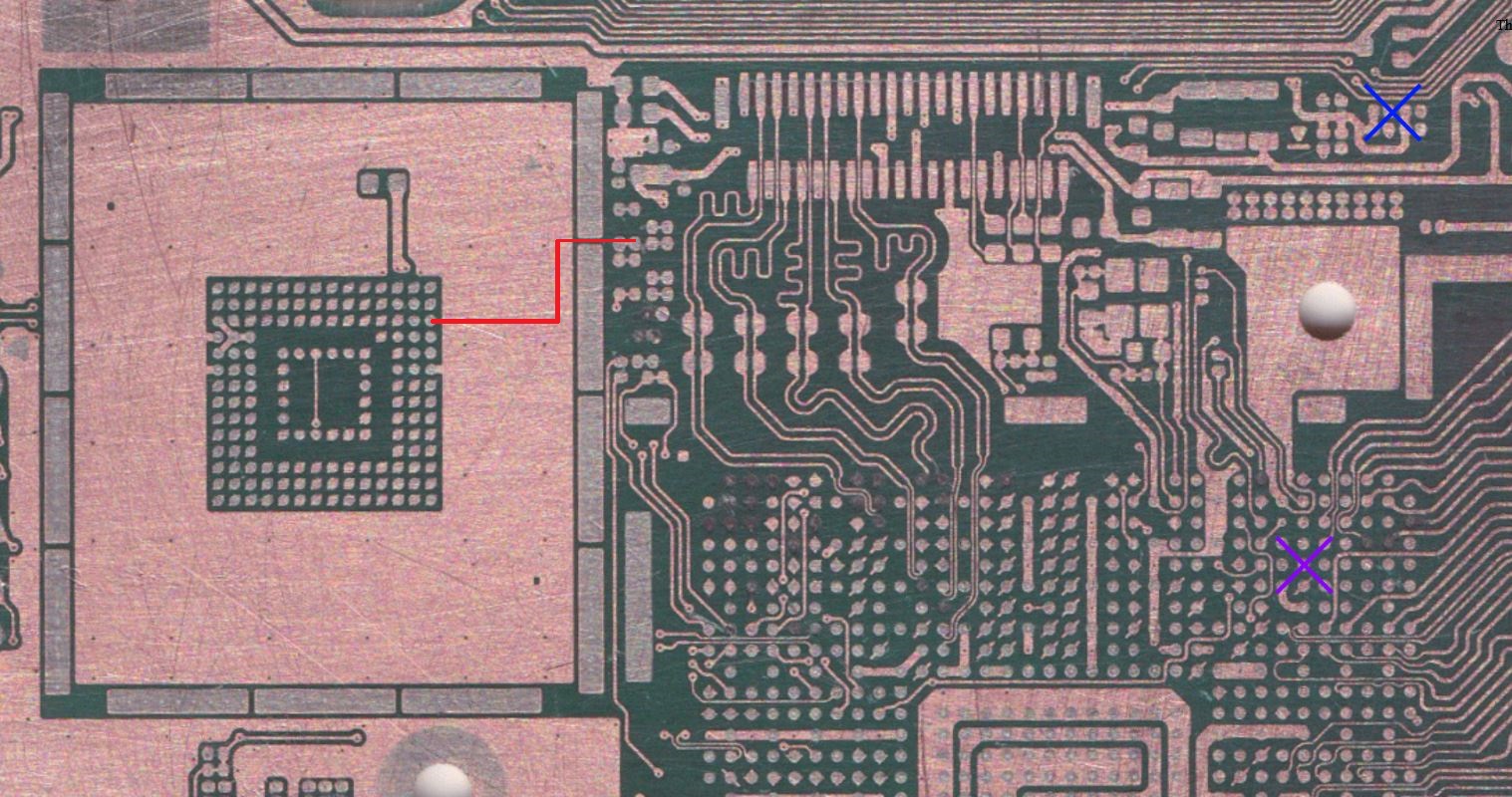

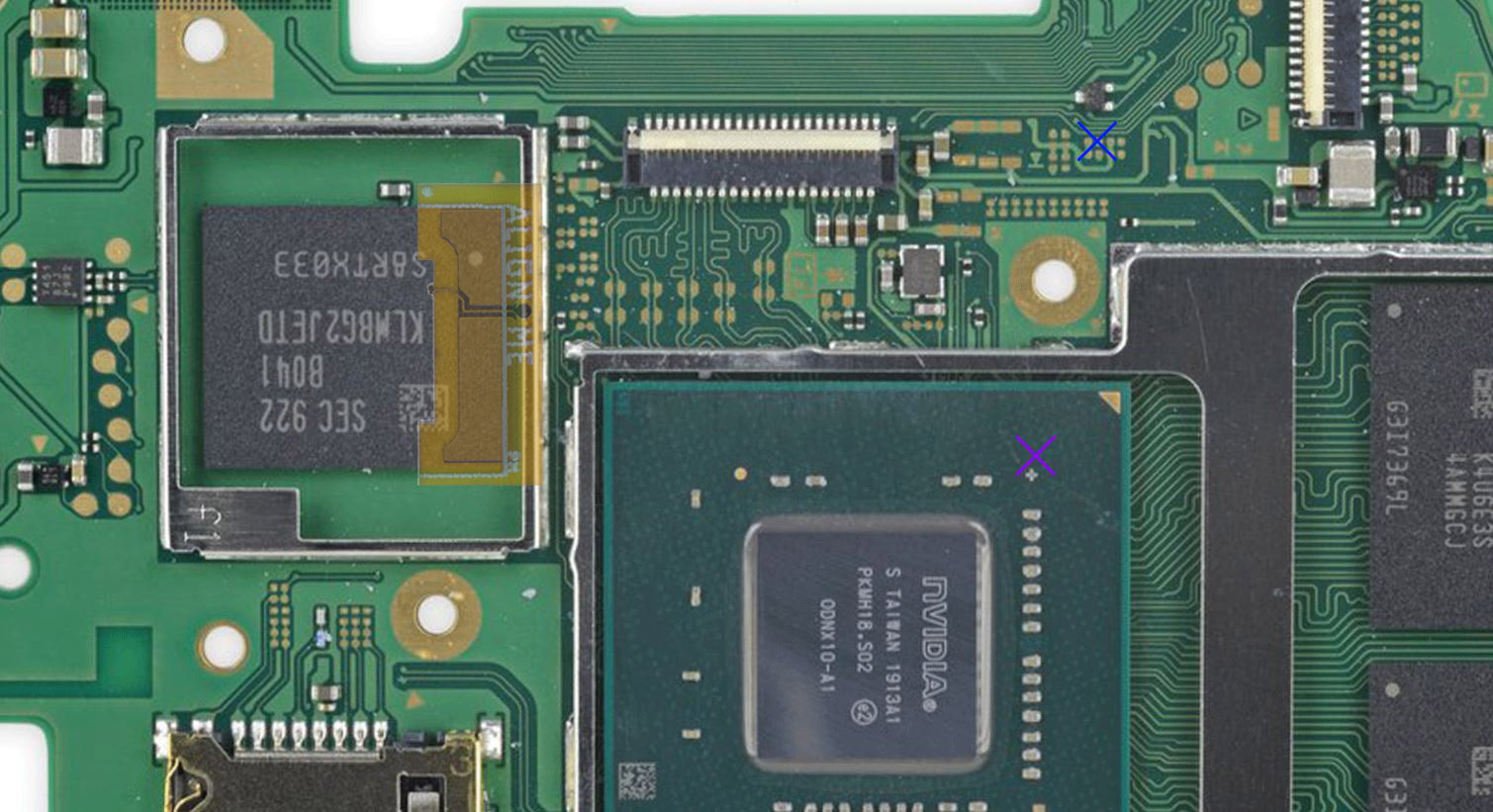

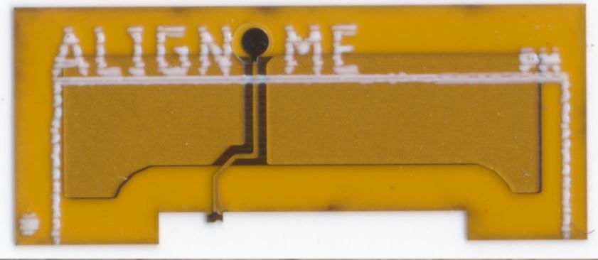

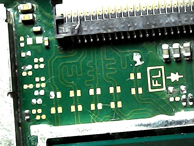

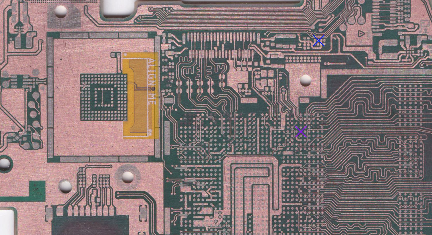

I would try a couple of things here to fix that trace.
1. Easy - Cover the surrounding points with kapton/solder mask and put a blob of solder there in hope that it will create a short between the 2 points (use good flux and sn/pb solder)
2. Medium - use this specific dat0 adapter (as in Oled) as it has no anchor points and then create a bridge from dat0 to one of the points where it need to be (check picture "a5" the blue X on top right)
3. Hard - use a 0.02 jump wire to try to fix the broken trace between two points.
Picture legend:
a1=dat0 in place in oled to give you an idea of size;
a2=dat0 that im talking about;
a3=how it should be placed;
a4=whats going on beneath;
a5=Lite board traces
This is pretty much what @abal1000x is saying but with pictures :D
Picture legend:
Point #3 - Haha - yep - I ended up with ripped pads when trying to figure out why my first lite install didn't work (solder, remove, re-solder etc)... except in my case it was both pads - so I had to dig down a layer to get to the copper below for both pads and re-join them :unsure:
It worked - but not at fun thing to have to do.

On the pic, a3 is a Switch Lite model, that i know, no need a DAT0 adaptator on switch lite...
you are right but we have a specific situation here. the dat0 on pcb has been damaged and we are going through ideas on how to fix it. read the posts above that one and you'll get the full picture

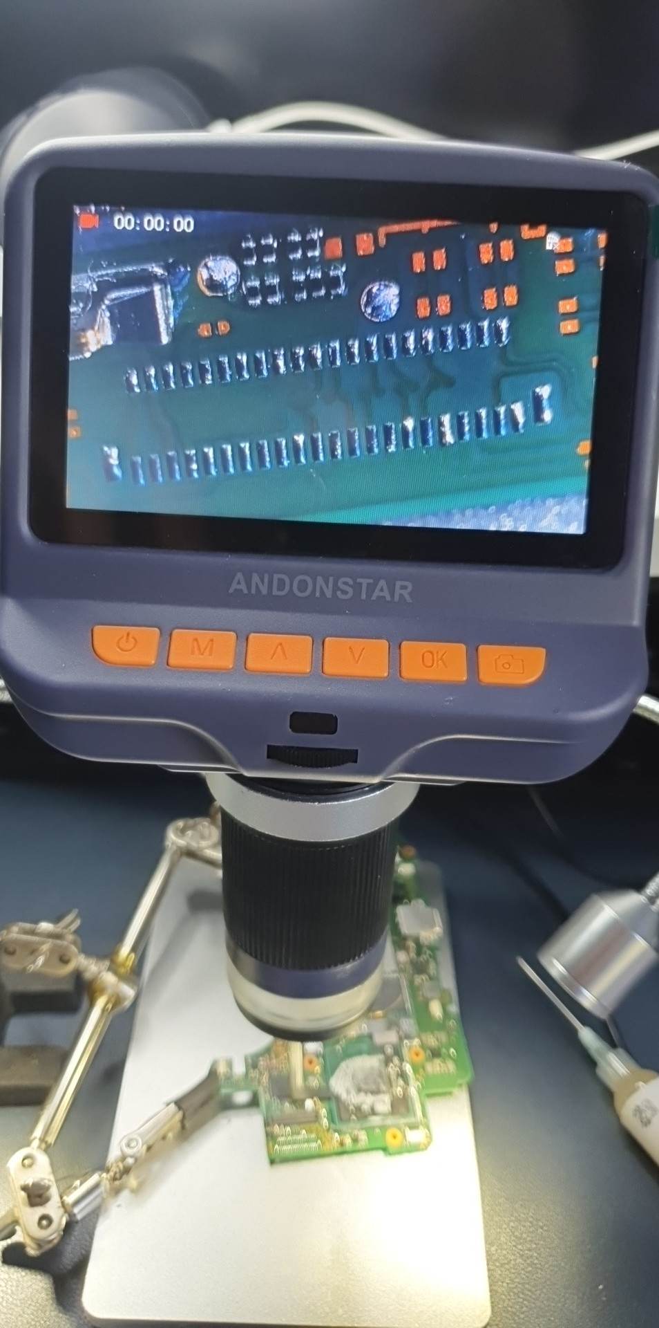

I've just been given this to do... this should be fun! 😅
