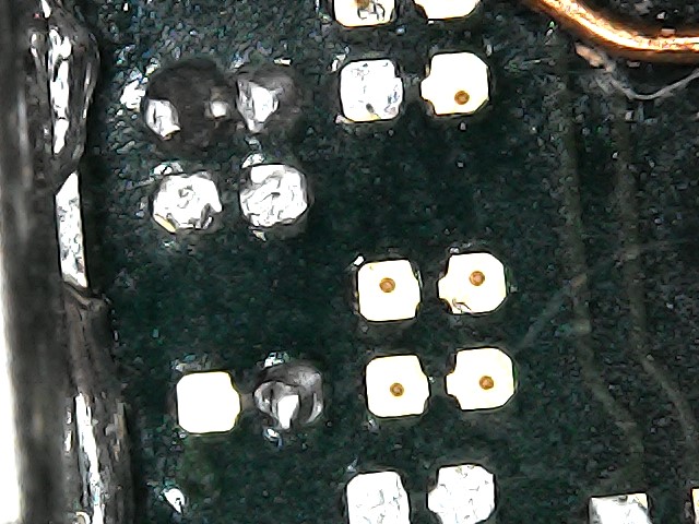

Yup, without Dat0 wires connected to pico it should boot straight to ofw, so the problem lies somewhere else or move to somewhere else (emmc corrupt?).
Just try to desolder everything from pico and hope it will boot normally.
Yup, that will result in black screen.
If Cmd ripped out it will result purple screen.
For fix : use the thinnest wire you can found (0.01 is prefered), non enameled, Pre tin it, and make a tin blob on the solder tip, use as much flux you like, then start soldering.. only one second solder touch is needed.. you can know its conected if you cannot pull the wire.
First target is to solder the wire on to broken pads.. after that done, solder the other end of wire to good pad.
If the switch can boot, you can continue the mod using alternate dat0 point.
I will recommend on curing the pad after fix it with uv mask, so, no way that will be damage again i think (if i'm incorrect, you can say it without fear ;))

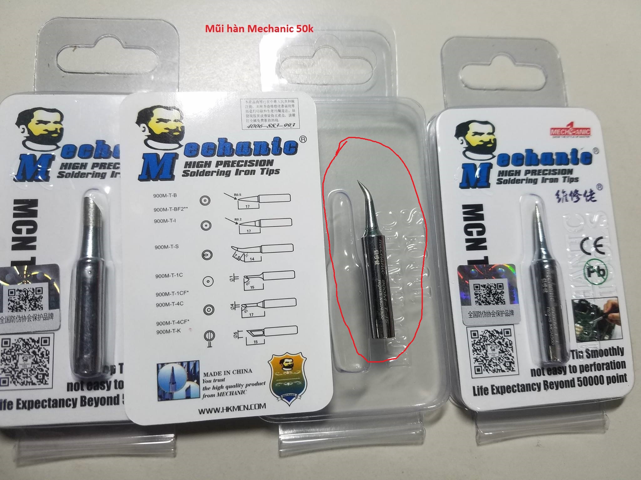

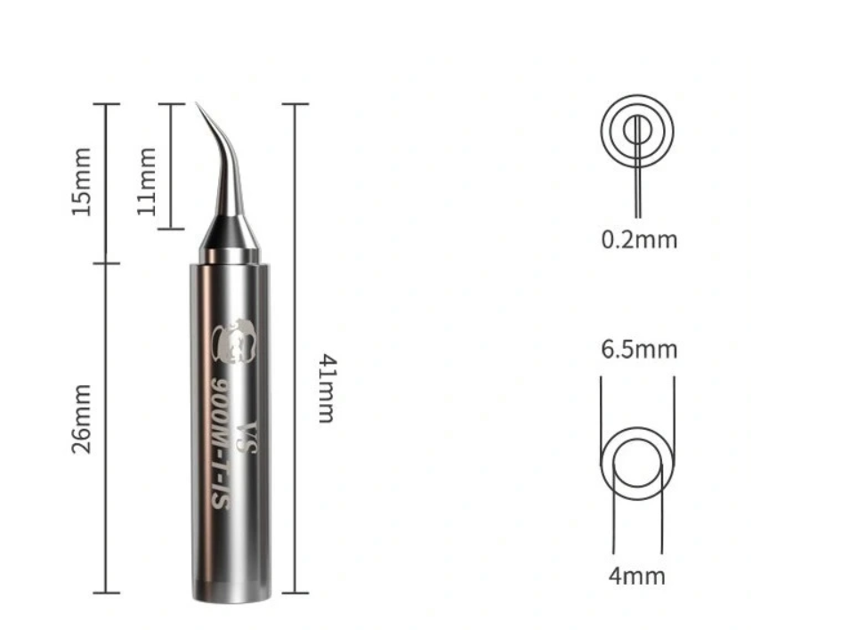

Hi everyone, I would like to buy a new tip for modding in future. After struggling with my too big solder tip, I found this one
Is it suitable for this kind of modding? Or have any better replacement? Im in Asia so shopee or aliexpress is a prefer. Thank you.
Why don't the two of you order some and let us know how they work?

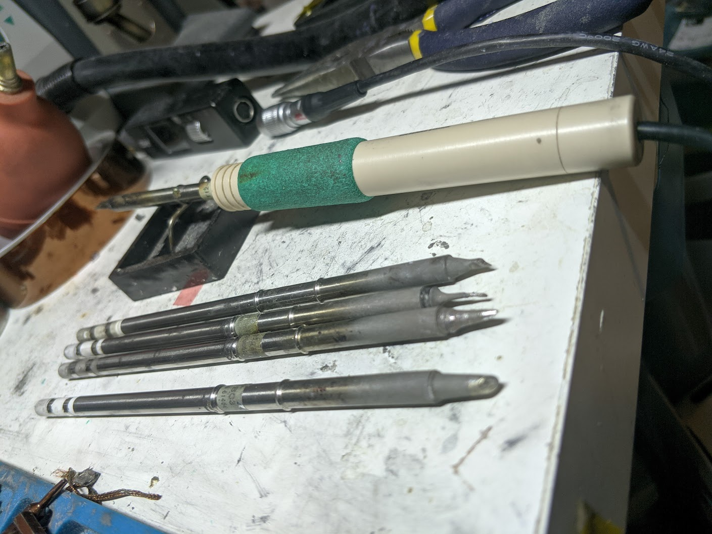

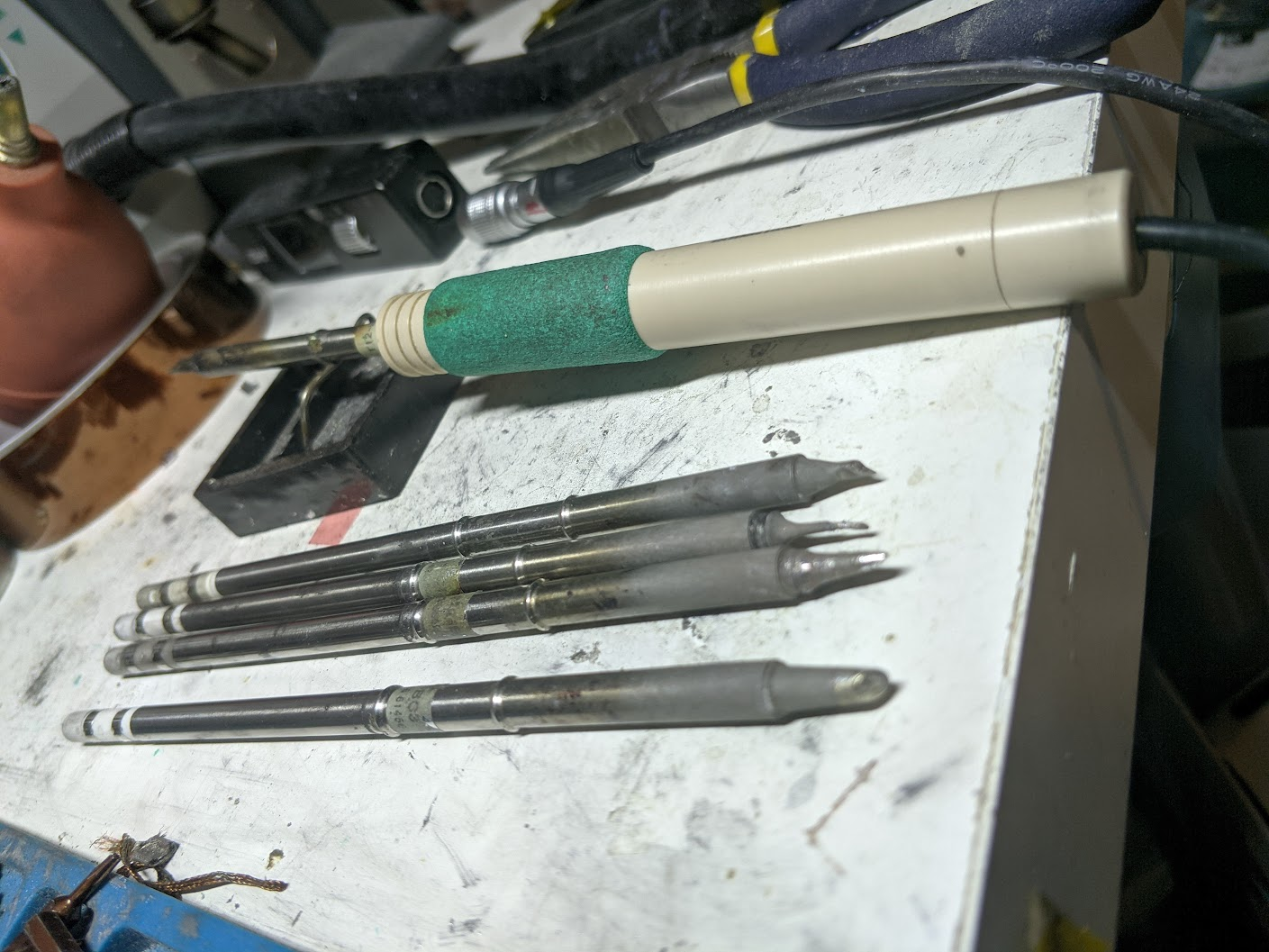

I have been using t12 iron for so long that far away behind modern fancy JBC stuff.
something like this
I have C1 shape for mostly jumper wire or pad repair and often time just bc1.5/bc2 for all other SMD work. When removing or pretinning pads, use bigger one like C4 or blade type tip.
something like this
the C1 tip makes sense such as solder between 2 components, thats also why i want some smaller tip

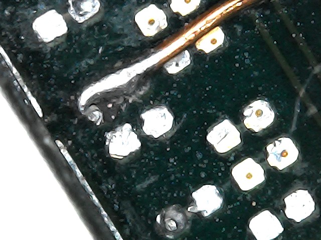

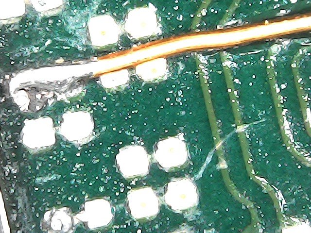

Well, I made some progress, I believe I achieved a positive result. What about?
WIN_20230614_00_54_22_Pro.jpg WIN_20230614_01_49_07_Pro.jpgWIN_20230614_01_46_58_Pro.jpg
The multimeter measurements for the post-repaired Dat0 point (diode mode) is 0.655, is that good? I really don't know what the default readings for switch lite are.
I had a spark of hope that soon dissipated, the switch lite didn't turn on. Any tips on how to proceed?
View attachment 377799 View attachment 377800View attachment 377801
I would cut the wire a bit more so u only have the uncoated area on the pads and not almost touching the pad next to it

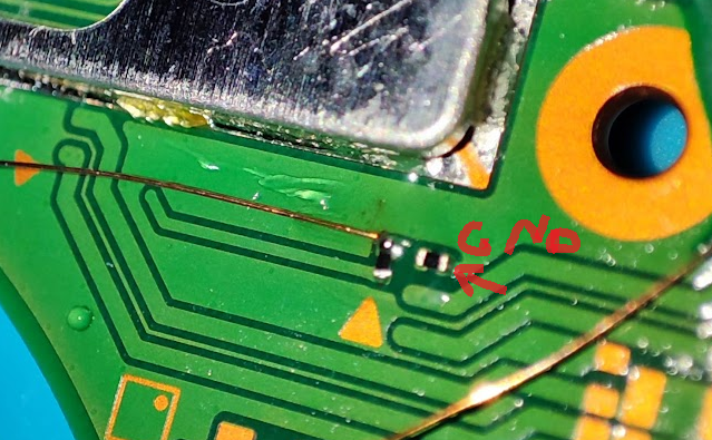

So I did some research. These resistors on an OLED CMD should show 4.7k and 47 ohms right? Mine showed no value when tested and in diode they show 350 one way, 750 the other. This means they've blown? (I have a black screen when booting).
If so what size are the resistors so I can order new ones and can a faulty CPU flex cable install cause them to blow? I still need to work out what happened.
