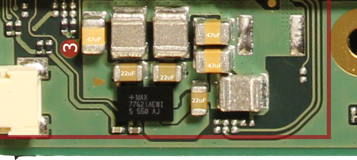

Hello every body.. Any one tell me the value to this 2 capacitor and the two point that i drow line on both thank you god bless you ❤️
