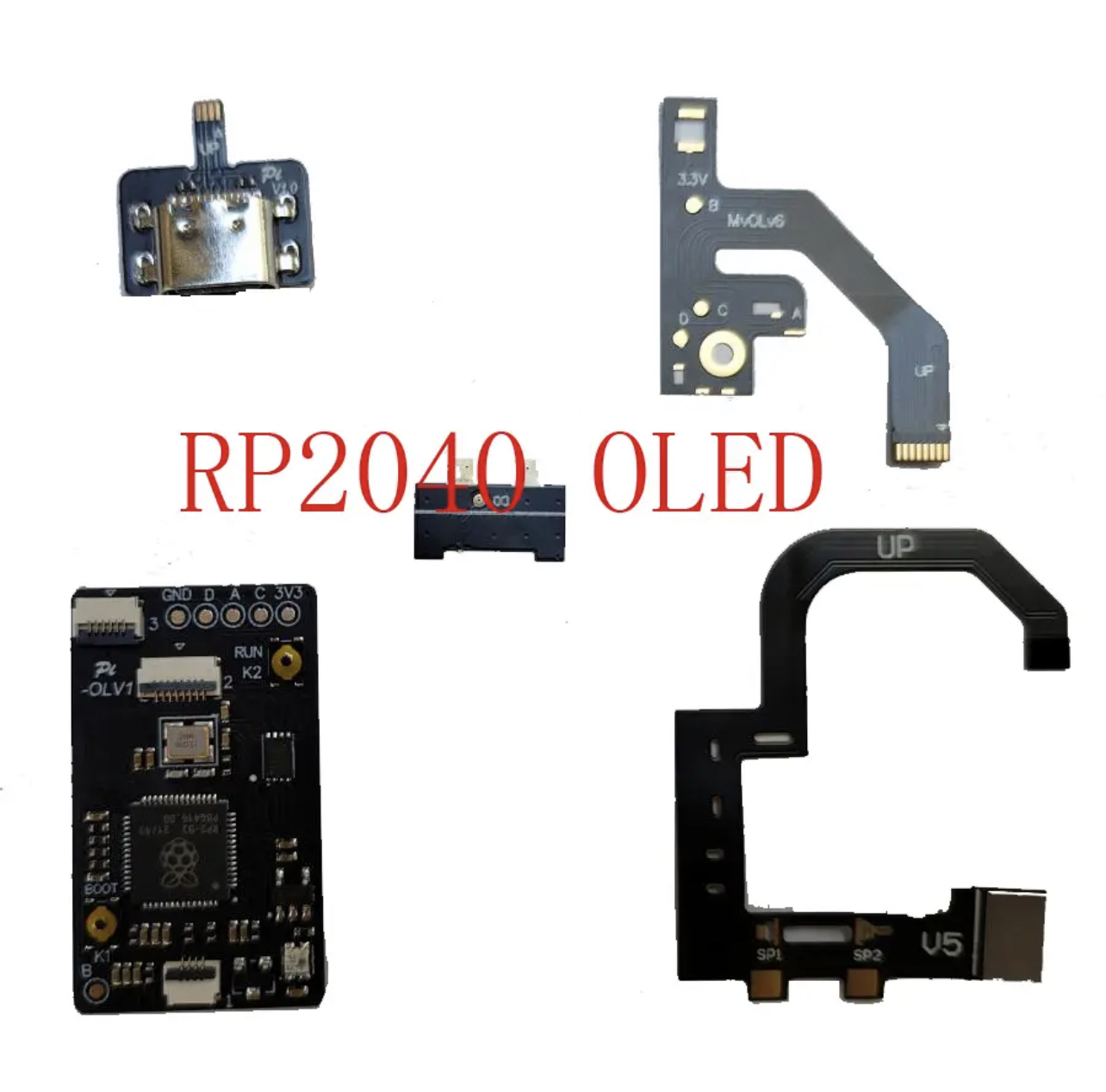

Anybody tried this? Seems to have replaced Instinct chips. Claims to be RP2040 based.

Hey guys, does anybody has desoldered EMMC BGA153 and crappy OLED DAT0 cable?
Can we just flip over this EMMC chip and put this cable above to see if DAT0 on cable shorts neighbour DAT1? Is that make sense?
