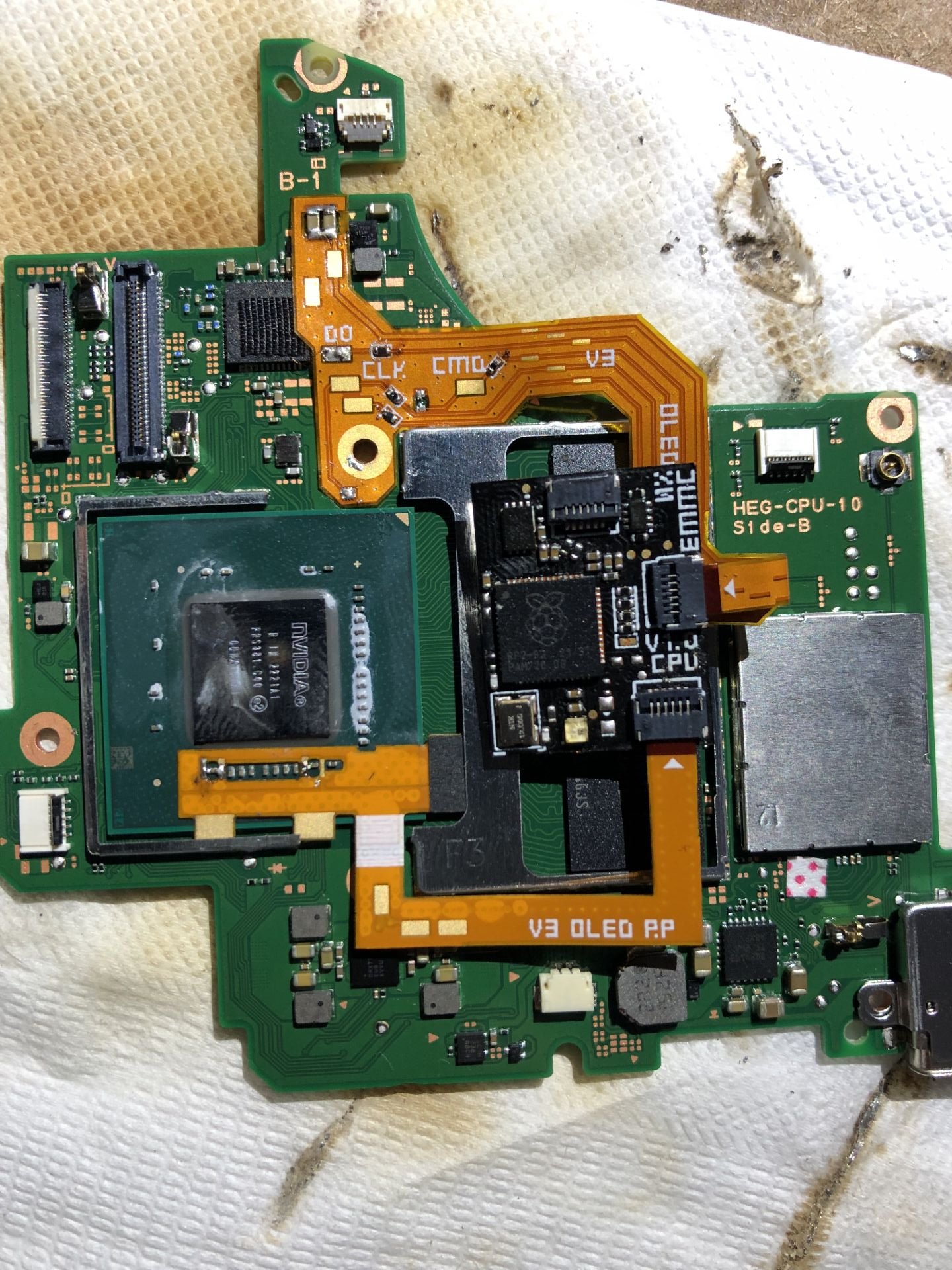

Ok guys. Who remembers old school RGH on xbox 360 to get the cpu keys. Do you remember the CPU Postfix Adapter? I think that this is what we need! Look at my pics.If someone could make an adapter like this it would be absolutely stable and work 100% fine.The cpu pin that you can see at the photo has a spring and the needle pin is pushed with tension from the spring. I used it a lot at good old days of xbox 360 era to get the cpu keys and flash the dvd drives with custom firmwares. This is the real deal.
already thought about that. you would need < 0.2mm pogo pin to go under the eMMC, the prices for such thing are insane
https://aliexpress.com/item/1005002107157285.html
even this (the smallest) one has 0.25mm in diameter (main part), which is too thick (available space is 0.2 +/- 0.05mm) since the needle length is not enough to reach the balls.
the flex thingy is the best we can get. (it is possible to make spring-kinda flex thingy, that would be perfect)
My actual very first mod was an Xecuter with pogo-pins for the OGXB. I always had to give it '3 taps' near the chip to get it to work. This is actually what pushed me to learn soldering in the first place, I got real tired of the taps, soldered it in and said 'I'll never use pogo-pins again'.
If you use springs for your mod in a PORTABLE, you're gonna have a bad time...
i Would account that as the only error.
i installed over 25 picoflys now in all switches with emmc types and i never had an issue.
so i can confirm the pico works on every variable of the hardware that are available if its installed correct
Agreed. It is poor tools, bad technique, and lack of experience that is the big Switch Killer. The mod works.
The first time you had to install it you may had to tap it a little bit to get in proper position. It had happened to me too. But after that i never had a problem. And i dont think that it should be a problem at switch too after proper placement, but these prices are forbidding so there is no point of discussion sadly...
Nope, heating and cooling meant I had to tap it back every time I turned it back on and I'm not talking about the 360 stuff you posted.
Again, springs in portables sound like a horrible idea, just reball and set a line.

I dont remember any pogo pins on original xbox. I mostly used aladdin and duo x chips with soldered pinheader.
Error: *== No eMMC CMD1 request (poor wiring, or dead CPU)
Edit: Check the wires with multimeter.
Also, try to press the reset button when joycon logo appears. If it shows No SD Screen, then solder the SDA and SCL wires.

Do you think the *== error is caused by the MOSFET? I did two irfhs8342 on an OLED and got the same error.
“OLED single host board + PI2040 FW: 274 (naked version) connected USB-C POWER AUTO POWER ON PI2040 light blue light (HI) ~ blue light signal (LI) >>> yellow light flashing Remove USB-C POWER and reconnect PI2040 light blue light (HI) ~ blue light signal (LI) >>> white light flashes once indicating normal operation can be installed back to the host. If it is still yellow light flashing, try installing I2C SDA = 12, SCL = 13”
