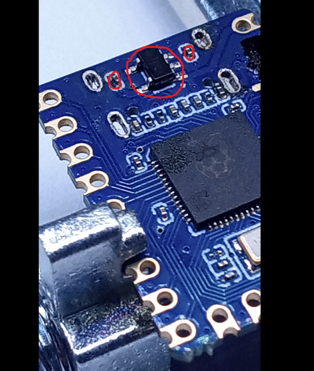

@rehius
if i remove that 2 caps
and regulator
can it still run normal??? i mean to glitch.
since i dont need to flashing firmware rp2040 anymore
is there side effect if i remove those 3 ?

@rehius
and regulator
It has no sideeffects, just remove it. You only need it for powering through USB, since its desoldert, no need to be on the board.
Reactions: nico77

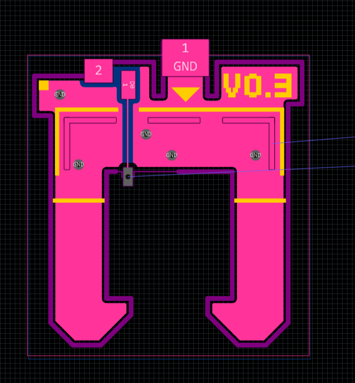

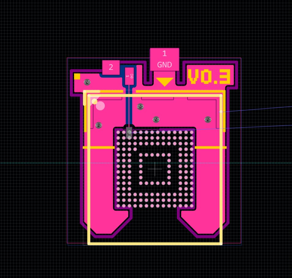

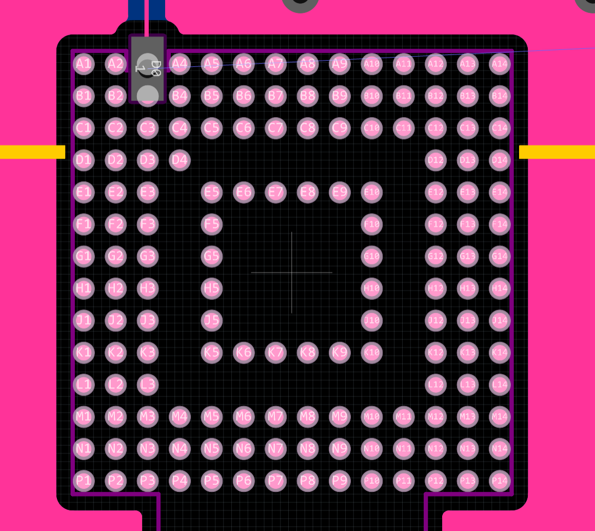

This is what in my mind, which i thought its more secured.
Also the left and right part might be extended like usual to secured it even more.
But now you create another problem. What if A4 creates sc with A5? You need to create these test pads for every pin on that side so it can be tested properly if it sc.

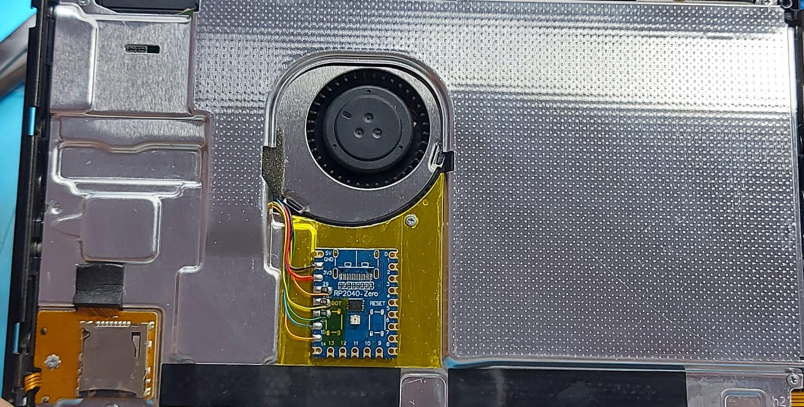

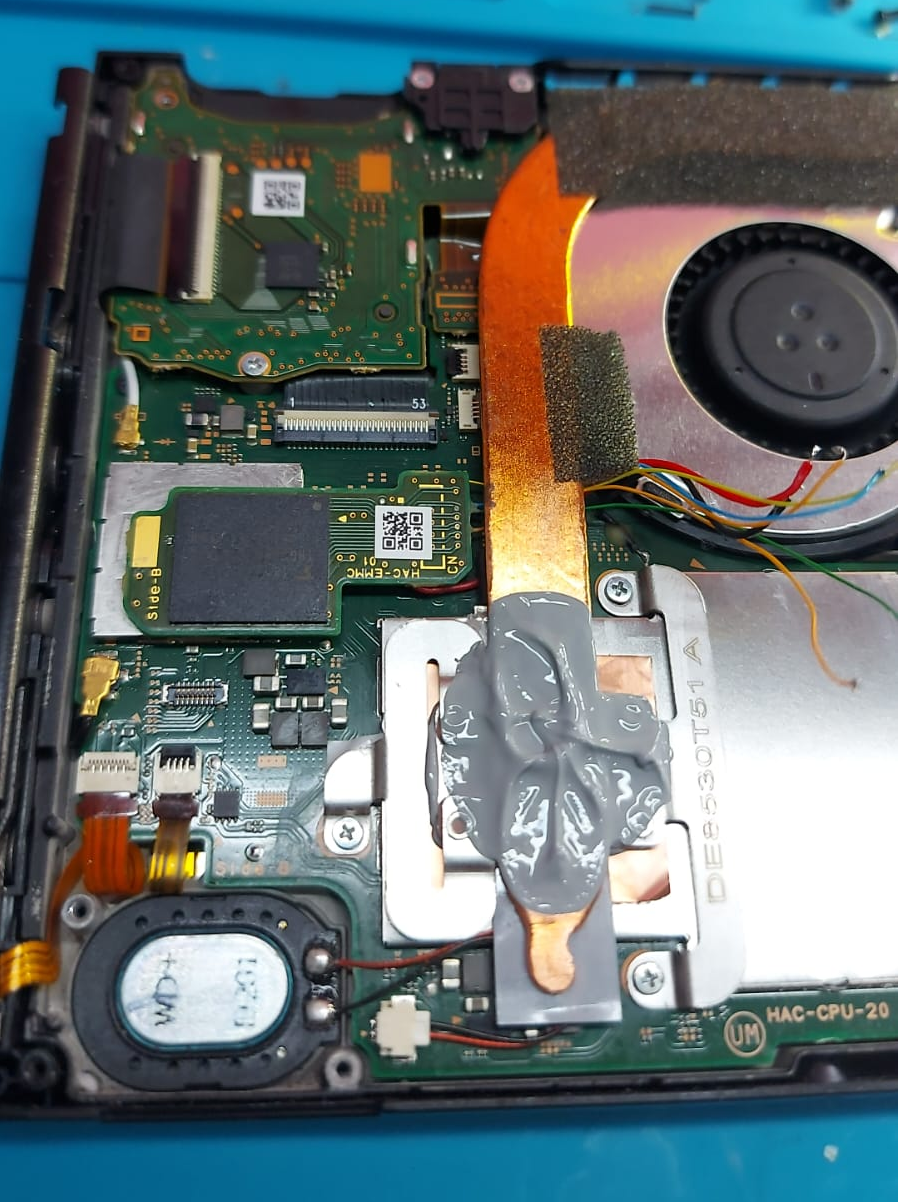

How is this looking? First time soldering at that scale.
I don't have a microscope or anything, just my phone.
Still waiting for my mosfets, they'll arrive today.
What is community opinion on one vs two mosfets?
Not bad. Mosfet double with pull down resistor. 👍🏻
Have you checked the readings on your multi meter to be sure there is continuity?
