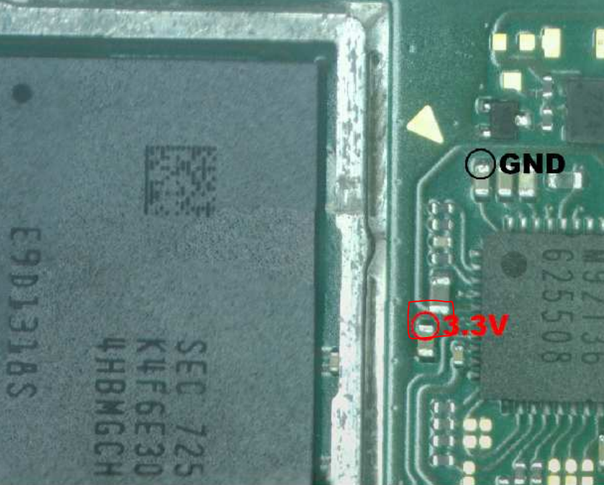

Hi everyone, I am moding v1 with picofly, I got a bridge in 3.3 cap and the cap next to it (pic above), I am unable to remove the bridge. Will it work normally or I am destroying my V1. This 2 cap is so close and easy to be bridge. I am spend 30 minutes trying to remove it but no hope

I make this mistake me too, i succeed only with hot air, i remove first smd and put it after i remove bridge.

My hot air is too big for this, I afraid blow all cap around it and end up as a disaster. Next time I will find another spot

I found a pic in this forum about it. I seem it is ok to be bridge. But I not sure, anyone can confirm this?

Not sure but I think the other side is ground from the top cap, u need solderwick and flux to remove it,
Otherwise hot air station and remove the caps then the rest solder

What u mean with hot air is to big? Are u talking about a hot air gun? Ifso don't use it.
Well on the picture they both seem to have 3v but on different lines , so remove the solder bridge
