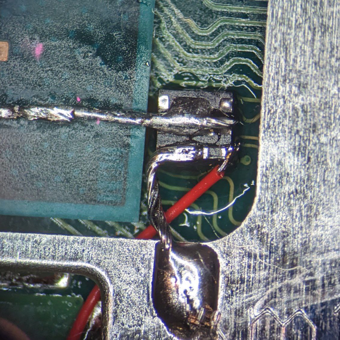

My Picofly just came in from ali.... I knew it was gonna be small, but not THIS SMALL. It's smaller than two of my fingers put together. Definitely hiring a professional to install this LOL. TBH at first look it doesn't seem like something that'd even work. Also, could someone check this picture? Circled in red looks to be a bridge? If you see anything else of concern please let me know, thanks!
both pins are +3.3v, should be fine
Reactions: Danook28
