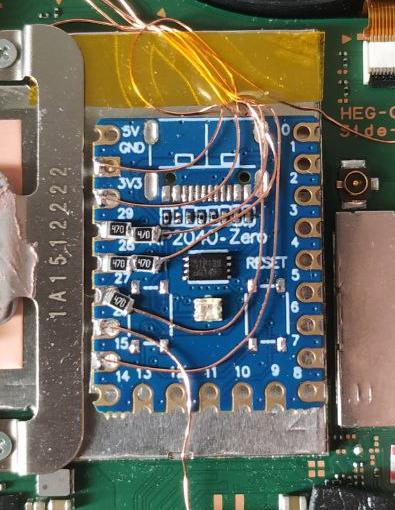

With the chip placed, the console does not start in original mode, if I remove it, it does start original, I already changed the micro sd card for another and the same result
I think you need double resistors on dat0 and cmd. I had the same problem on one of my v1's, double resistors fixed it.

man you're great... Console working on ofw and cfw adding a second resistor at points 28 and 29 thank you very much!!!
Could you provide a diagram of how to place the resistors?

Everyone, I think it's time we update the resistor recommendations. I've tested double 47ohm on an oled, a lite and a bunch of v1's and they all work fine, and most of the v1's didn't without. Haven't seen any situation where it causes problems. @rehius @lightninjay @Adran_Marit

I have no issue with updating to default installations including 94 ohm on Dat0 and CMD pads of the RP2040. I also need to update and include ALL of the LED codes now that it seems we've stabilized into an area of comprehensiveness. I think the main reason we have left it ambiguous is because we have not made a wire size/thickness requirement, and different resistances of wire diameter could have some effect potentially.

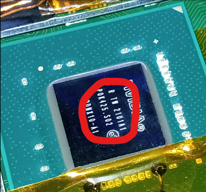

So Goodfellas, my time has come, it's tradition every generation for me to take a big financial loss, I think I burned my Nintendo Switch OLED.
I still have no idea what caused it, but I believe it was my mosfet mount that shorted out to the metal casing that covers the CPU. When I turned it on, there was smoke somewhere. It is currently in BSOD (Black).
Does anyone have any tips for me to try to check if there is salvation? Maybe a blown fuse, or a blown component. (I know it might just be empty hope).
I wanted to check out the mainboard, before thinking about the possibilities, I'm already looking at mainboards to buy...

You can always buy a new one but it's more fun to try and fix it.
Some pictures and background story would provide a good starting point for some people here to try to help you.
In any case, first I would check the voltage draw then see where that takes you.

You should trace what component burn, that is your best clue.
Using microscope find some 'explosion' matter splatter around.
I've already started doing it. I removed all the rp2040 cables from the board, and tested the 3.3v point, reads 3.35v when power button was pressed. currently no component in the heatsink fan region seems burnt, the smoke in my view came from that region.

It's always nice to fix, I confess I'm inclined to really try. I'm checking the voltages, when the power button is pressed the 3.3v point where the picofly's power wire is installed reads 3.35v. Then energy arrives in that region.
