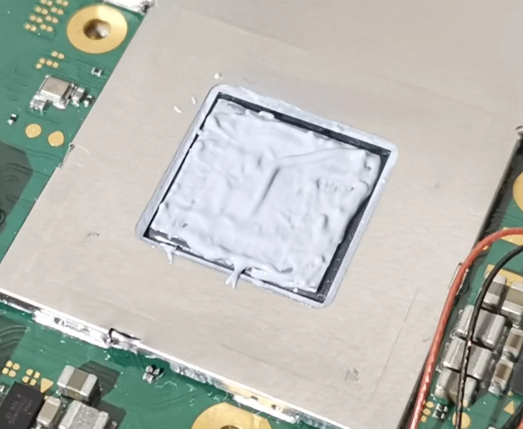

i saw some people remove the copper tape.
removing the copper good or bad idea??
I've personally never done it exactly like that but I have cut the whole CPU part of the shield off in the past and mounted the heat pipe directly on the dye. You have to be careful though because doing the way I did there is a chance you can crack the dye or get uneven mount and personally I noticed no temperature difference so I would just do it with the copper sticker intact. That's just my input though.
yes, i wanted to know how the temperature difference.
but im gonna stick with the default without tear the copper sticker.

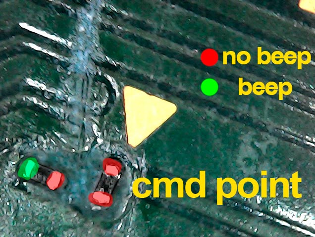

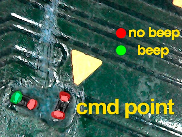

Check also the resistors on CMD point (photo)
I checked the cmd point, and got the results below in the legend. Remembering that I put the red probe (+) on the components and the black probe (-) grounded on the metal that covers the usb. diode test.
Is it hope? :)
Is it hope? :)
I think you need to replace the "no beep" one.
Can you measure it in Ohm mode to see what value it gives?
Is it hope? :)
what's the reading in the diode mode on both sides of CMD resistor?
