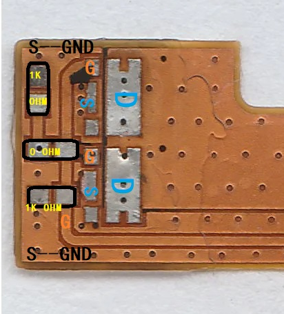

That resistor you soldered the jumper on actually goes to both mosfets Gate.

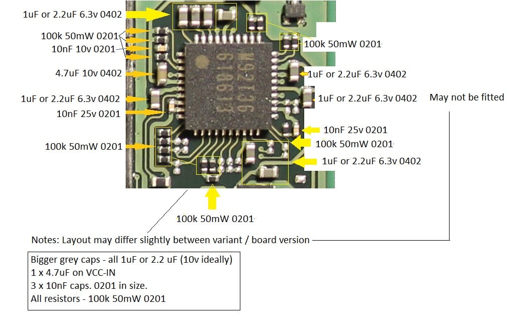

If it's power related these are the areas to check for short/problem

These capacitors follow the same rule?

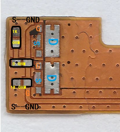

It should be like this (picture)
But as @lightninjay said in the post above, some multimeters might give continuous beep.
Try to find a similar capacitor somewhere else on the board and see if you get same results.
Those capacitors being dead make alot of sense since it there the mosfets were soldered and likely the source of your smoky situation
