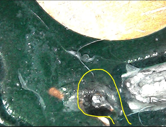

Is this resistor the same one used for the CMD -CLK and DAT0 points on the rp2040?
.387 No beep.
No, its not the same. I tracked the trace, that resistor is not connected to ground so it should not beep but it needs to have a specific resistance.
Maybe you can diagnose it as @Relon said in diode mode but I dont know what value is correct in diode mode.
If you can make a reading in resistence mode Ω we could know for sure if it need to be changed

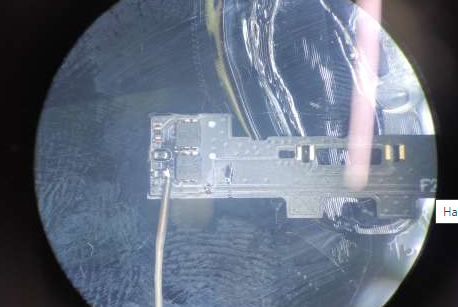

hi everyone, i have successfully installed picofly on my nintendo switch lite. now i want to install it on my v2. i noticed picofly has new firmware with many changes. I would like to know if it will work well with only one mosfet (I noticed one mosfet can cause some errors)

Anyway, in Ω 20k scale, cmd resistor reads 4.69. This is a good value?
It works fine. You don't need two mosfets, ever, unless one of them is broken.

That is good, the resistor is ok. We need to look elsewhere for the problem.

I also have this CLK island that I rebuilt before powering up. She is not grounded,
I used clear 3d printing resin, and its diode value is 700.

I mean the end of the flex there is 6 line. The middle part should be soldered together to use both mosfet.
only 3, i will try together tomorrow. Thank u
why only 1 is used and it works for them
