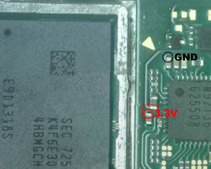

What u mean with hot air is to big? Are u talking about a hot air gun? Ifso don't use it.
Well on the picture they both seem to have 3v but on different lines , so remove the solder bridge

I know how to create emummc, I have placed 50 chips, but this v1 does not start with the chip placed and volume +-, the ninten logo appears... and a black screen. If I remove the 3.3 and the ground of the chip, it turns on normally
try the emmc benchmark in hekate. It's probably because of emmc read failures
ok I guess it best to remove it, my hot air gun can help me remove it, but the speed and amount of air could make it event worst
Add some more solder to the bridge then use some desoldering wick (with flux) from the side and it should come right off.

Hi everyone, I am moding v1 with picofly, I got a bridge in 3.3 cap and the cap next to it (pic above), I am unable to remove the bridge. Will it work normally or I am destroying my V1. This 2 cap is so close and easy to be bridge. I am spend 30 minutes trying to remove it but no hope
This 3v3 point is pain in the as* without a 0.1 solder tip, good wire and steady hands. Use the 3v3 on emmc board next time, much easier.

My hot air is too big for this, I afraid blow all cap around it and end up as a disaster. Next time I will find another spot
97410833_10157668027629209_2812355155335315456_o-jpg.209024
I found a pic in this forum about it. I seem it is ok to be bridge. But I not sure, anyone can confirm this?
Docked won't work if it's bridged
