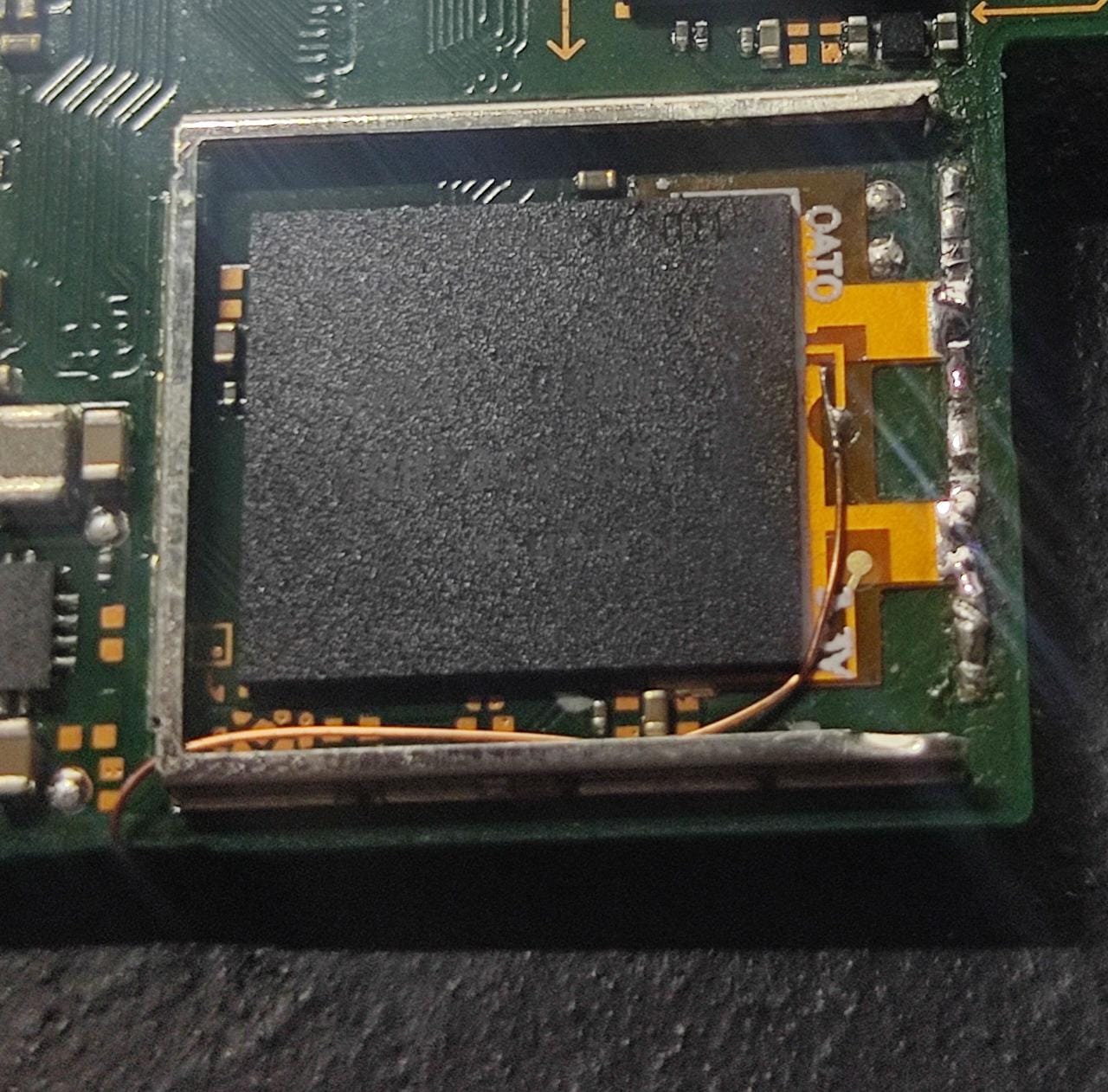

Hello here I am with a Oled that has the same Problem after a hwfly install (no I did not install the hwfly) someone else did , so this has nothing to do with the picofly this is a issue that occurs during installation
User install error. Very likely too. Another variable to take into account.
Edit - Thinking about this more it could also have been a bad/defect hwfly chip or defect apu flex cable, @LogicalMadness can tell you all about that. Just too many user based + unknown variables to pin point errors and too highlight them to avoid in future installs.
Reactions: QuiTim
i Would account that as the only error.
i installed over 25 picoflys now in all switches with emmc types and i never had an issue.
so i can confirm the pico works on every variable of the hardware that are available if its installed correct

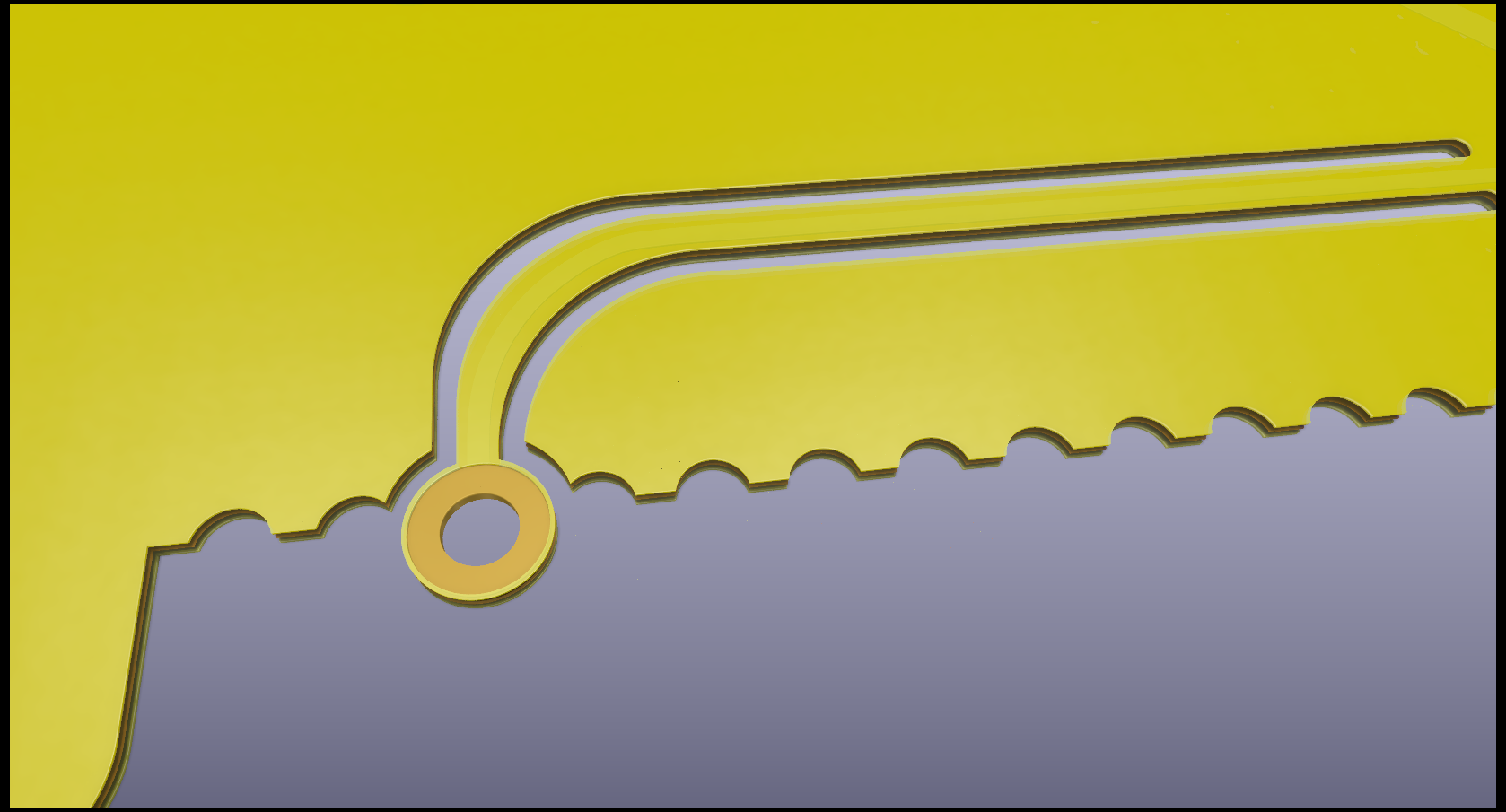

With more than 1-2 points, if any solder protrudes ever-so-slightly *more* than the others, neighboring points will fail. If it's slightly *less*, that point won't be reachable.
This is why a rigid adapter won't work here. Each point needs a "spring" of some kind to adapt, and at this scale there's no easy way to do that.
This is what I meant by "seesaw":

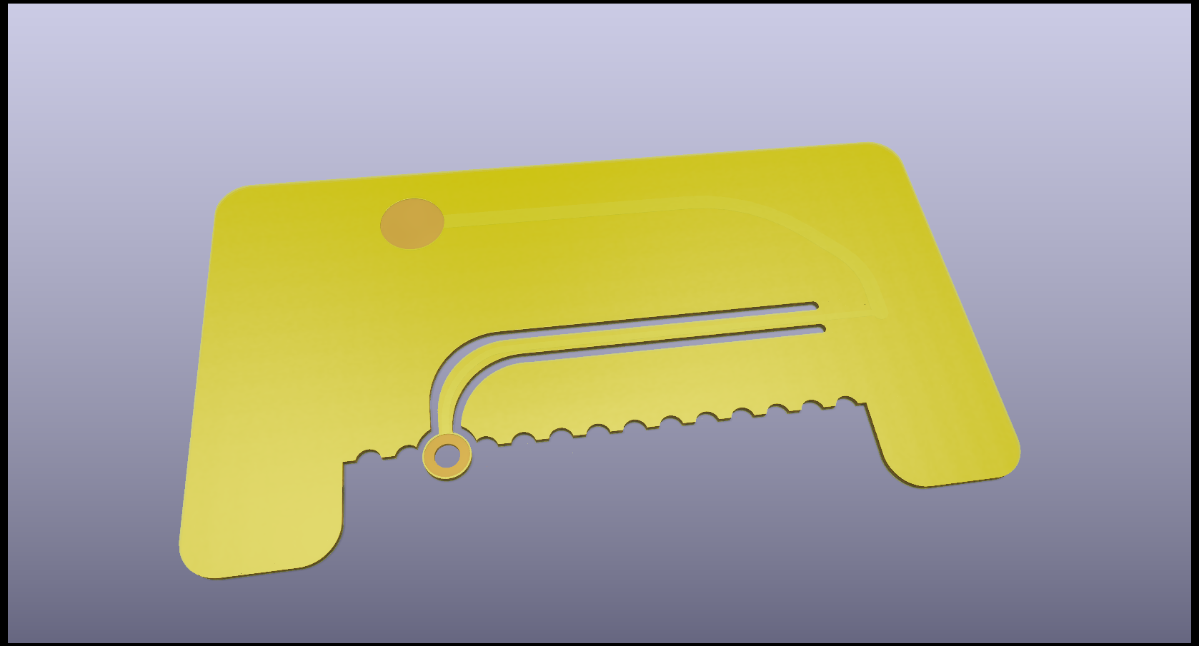

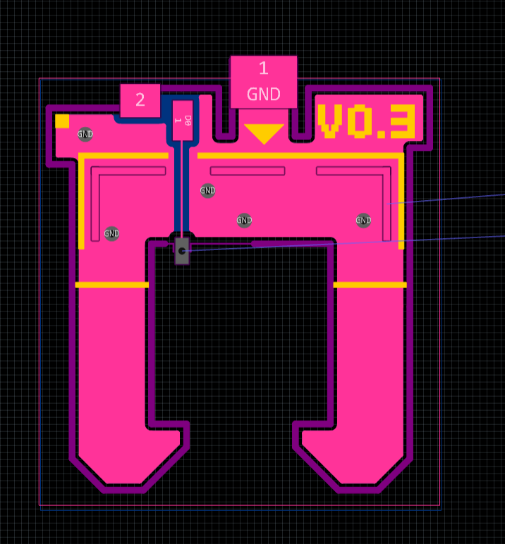

I have a strange behavior with an OLED i just did.
Directly on first boot (and after a chip reset), the chip goes "=** eMMC init failure during glitch process" error and then boots OFW (which works fine)
a few more boot attempts, same error and still boots ofw.
A few more attempts, and the chip somehow figures out the right timing and boots hekate.
after that, it keeps succeeding and booting hekate quickly everytime.
When running emmc benchmark in hekate, the speeds are a bit slower than usual (160 MB/s) but it doesn't seem to go into slow mode. No warning about it.
If i reset the chip, the cycle restarts. a few unintentional ofw boots and then it's fine again.
I've used the green adapter and therefore detached the emmc. I'm thinking the emmc connection to one of the DAT points might be bad? But still it works just fine and OFW works fine. I'm confused. Ideas?

Since the solder will based on the bga pad on the pcb, i think the precision is better than the flex itself.
My doubt on the precision more on the flex part than the pcb part. But again its not a problem, since its flex-ible, means we could just press it so that its in touch with the solder.
Maybe... it depends on the flex having enough give. I don't think it can flex too much in the same plane.
It's just like how a 3-legged stool can never wobble, while those with 4 or more legs will.

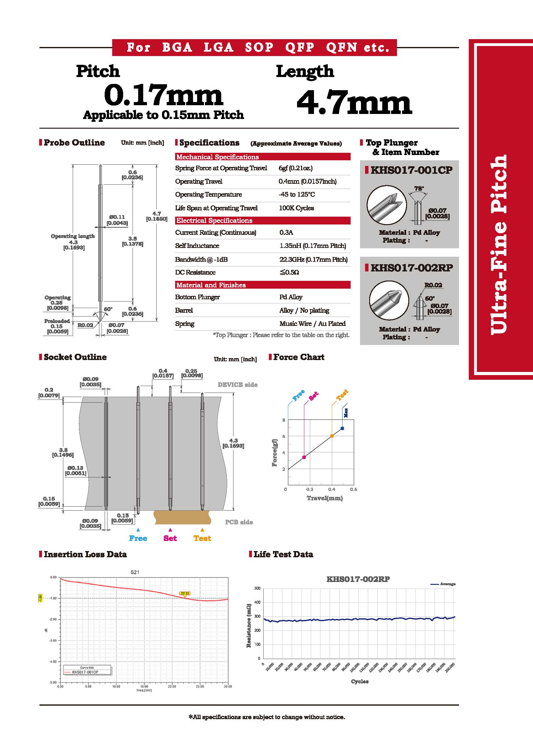

Hahahaha i spent the last couple of hours trying to see if this can be done. I guess we both had flashbacks from good old days :D After looking through the specs of the possible materials I think that a small production is not viable.
I did find the test probe/pin that might do the job seeing as the clearance between bga and pcb is around 0.2mm
The other part should be fairly easy. Lets see what other people think
