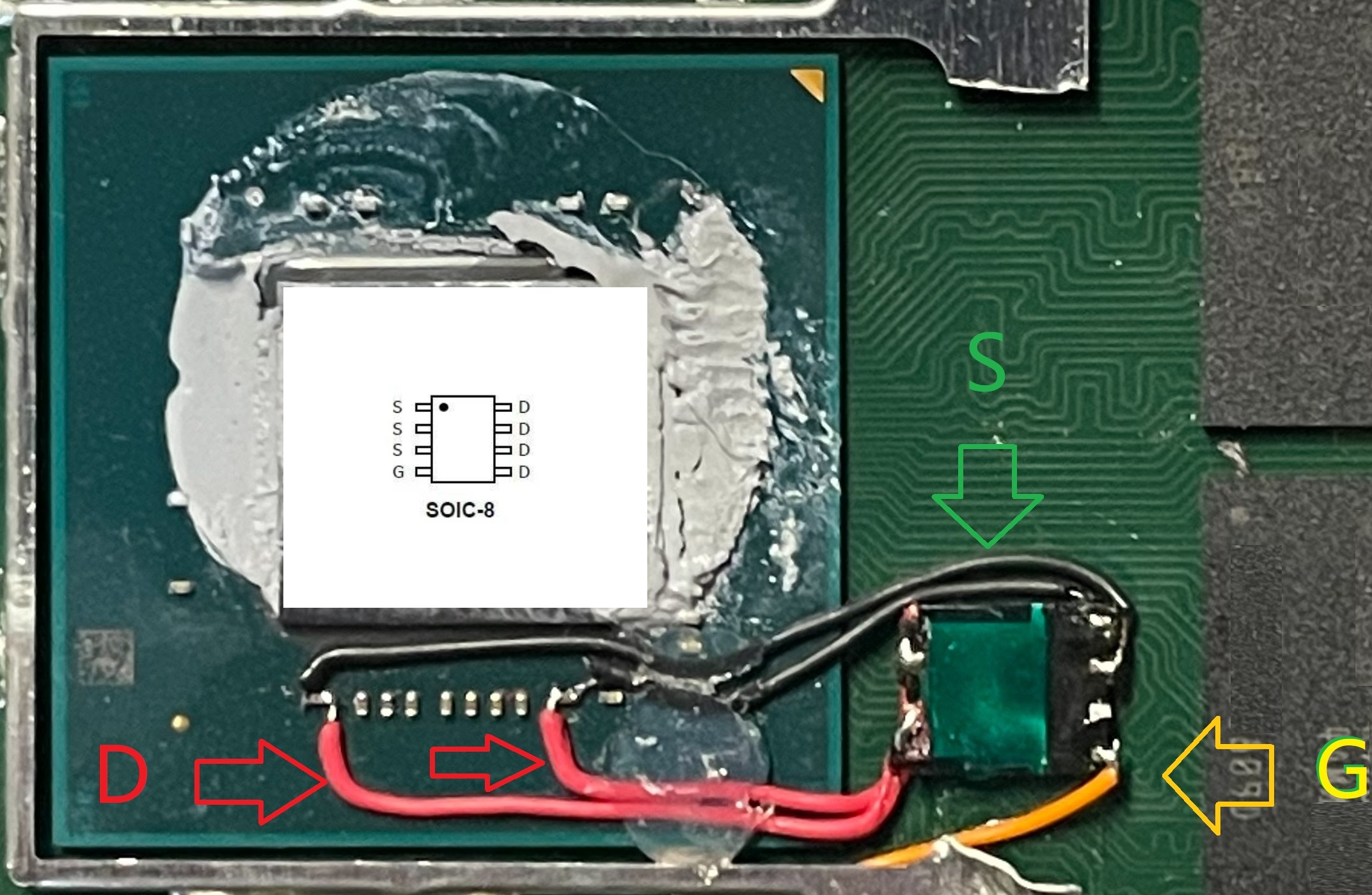

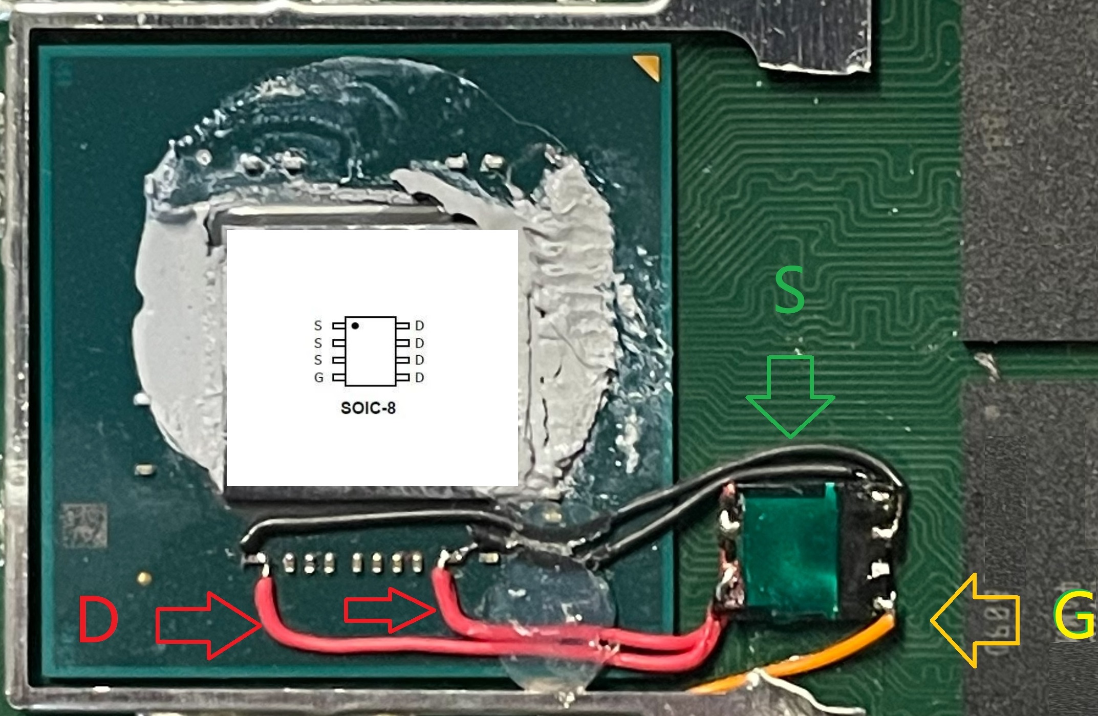

Correct me if I'm wrong: when fully installing a MOSFET, is it normal for D and S to show continuity ( if G was somehow triggered), but G should not to either?
Thats correct, you're copy paste the low impedance(low resistance, or continuity beep) from CPU caps (SP1,SP2) to the mosfet D&S.

cable uses AWG 30~32. You can try using a single high-power Power MOSFET, which will greatly improve the BOOT speed.”

On the V1… is the red line both connection to the tops of these caps? Or is the left in the top and the right one the bottom? It’s very hard to tell on the PDF
well i mean the red line only goes to the top right? so i would suggest it goes to the top one.
if it would went to the bottom one i would made the line to the bottom cap B-)

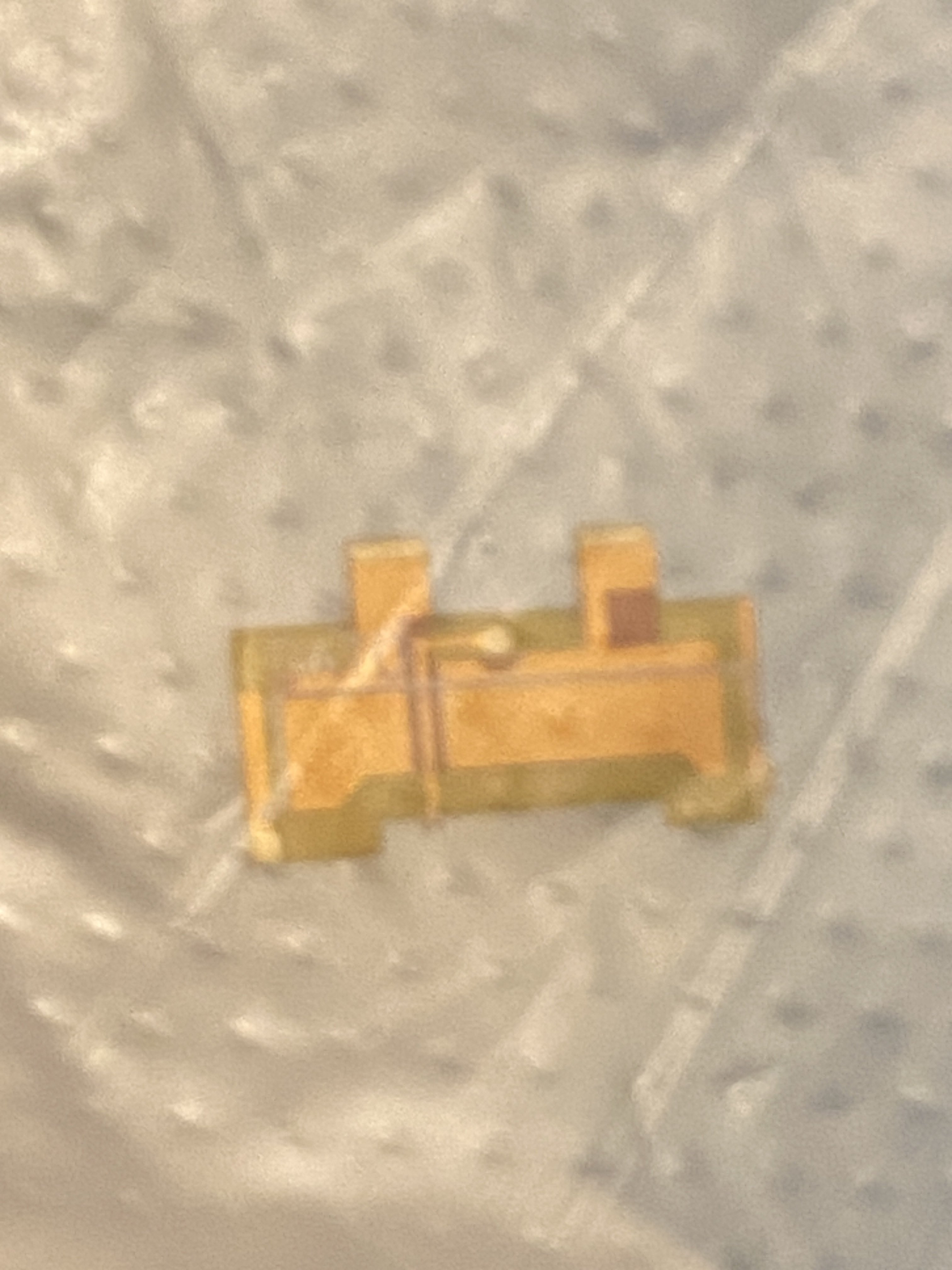

This is exactly who I ordered 20 from.. all of them came in as the 3 point crap ones… none of them were the 4 point I ordered. Currently trying to get my money back.
Thanks for telling me. I won't order from them again. One thing I'm trying is buying directly from the Chinese market through Sugargoo.
I already ordered 10 pieces from this 1688.com buyer. Will report back
Well to be fair the cap on the left you connect to the top but the line comes from below.. I just want to be careful that’s all.. wasn’t trying to criticize. Just wanted to make sure I know exactly where to connect. I’ve not done a V1 yet and have no V1 flex..
The top of each cap it is then 🤝
i didnt feel any criticizisum dont worry ;-) just saying if it went to the bottum one the line would go down u can also check the aio thread there are maybe better pictures so u can see urself :-)
