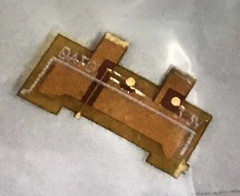

is this the dat0 adapter link :
https://www.aliexpress.com/item/1005005316412395.html
If yes lets inform the rest of the members to avoid it at any costs!
https://aliexpress.com/item/1005005315891694.html
I purchased this type of 4-anchor adapter.
What you actually receive is the 3-anchor piece of garbage in the attached picture.
I have bought one from multiple sellers and they were all the same.
I think at this point the best solution is https://munia.io/devices
It does not have any anchor points so you need to use UV mask or glue but at least you don't risk fu*king the emmc.
*Edit: they seem to lean to the right by default so I guess bridging the second pin does not matter after all.

That is 3 point.
Open the image from the review its 3 point.
And the 4 point doesn't have 2 test point, only 1 which is the Dat0.
I made a mistake copying the link.
I ordered a dat0 adapter with 4 anchors.
Not the garbage that kills emmc with 3 anchors.
hwfly official sells newer newer adapters than 4 anchor.
If you buy a dat0 adapter with a 4 anchor product image from most stores, you will probably receive 3 anchor garbage.
FWIW I ordered those ~3 weeks ago and received the correct 4-anchor adapter.
Ordered back in March from that store and got good ones. Ordered on 20th of May and got garbage.
Asked a refund and the seller won't give money back, waiting for the Ali to intervene.
