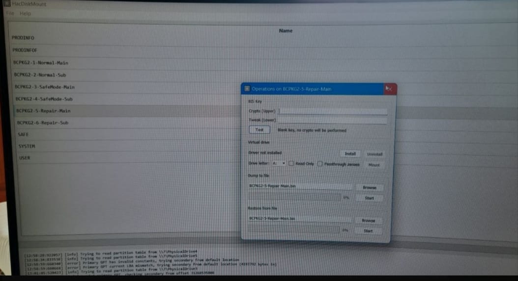

Just select GPP and Boot0/1 and push power button until RW appears on the right the same as SD Card, mount it after that and plug the Switch to the computer, download HacDiskMount and check the physical partitions.
The same as making a backup.
OK. I am going to tell him to do all this and when I know the results I will publish it here again. thank you

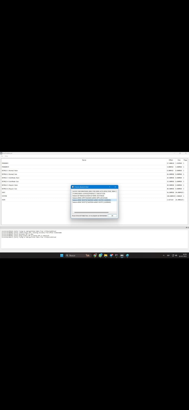

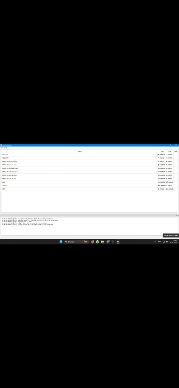

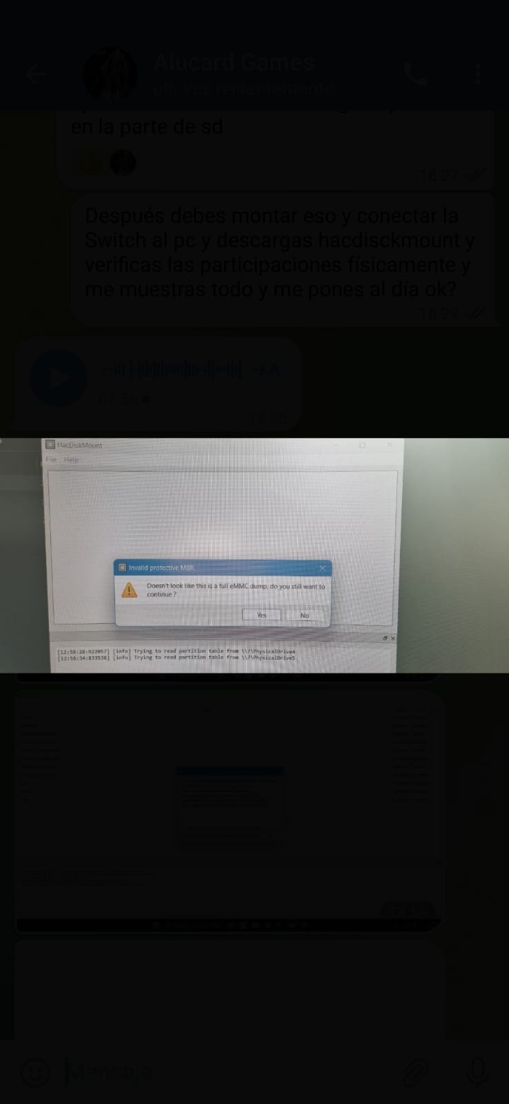

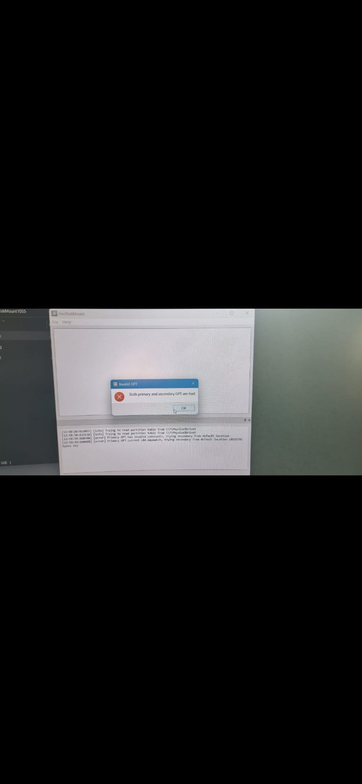

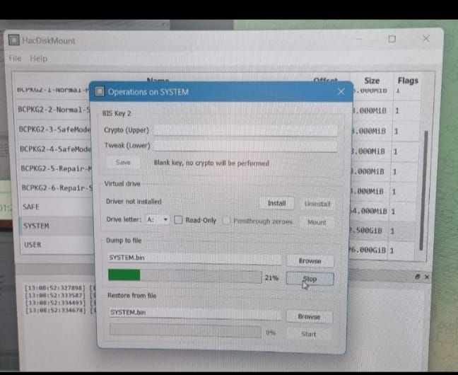

The partner has already been able to carry out the tests and partition readings and these are the results when connecting the switch to the computer. now, in what situation is the nintendo switch?

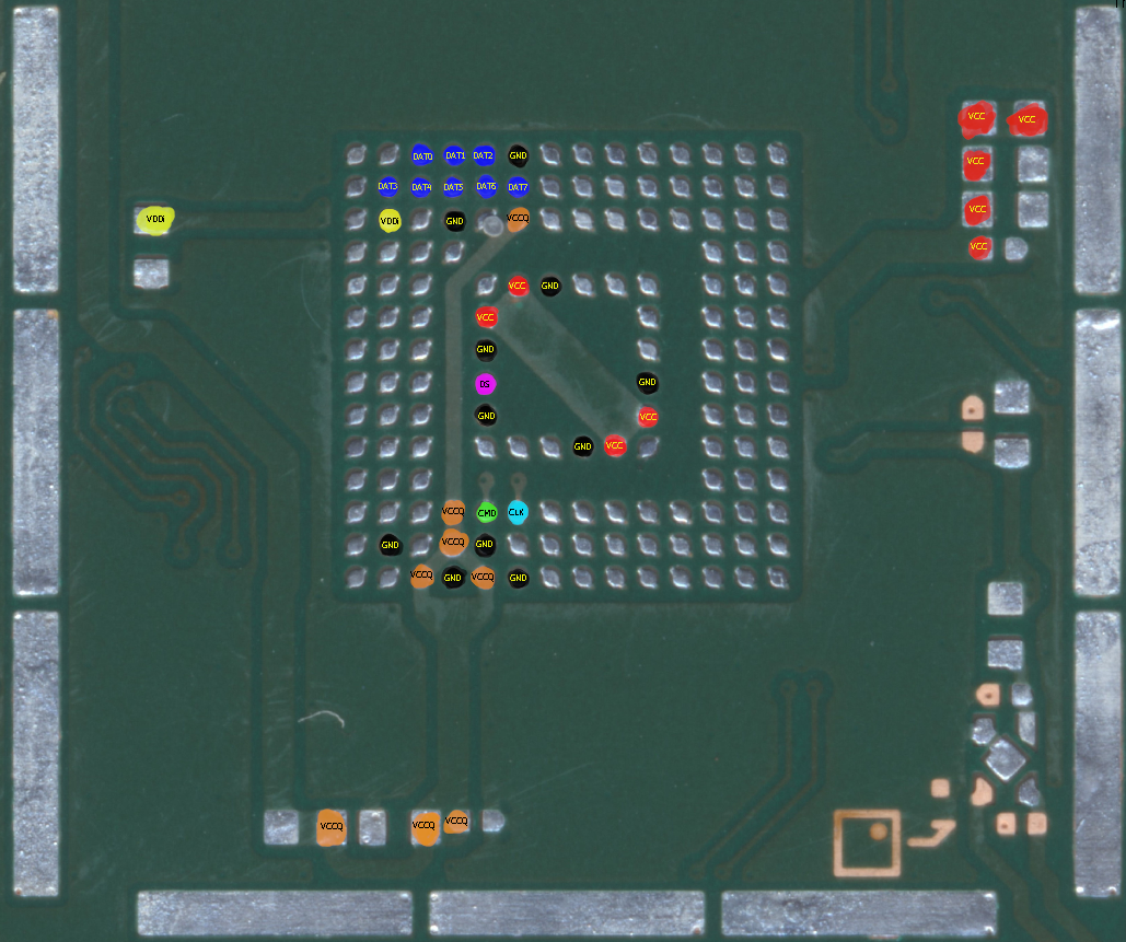

Anyone know if an emmc just uses the pinouts that are traced on motherboard or it uses all of the points that are on the board? A friend gave me this dat0 adapter wirh this pins broken...wanna know if i can use it whitout interfere on the emmc function
Hard to see in the pic, but see attached pic for all emmc points that are connected to something (oled emmc board for reference)

I just told you to try this now. In a few minutes he will tell me something and I will let you know what happens. thank you
Test performed. this now appears with UMS. now what next?
That screenshot looks just like mine - the app is unable to mount the emmc.
