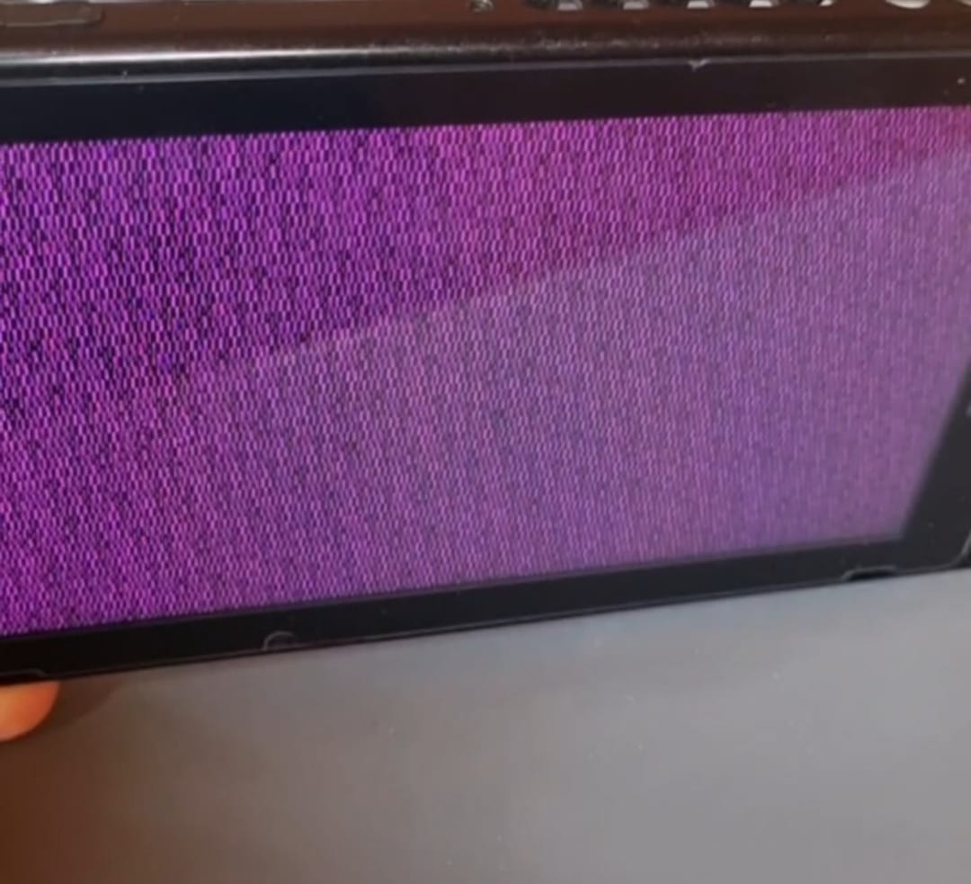

just tried with the xplorer file and directly purple screen without letters or error on the screen. It seems that the problem is serious and surely it is in the gpu, ram, or even in the nand. what do you think?
Lets do another test.
- Open the switch, unplug the battery and remove the emmc board. then plug in the battery and turn on the switch (it should not power on)
- Then disconnect the battery and place back the emmc and reconnect the battery and tell us what happens

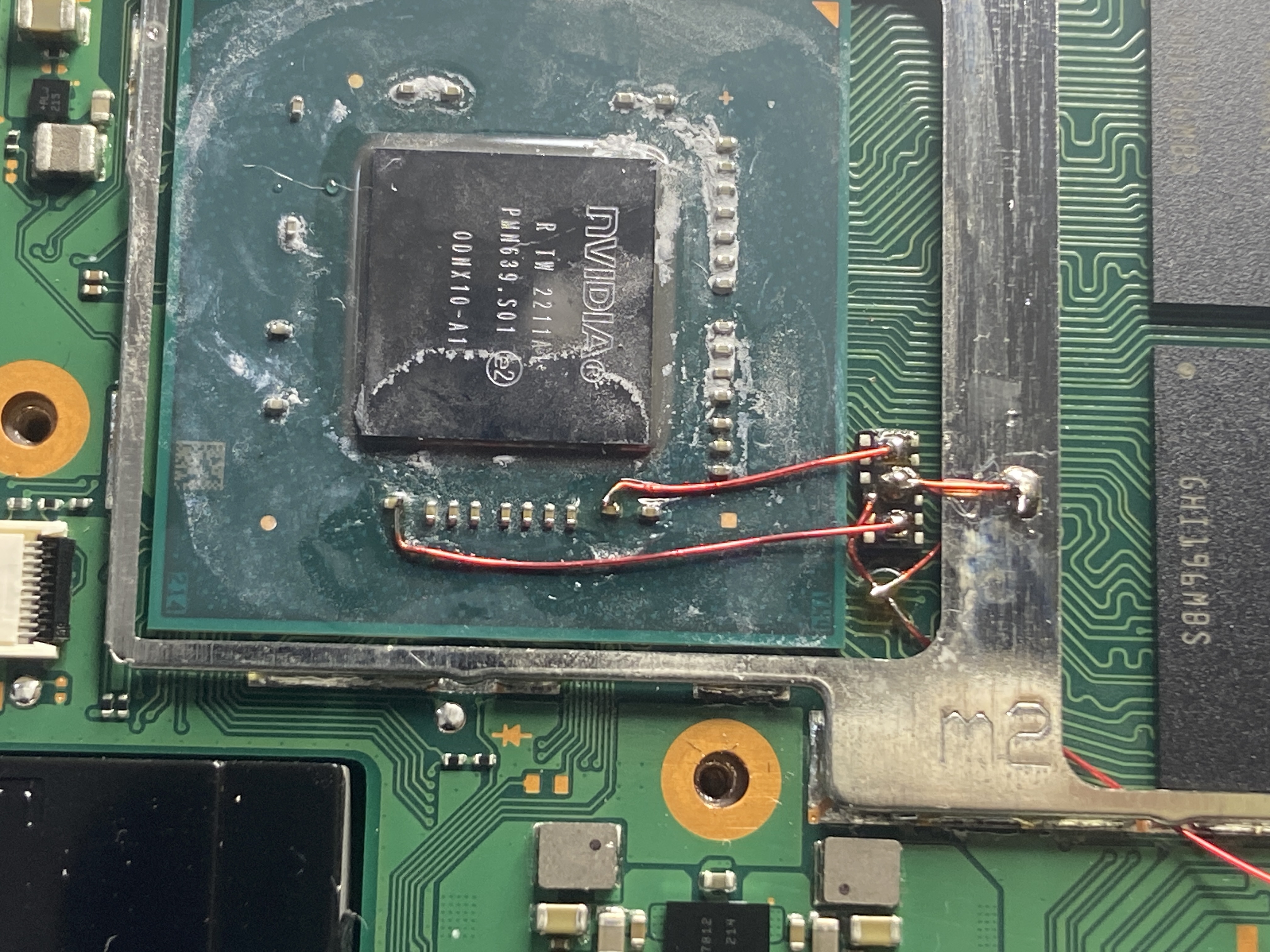

I think what killed this OLED is using my new soldering station without knowing it very well. I did another OLED and worked perfectly. Can't get enough of soldering MOSFETs.
my very first install I did the individual mosfets just like this.. I rather enjoyed it but it took a lot longer than just using a flex cable. Very nice work!

Sorry. The pressure tests have already been carried out previously without any success. My friend is from another country, I can't be with him :( I don't know if I'm applying enough pressure here either. I'll tell him to try all this again just in case before continuing to try other options. Thank you
He has already tried these tests right now and if he does not have the nand directly connected, neither the switch nor picofly does anything. if you reconnect the nand do the same as always : ( without success

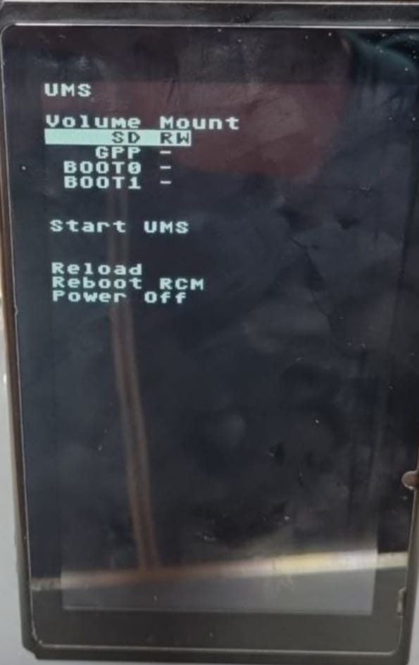

Test performed. this now appears with UMS. now what next?
Uhhh, he should check with hacdiskmount if can read the GPP partitions and BOOT0/1
If those things read well, we'll be in the same situation xD
What would be the correct use of this ums payload? What would be the steps to check the units and detect where the problem is?
Just select GPP and Boot0/1 and push power button until RW appears on the right the same as SD Card, mount it after that and plug the Switch to the computer, download HacDiskMount and check the physical partitions.
The same as making a backup.
