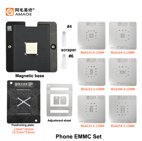

Maybe the ultimate solution is to use this :

Totally agree, waiting for this one to arrive.
