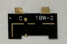

Actually no, I was thinking of the "black" version, I imagine it should be similar to the old "corner" adapter. If so, it has a good contact, but I haven't tested them personally.
There should be as well good adapters from "official HWfly stores", but it's over 10 EUR each, so stencil + hot air is the way.

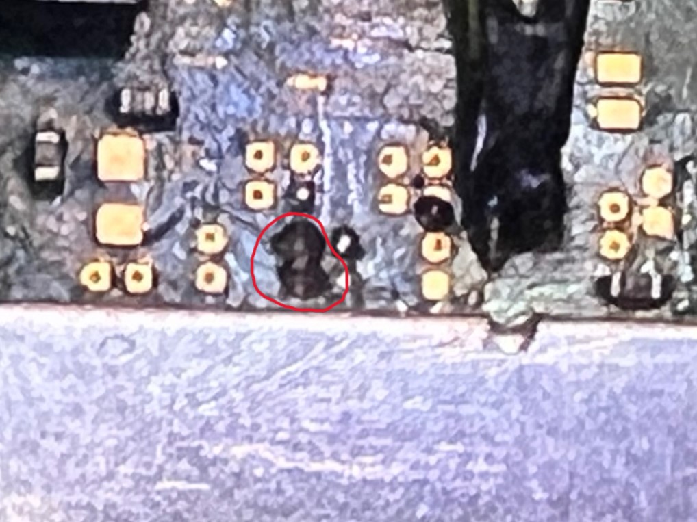

Thanks for the info i follow the guide for the rest of the instalation but the D0 points have disapear, how i can fix that im desperate.

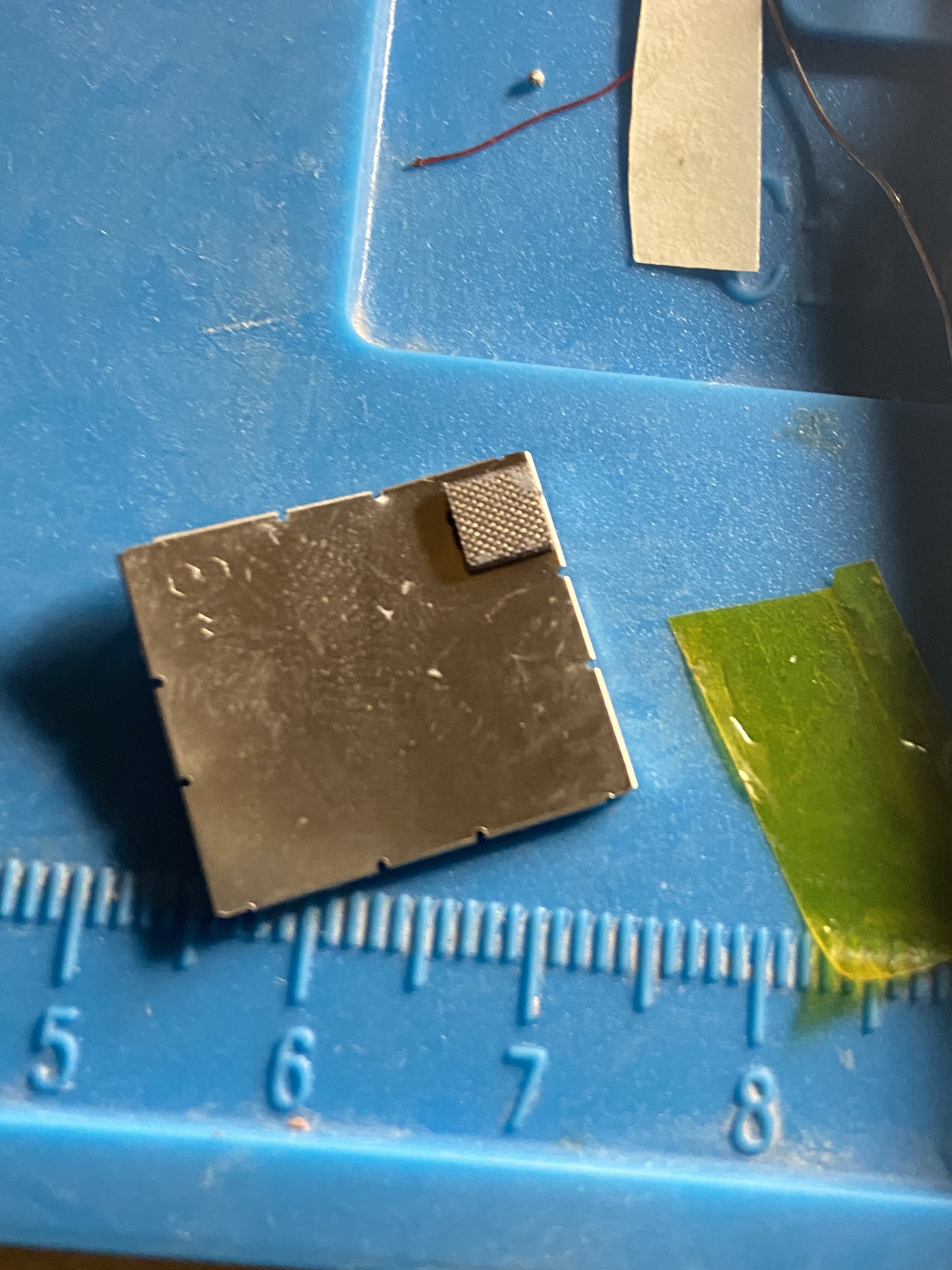

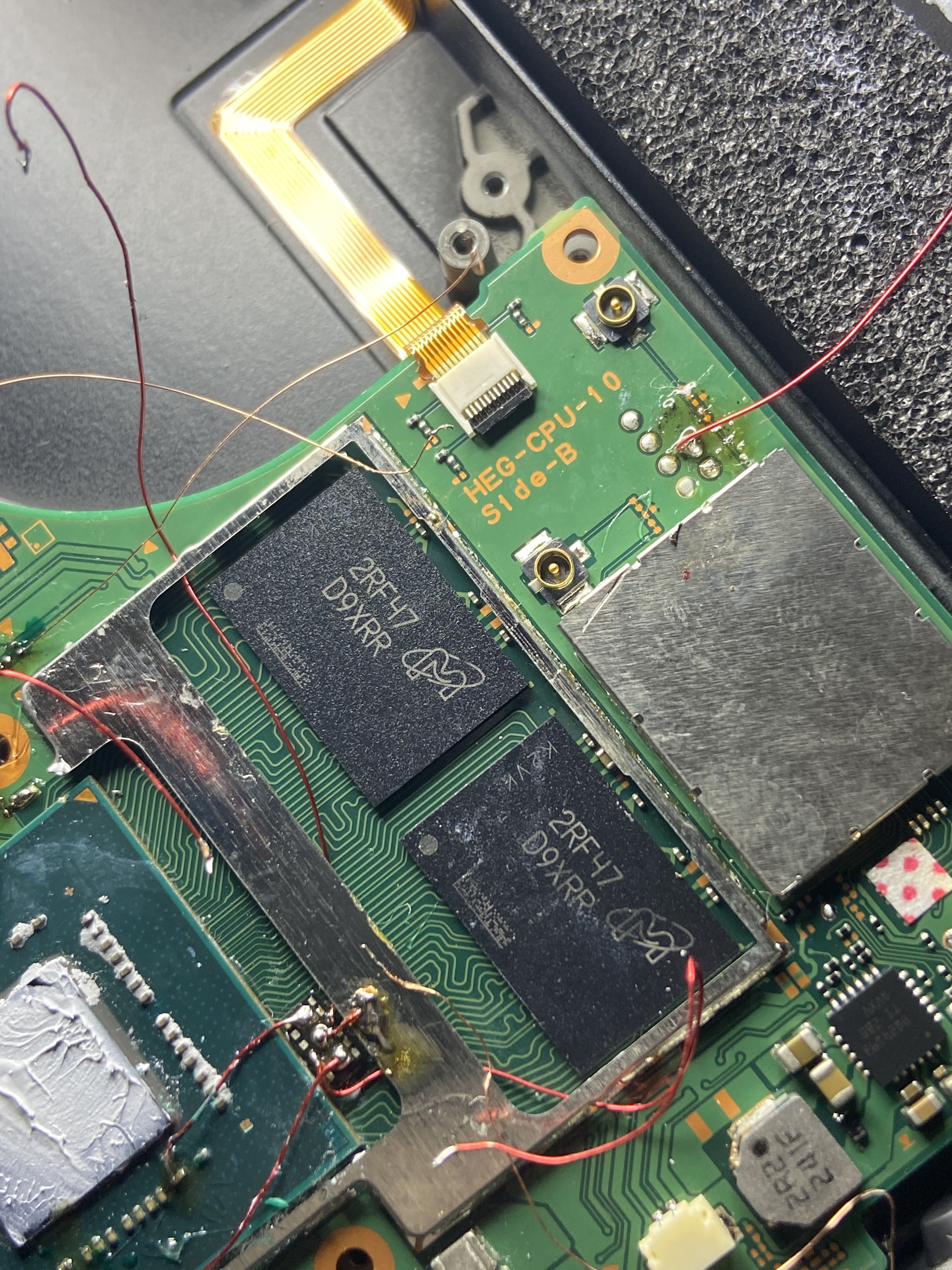

Hello.
- This is a new installation. It was working prior to installing the chip.
- Black screen
- Yes, 0.7v. All values are within normal range.
I removed everything and turned it on, nothing black screen.
I resoldered everything with new wiring and new pico. Same result.

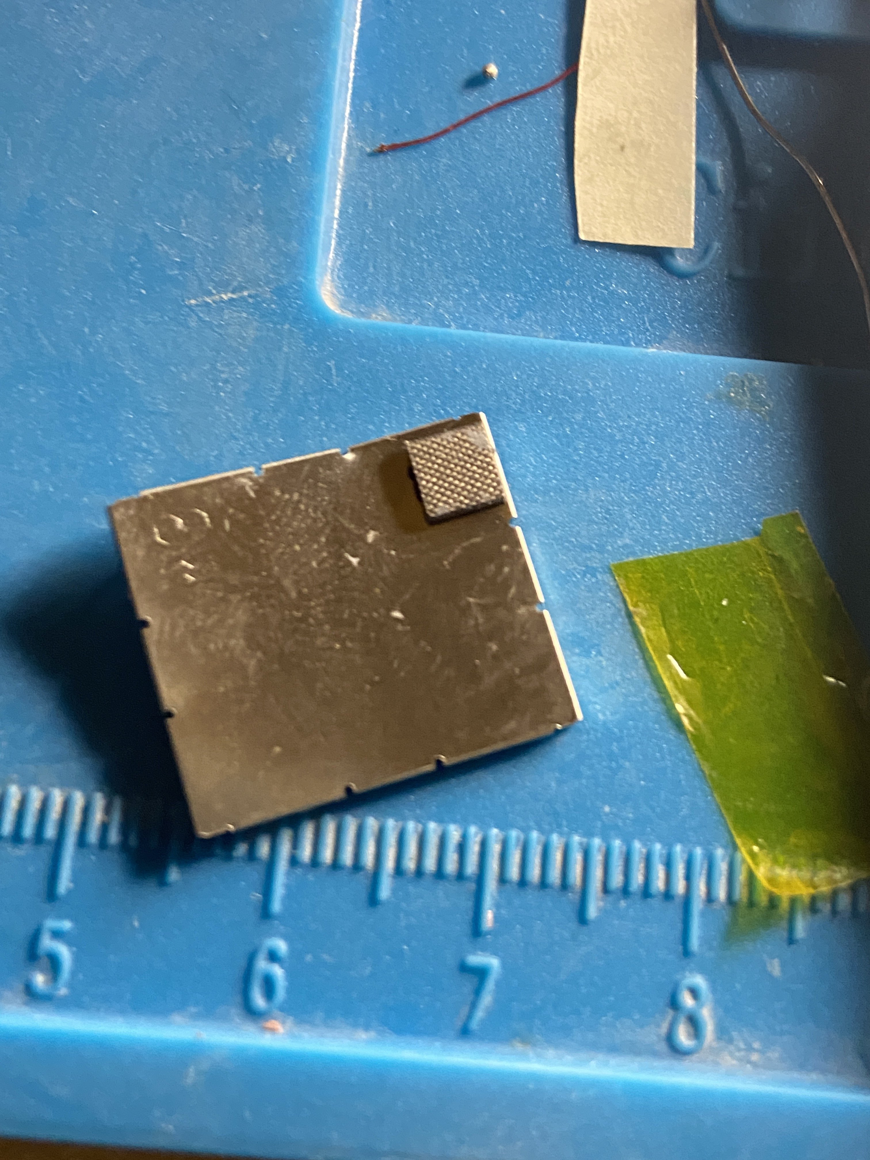

One thing I noticed about this OLED is that it has a RAM chip I haven't seen before, and the nand cover has a sponge that I've never seen in any OLED I've worked on.
What do you think?
Two things I did differently with this installation. I cleaned the CPU with a regular 70% IPA medical swap, and I used normal superglue to fix the MOSFETs next to it. I don't know if either caused this.

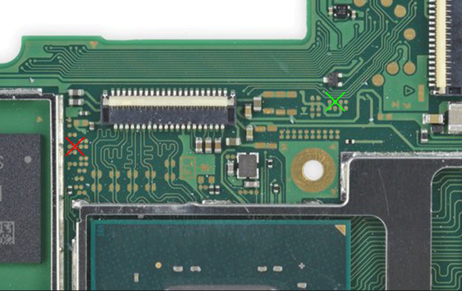

I think your best best bet would be to try and get some solder to pool between those two ripped areas in an attempt to get the pads to bridge back together. Then try to solder your Dat0 point to this alternate point if you can get that spot jumpered back together. The Green X is the alternate point.
Hello.
- Black screen
What do you think?
On a USB meter, it;s drawing 0.4amps, 15v.
Ipa 70% is not really good since it takes more time to evaporate 96% and up is way better (and it cleans better)
Anyway I don't think that this is the issue here.
I know this is old news and repetitive but have you tried docking it? That fckn connector it terrible.
Also regarding the resistor on CMD, could you measure the resistence in ohm mode not diode value.
There have been a couple of cases here where that resistor is fried during soldering. You should get something in the range of 4.7kohm od it's ok.

Hello,
Nothng on docking. Single led flash when docked.
value of CMD is 3.7k.
If there was something wrong with that resistor, shouldn't;t there be a purple scene?
This is my first installation with my new soldering station, Sugon A9. I did the job on 320C just to make sure I don't burn anything. Didn;t help apparently.

Yes, it should be purple, but it's always worth backtracking on the points we worked, usually the problem is there somewhere. But the value checks out anyway.
Did you check for shorts on the caps and IC below apu?

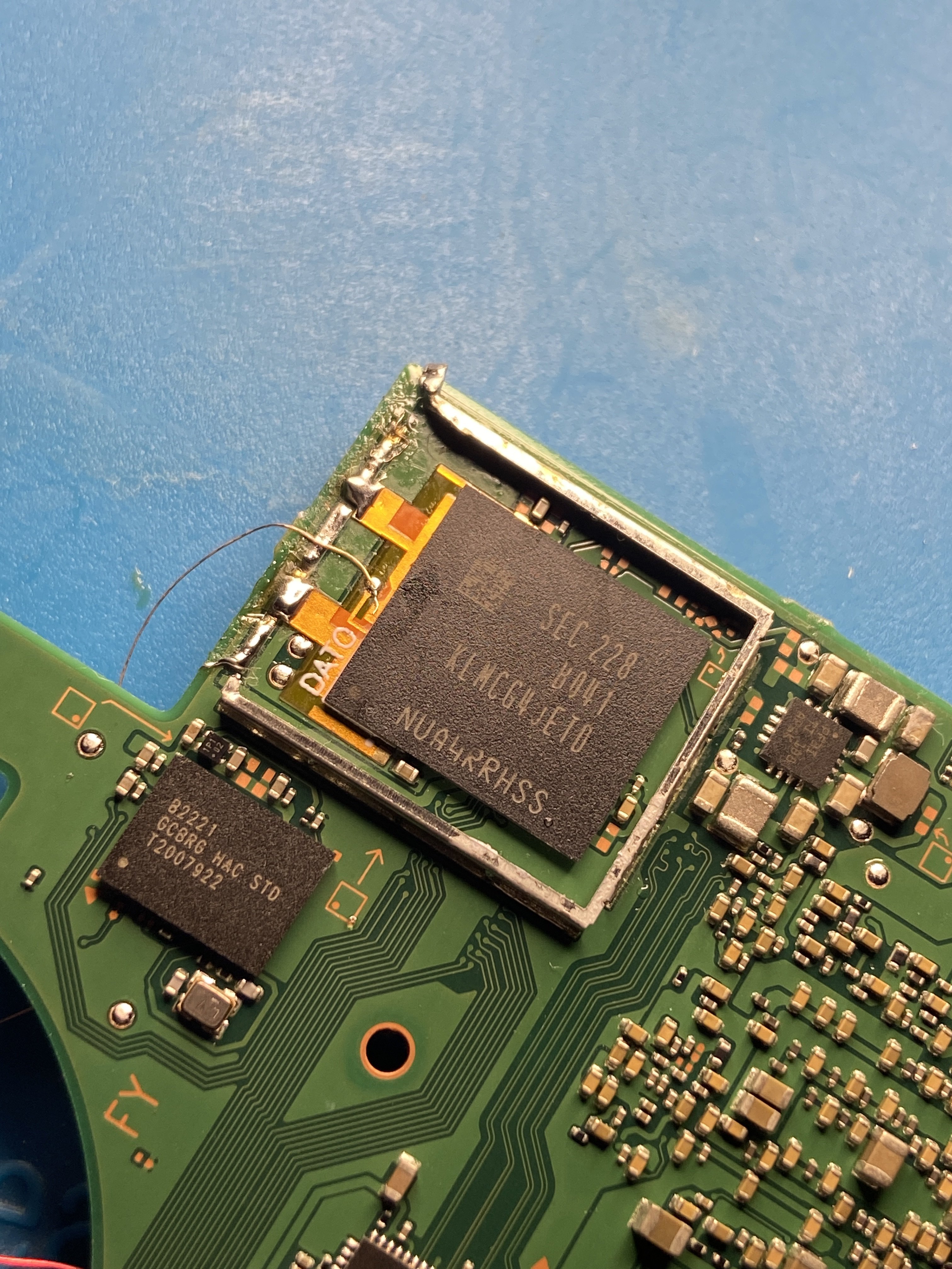

Hello. Thanks for bing initiative.
Yes, no shorts.
Yes, it was removed. I even tried another.
Apprearny, the code is actually *=*. eMMC int failure which got mee to thinking that maybe the dat0 adaptor was shifted and got shorted. What do you think?
