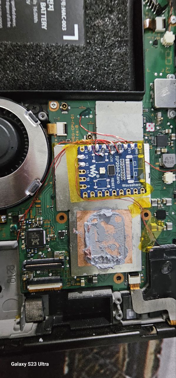

Good afternoon I ran into an interesting problem.
Switch OLED (FW 2.67). DAT0 adapter, the contact is well soldered. Diode test value 0.800v. Same value when pin is already soldered to rp2040 Zero (wire 0.1mm).
Approximately once a week at the next reboot of the switch, I get the yellow color of the LED and it loads only in OFW.
I check the contact to the ground in the DAT0 diode mode and I already get about 1.500v. Strange.
I just unplug the DAT0 wire from rp2040 and immediately solder it back. Immediately a diode test shows the correct 0.800v. Everything works fine again until the next similar event.
I tried to change the wire from the adapter to rp2040 to a thinner one, I also changed the resistor (the correct one is 47Ohm), but the problem repeats regularly.
Some kind of mysticism, any ideas why this happens and how I could avoid this in the future? Can I replace the rp2040 board

i'm using 4 anchor adapter and it's installed correctly.
first of all clean ur flux after soldering
second use shorter wires for ur mosfet , what wire diameter is that ? looks like 0.1mm if thats the case u need atleast 0.2mm wire
also u can use 0.1mm wire for 3,3v specially if u use 0.1mm for ground then also use the same wire thinkess for 3v
somehow there is problem with firmware. initially flashed 2.72, but after post tried to flash 2.67, instaboot! Problem solved.

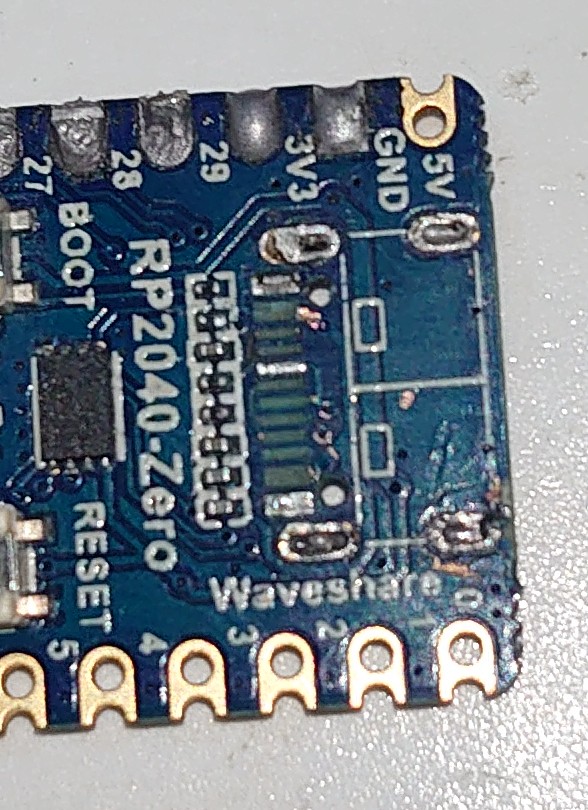

Hi, is this dat0 position fine? The diode value is .62v
View attachment 372589View attachment 372588View attachment 372587
It's exactly the same model that I have here. did you have success with it? I haven't tested it yet.
well, I had some damaged chips here and decided to test it closely
the serigraphy seems to be completely wrong, it needs to position the flat to the left. where the 3.3v serigraphy is almost below the emmc
even so I would make 2 cuts on the sides of the connector, to make it thinner. I did a test with the scalpel and it looks like I got a good result. now just decorate exactly the best position.
So maybe some that succeed using this DAT0 adapter they place it wrongly by shift it a little bit left (right if working on the pcb),
Because pin no2 is NC (Not Connected). While people whose place it correctly or shift a little bit to right, will got pin no4 short circuited.
This is my analysation, and i am gonna try to shift the adapter to the left pin (right shift if working on the pcb).
That is, if I take a pointed wire and carefully stick it between 2 and 3 points (shorting them), should this work?)

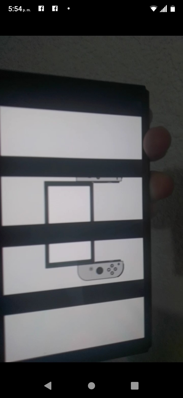

hello guys, I installed pico on my switch oled and worked normally but now when i restart it, it did not show anything and when i took out sd card then it showed NO SD. I had boot it to Ofw and it tuned into blue screen. Anyone know the problem and solution? pls help. thank you

I had exactly the same issue with an oled model. It was not the dat0 adapter. Until now all the oleds i have done with proper quality dat0 adapters have not failed yet. It was some flux residue that i had forgot to clean from the motherboard. Clean all of your points very well before assembling the console. Also use only no clean flux!
Boot into full stock and reset the switch

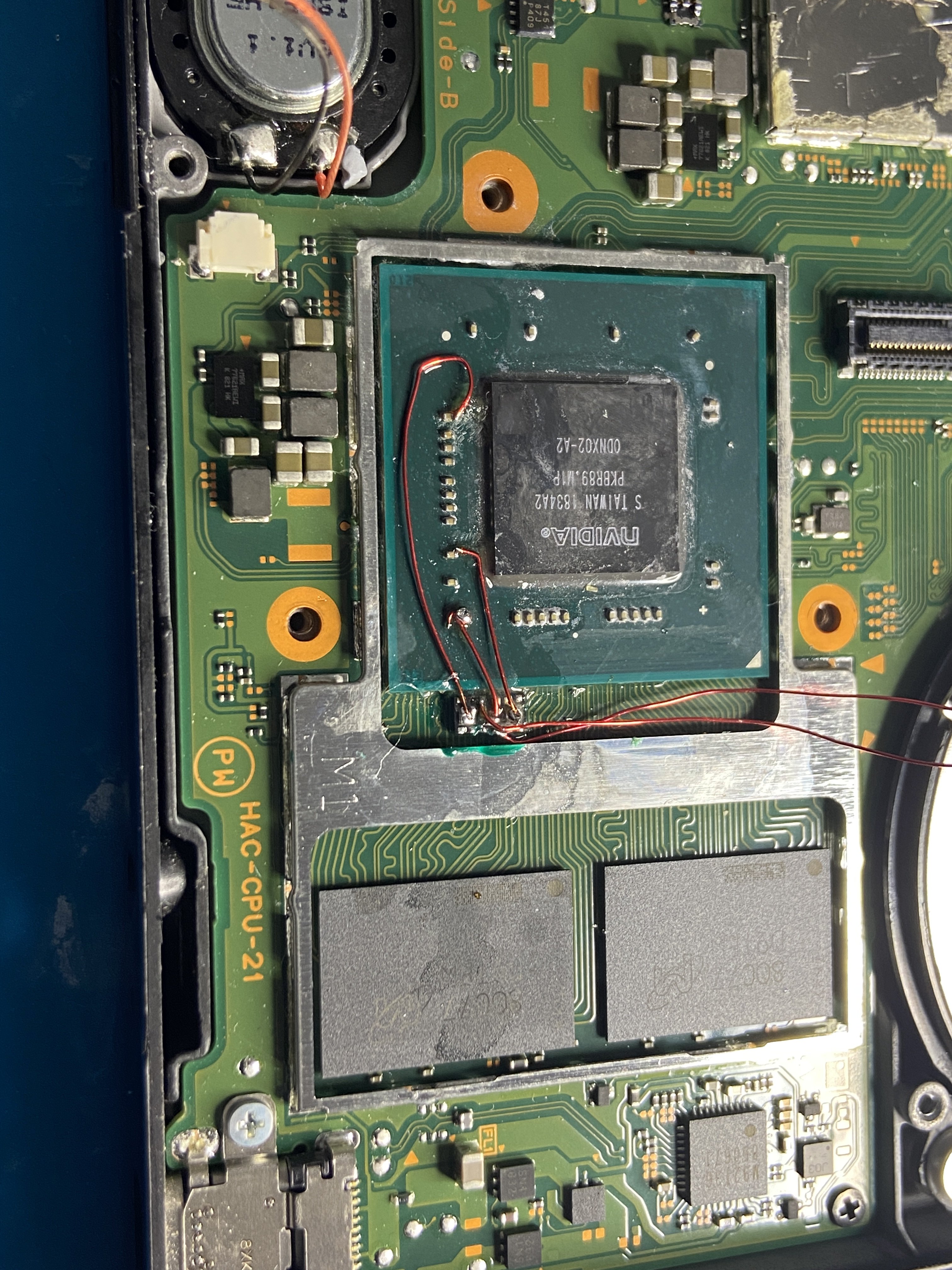

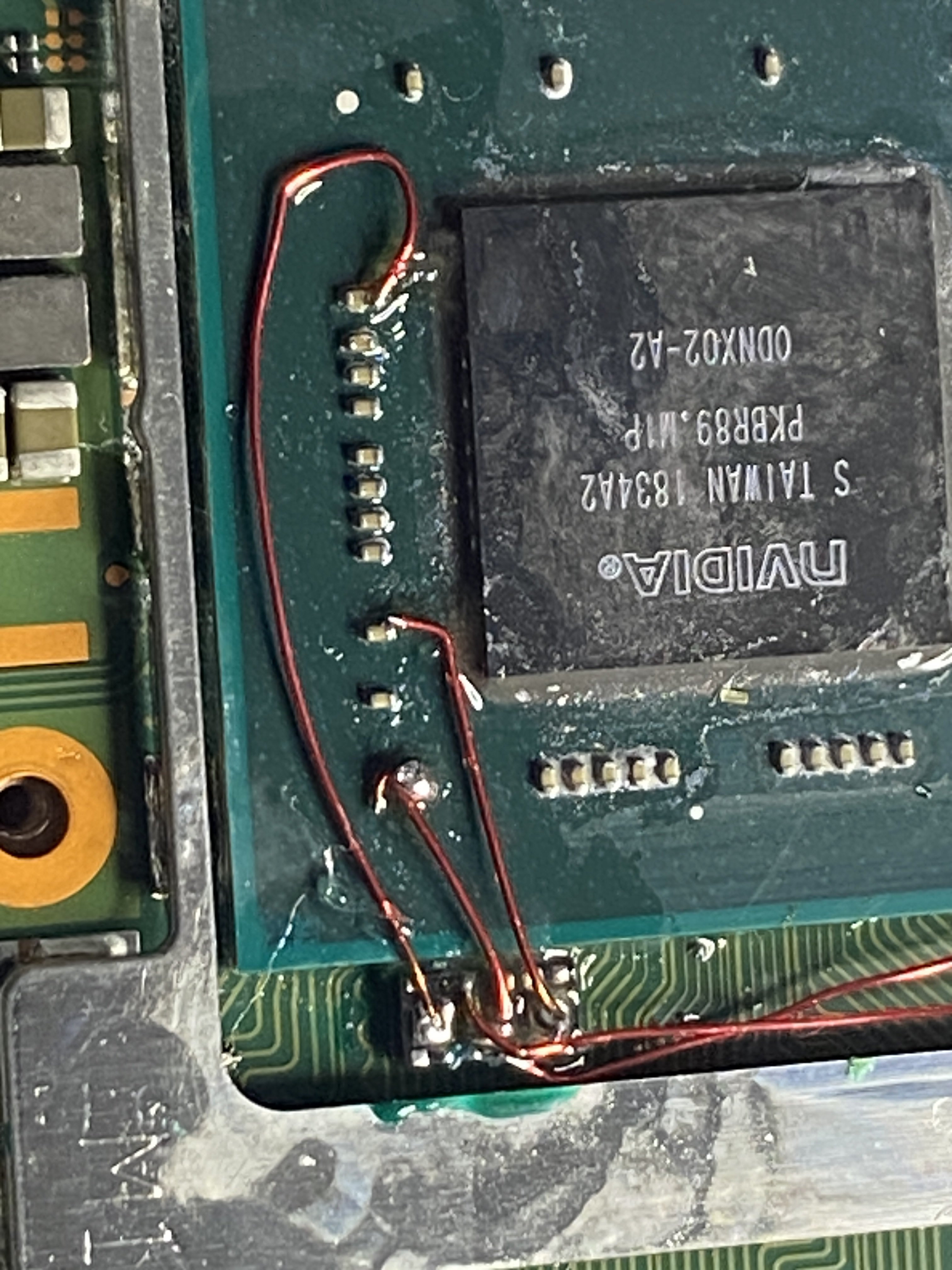

Hello. I'm going to cover everything with solder mask, I just want you guys to evaluate the quality of my work. Would you be comfortable turning on the switch with this? I'm pretty happy with it but would love to hear from you.
Any test to assess I can do to the MOSFET work is appreciated.

Shorten the wire from the first cap please :-) otherwise looks good

Looks good but check the red square for short between S and G
To be safe, I would sugest to wire the G as in blue line

i cannot boot into hekate when sd card not remove, i just got black screen. when sd card were remove, it showed NO SD card and then i pressed vol+ and vol- i got blue screen
