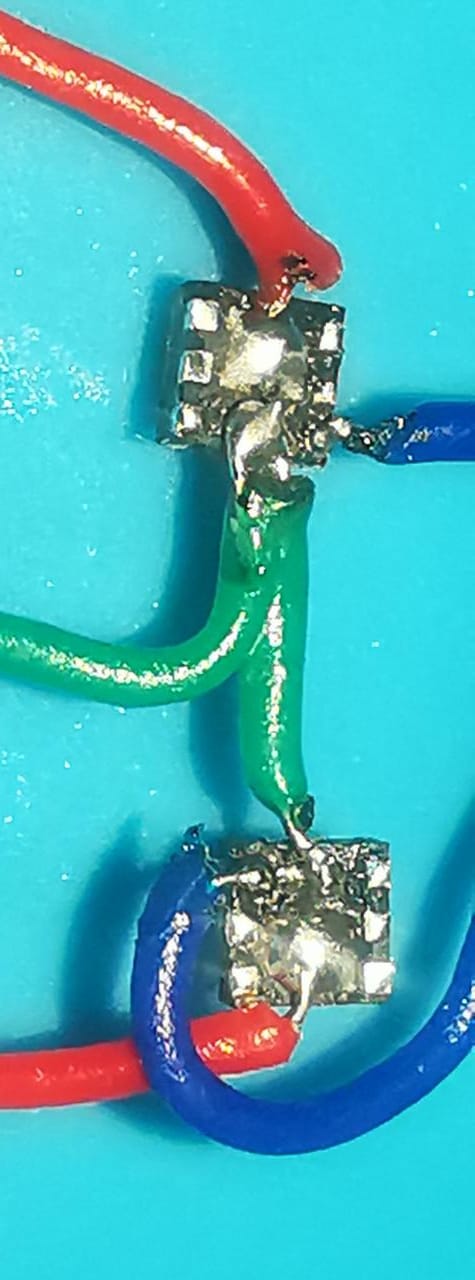

This is definitely one of the hardest welds I've tried to make. and I don't have a 0.2mm cable to make it, only 0.1mm and this one is 30awg.
what is the problem of doing only 1 mosfet?
You can use a single mosfet, 2 makes makes it a bit more stable, based on discussions in this thread. You may also get better luck if you tried without insulation and have the copper strands twisted for more rigidity.

I think now I've had a success.

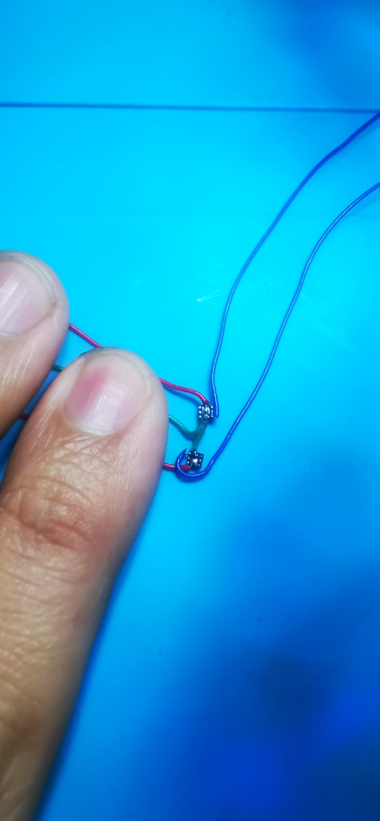

I think I managed to make the mosfets, is there any way to test with the multimeter? I did the diode test, with the mosfet without the wires and with the wires, the red wire, continuity with the green one? is correct ?
View attachment 372567View attachment 372568
That's a good question that I couldn't find an answer for. When doing a flex cable, I get a 0.5-0.9v on the third wire, but when using mosfet, nothing. Zero. How can I check my MOSFET work before booting it?

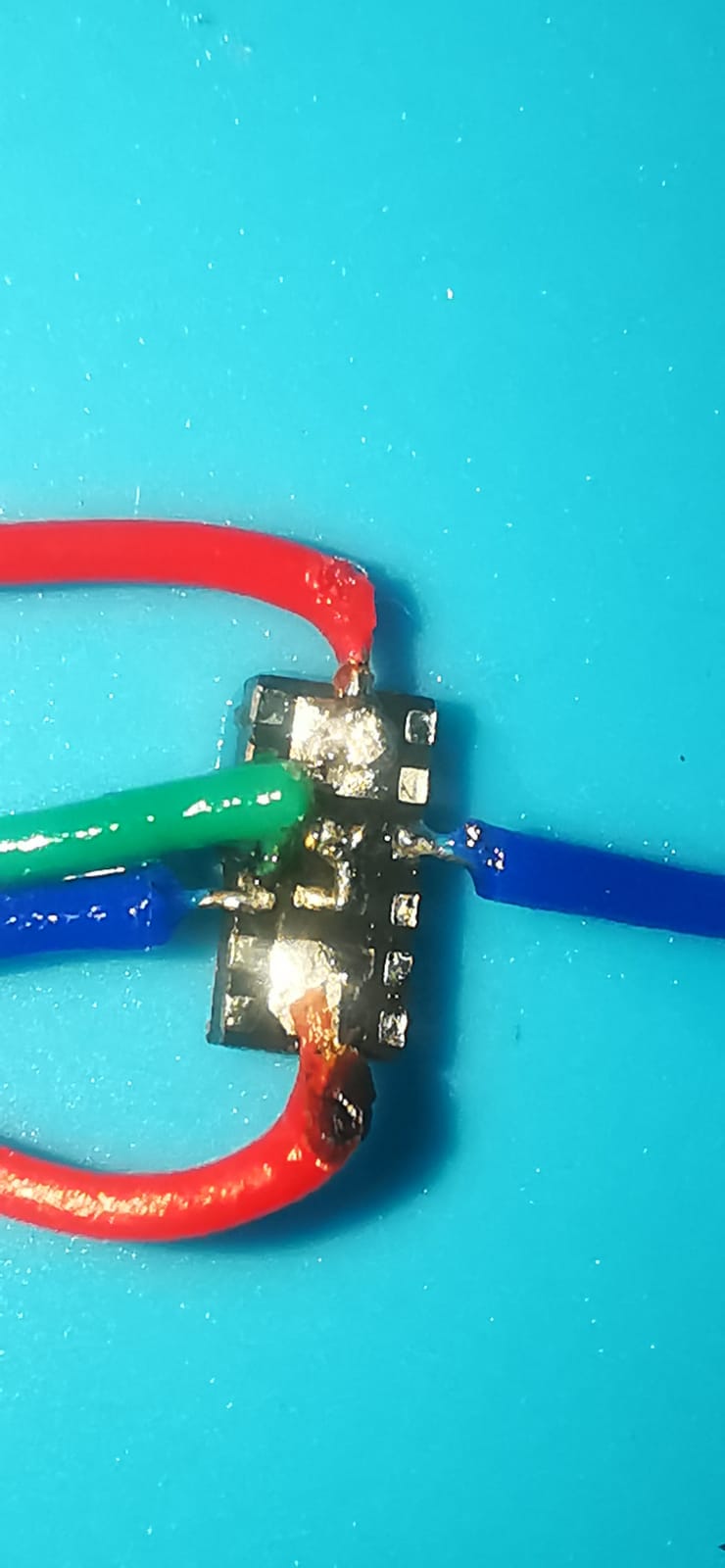

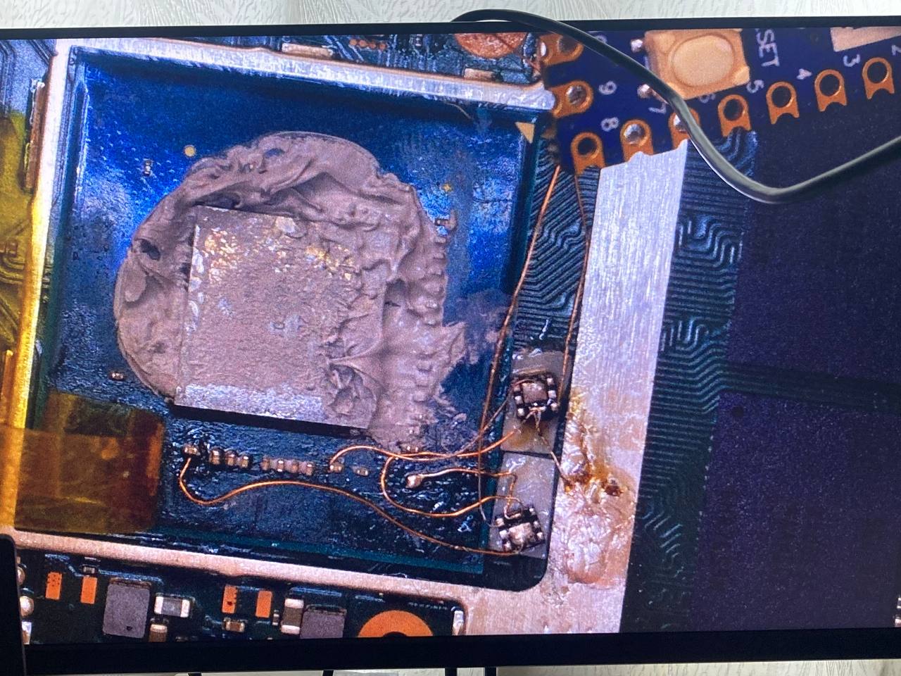

Two long debug pulses. CLK is connected properly. What could be a problem? How do i check if mosfets connected?
P.S. Yeah, i know, it's messy. But everything connected properly.
first of all clean ur flux after soldering
second use shorter wires for ur mosfet , what wire diameter is that ? looks like 0.1mm if thats the case u need atleast 0.2mm wire
also u can use 0.1mm wire for 3,3v specially if u use 0.1mm for ground then also use the same wire thinkess for 3v

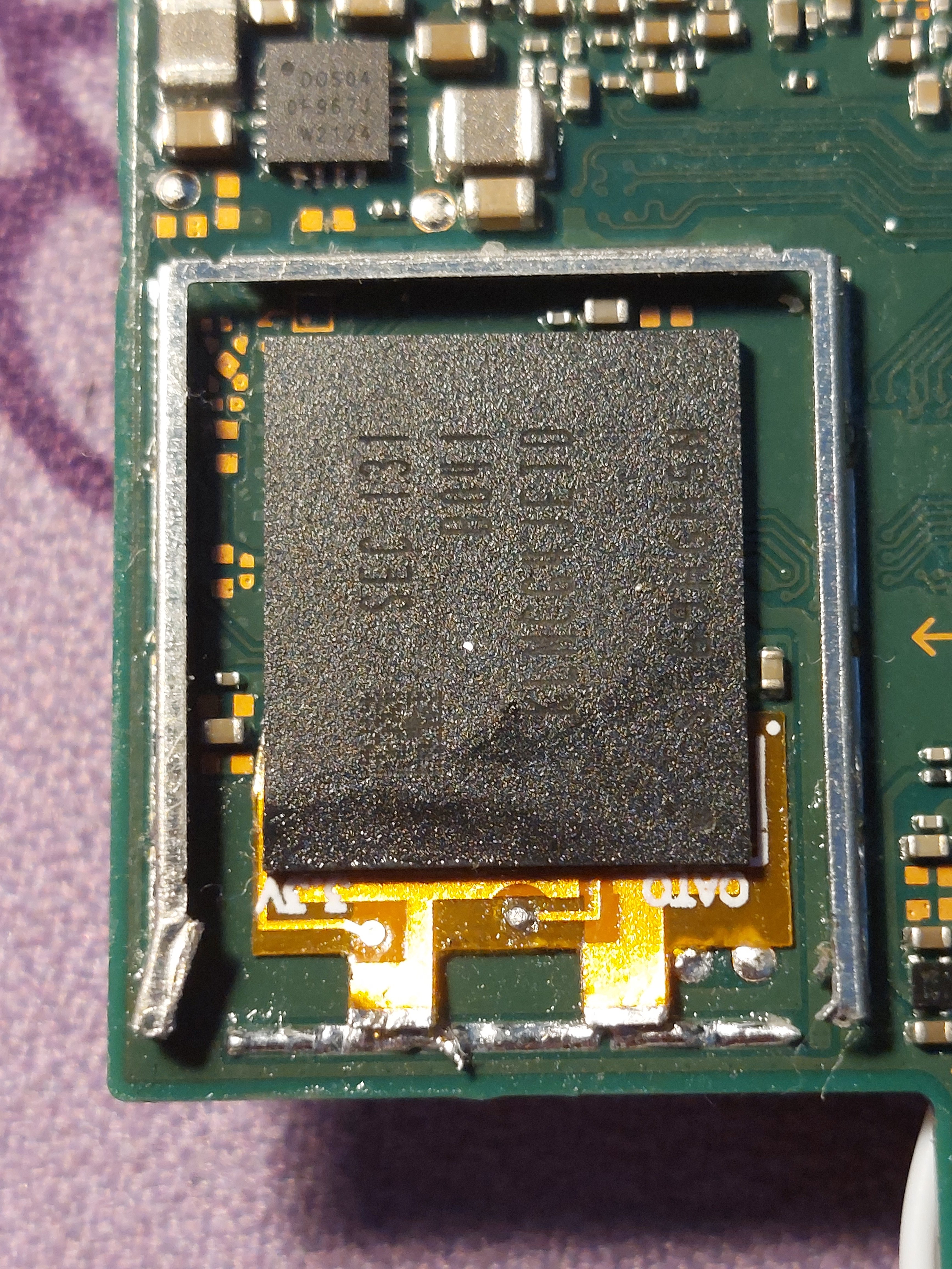

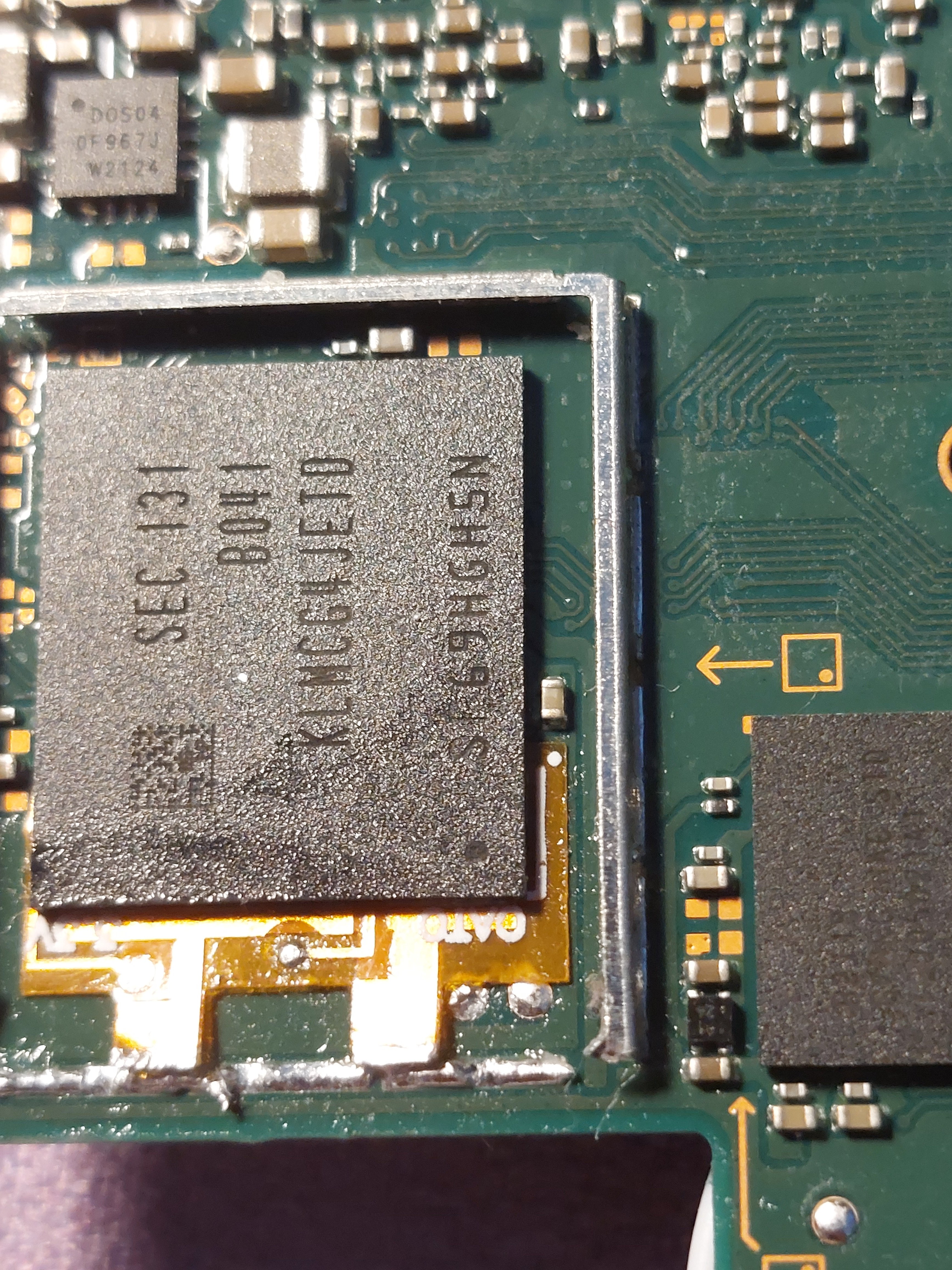

Hi, is this dat0 position fine? The diode value is .62v
This doesn't really answer your question, but those "OATO" adapters have been mentioned in this thread before. The point of contact with the ball under the IC seems to be too wide and/or poorly cut, potentially causing shorts with the ones next to it.
The so-called "four anchor" adapters, or even the "corner style" adapters, are generally preferred. I guess that (and the obvious misspell of "DAT0") is why the "OATO" is so much cheaper than the others.
FWIW, I have the "OATO" adapters on hand, along with everything else to perform this mod right now, and yet I'm waiting for a shipment of the "four anchor" adapters before attempting it. Just my 2¢.
View attachment 372589View attachment 372588View attachment 372587
I second @Nephiel opinion. The reading is correct but those adapters are not good.
I had an Oled where I spent 3 days trying to figure out what was happening and turns out dat0 was giving some short under emmc.
Maybe it's the photo but I can already see some deformation on the upper left side of the adapter.
